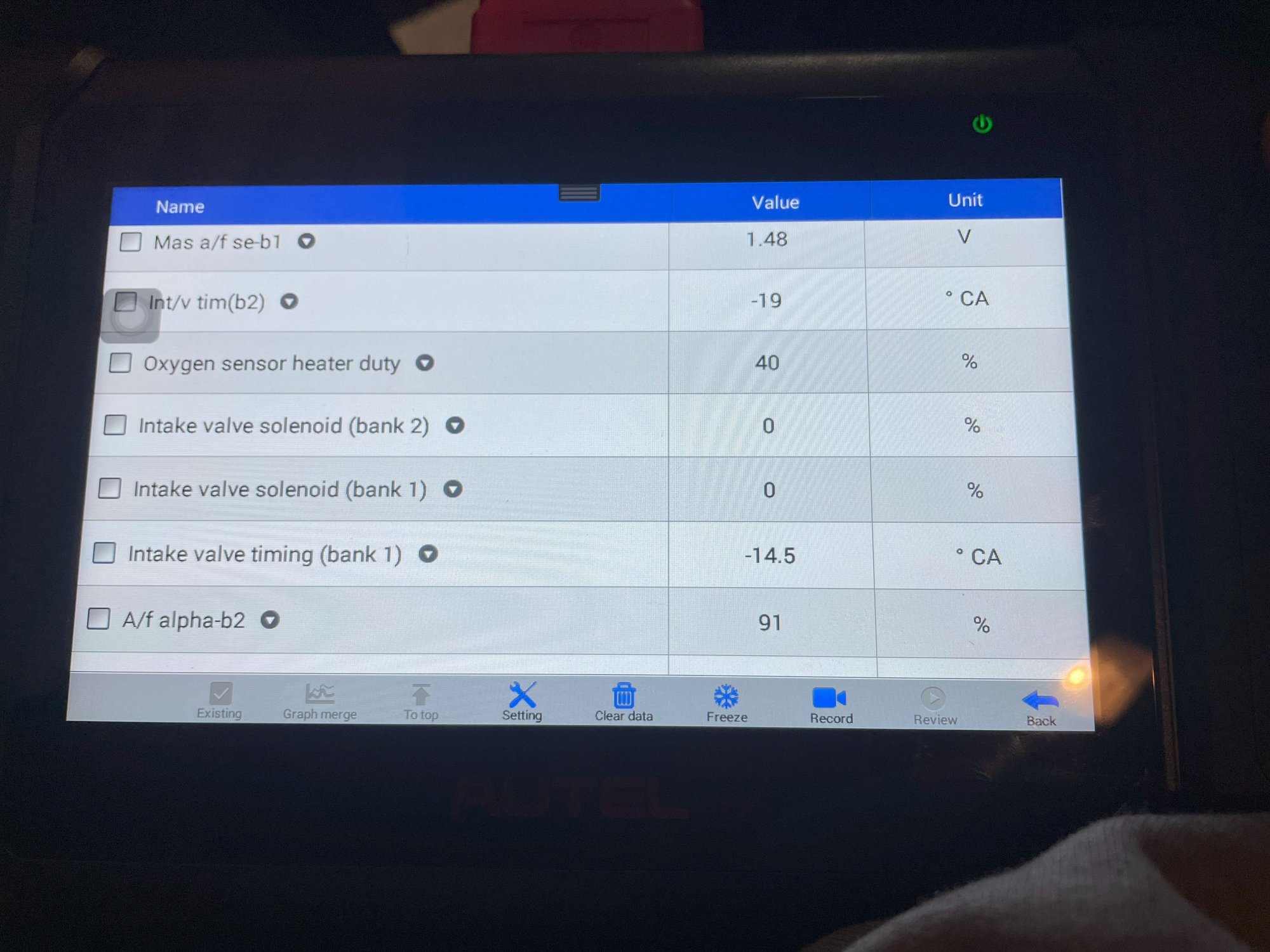

Just scanned live data of my car, found out the intake valve timing values are way off from what they should be according to the manual, oh boy... I also had replaced the intake camshaft for bank 2 as that was the damaged one needing replacement, anyhow i've been hearing a knocking noise coming from the engine that wasn't there before, did some digging into the noise and it sounds like it's coming from right around the same area as the bank 2 intake camshaft, I followed all proper torquing procedures, I got the camshaft from a spare vq35de I have laying around, idk how I could've messed it up. I'll attach some photos of my data read.

****, that's valve knock.

What exactly does that mean? Like the lifter clearance is too large? Or the valve is knocking on the cylinder head?

Yes, that's what it sounds like to me, the lifters not moving at the correct timing so they're hitting the piston.

Sounds like you messed up the timing.

Yikes, I hope not. I'm gonna be taking it apart to see what I find, I was very sure I did the timing correctly, but I'm believed now that possibly the chain jumped teeth on initial startup before the tensioners kicked in. Thanks for the help.

You did pull the pins on the tensioners and then turned it over 360 degrees by hand before putting it back together, right? Get yourself a manual. One of the last steps is to turn it over by hand to set the tensioners.

Ooo no I did not know that, I think that was my mistake, not taking into consideration the tensioners, lesson well learned.
