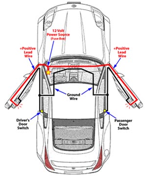

Cool I did mine!
Originally posted by windydog
Thanks Guys, I was about ready to pull my doors apart.
You certainly CAN add your very own courtesy door lights.
If you really want them installed in your Z, you must remove both door panels and the front kick panels as well. You will need to fabricate a bracket to hold them in place (just behind the OEM door reflector) Then find a suitable power source. (ex: cigarette lighter or other constant power source in fuse box area) The 350Z door switches currently supply the ground. Make sure that you connect both ground wires together. You will then allow either newly installed door light to illuminate simultaneously when driver or passenger door is opened.

Nice diagram, frankmusic. It's on my to-do list, but waaaaay down at the bottom. Since you connected the door switches together do both windows drop when you open one door? IIRC, that's the signal to that door to drop it's window. That's not really a problem, just a side effect.

Cool That's how the Z should have been delivered.
Asterix
Thanks! I like the look. I was surprised that Nissan only chose to offer it as a reflector ONLY.
When I said, connect the two ground wires from the door switches - I was referring to the rubber switches located on the door jams. (not any switch "inside" the door)
For example; If you were to connect only one ground wire to its respective door exclusively, then only one courtesy door light would illuminate. By connecting both (door switch) ground wires to each other - both lights will illuminate simultaneously no matter what door you choose to open.

Yes, that's the one. The switch with the rubber bellows over it on the door frame. That's the switch that tells the computer to drop the window the 1/4" when you open the door. If you connect them together, won't the computer think both doors were opened and drop both windows?
