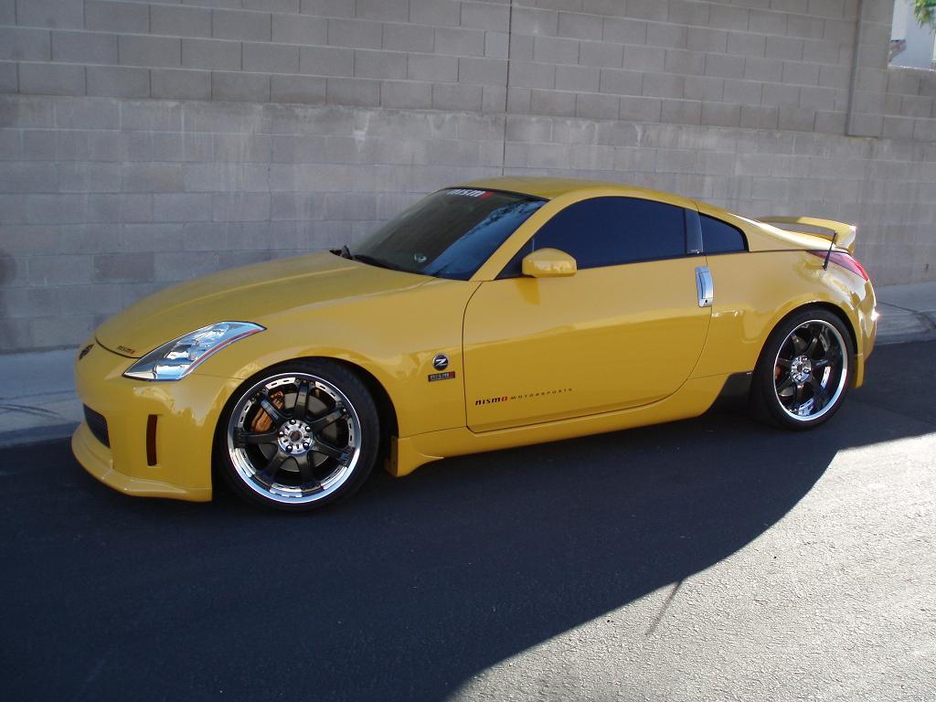

Oh yeah bye the way the exhaust is a custom 2.5" setup with a cross over intermediate pipe, strup cans, 2.5" APS test pipes and stillen headers. exhaust fabricated by GTM. it is loud as F'uck!!!!!!!!! maybe to loud for my taste.....but it performs well.

that is exactly why i set this car up the way i did! thank you for that comment it made my day.

i am not going to throw a body kit of any type on this car due to it not serving any function. the c west lip was a big step for me but i think that looks good. the reason i am not going to paint the lip or hood is due to foreseeable paint match problems and due to the carbon fiber can get the hell chipped out of it ( road and track debris ) and still look decent. this car is going to see alot of road racing duty in the near future. next step in my build is supension work and coilovers.

Just posting up some quick pics i took due to my last round of mods i just finished up including the mastergrade hood. i installed the hood more so to round out my cooling mods and not for looks. i actually dont like the hood that much but as you can see in the pic's the left hand vent hole is placed right over the supercharger which aids in cooling the unit quite a bit! enjoy...........

here is a before pic if anybody cares. i set the car up this way two weeks after i bought her brand new back in 2005. the car was still NA at this point but the SC was on order.

black cooler is a stillen unit ( main oil cooler ). silver cooler is a unit i put together myself ,it is a supercharger oil cooler. it cools the supply oil just before it enters the supercharger. as far as i know i am the only one who has ever done this on a z and it works pretty damn good. the intake tube i fabbed myself using some 3.5 dia aluminum tubing with aircraft scat tubing and at the end i installed a velocity stack.
