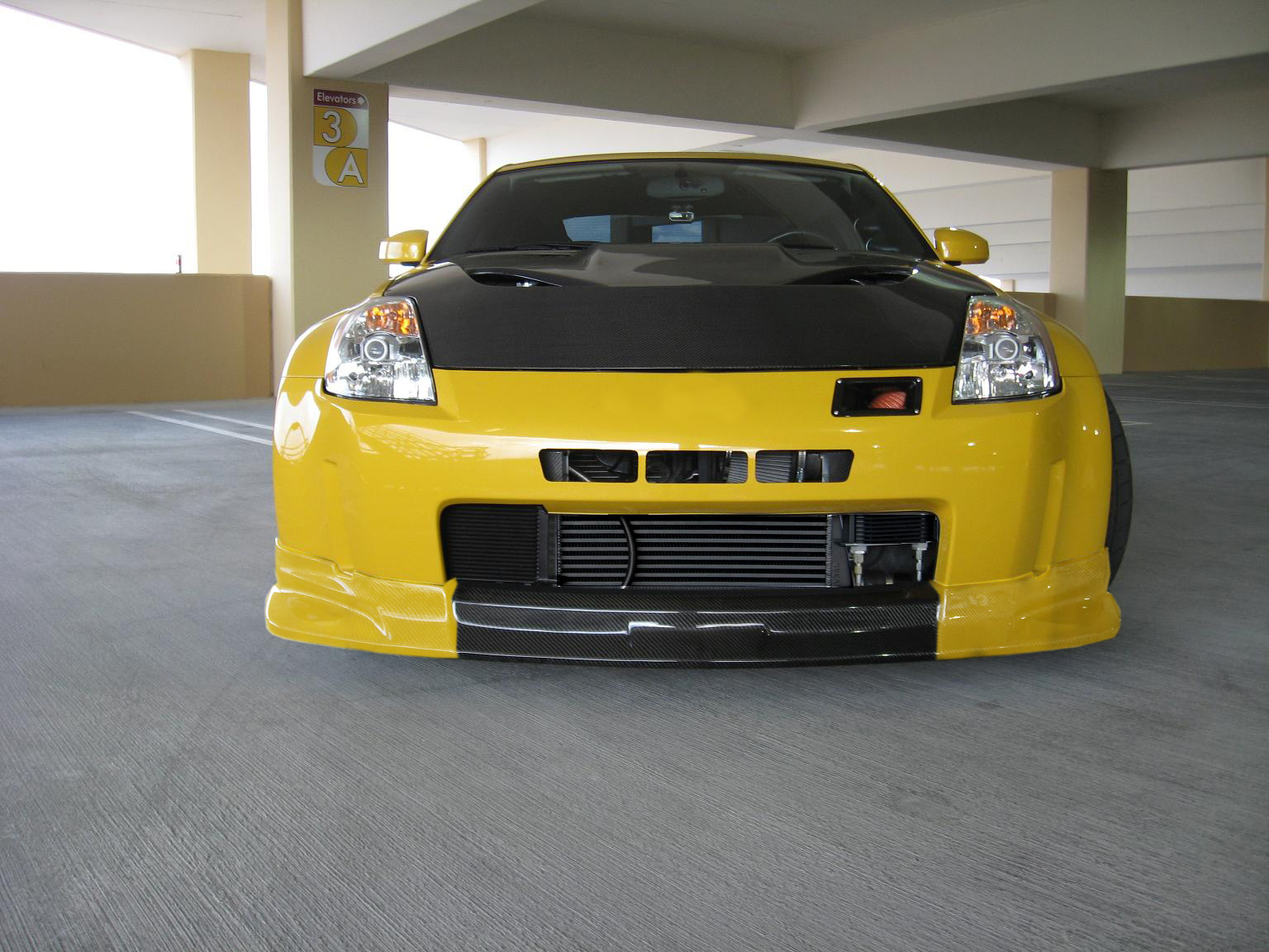

Looks awesome man....nice work...it might look cool to do somethin like this too.

That actually looks pretty good!

wow that's crazy...

that makes me nervous that some jackass with a pocket knife would reach in and cut some tubes for no reason

WOW!!!!! DONT TEMPT ME! i just put this thing all back together.........

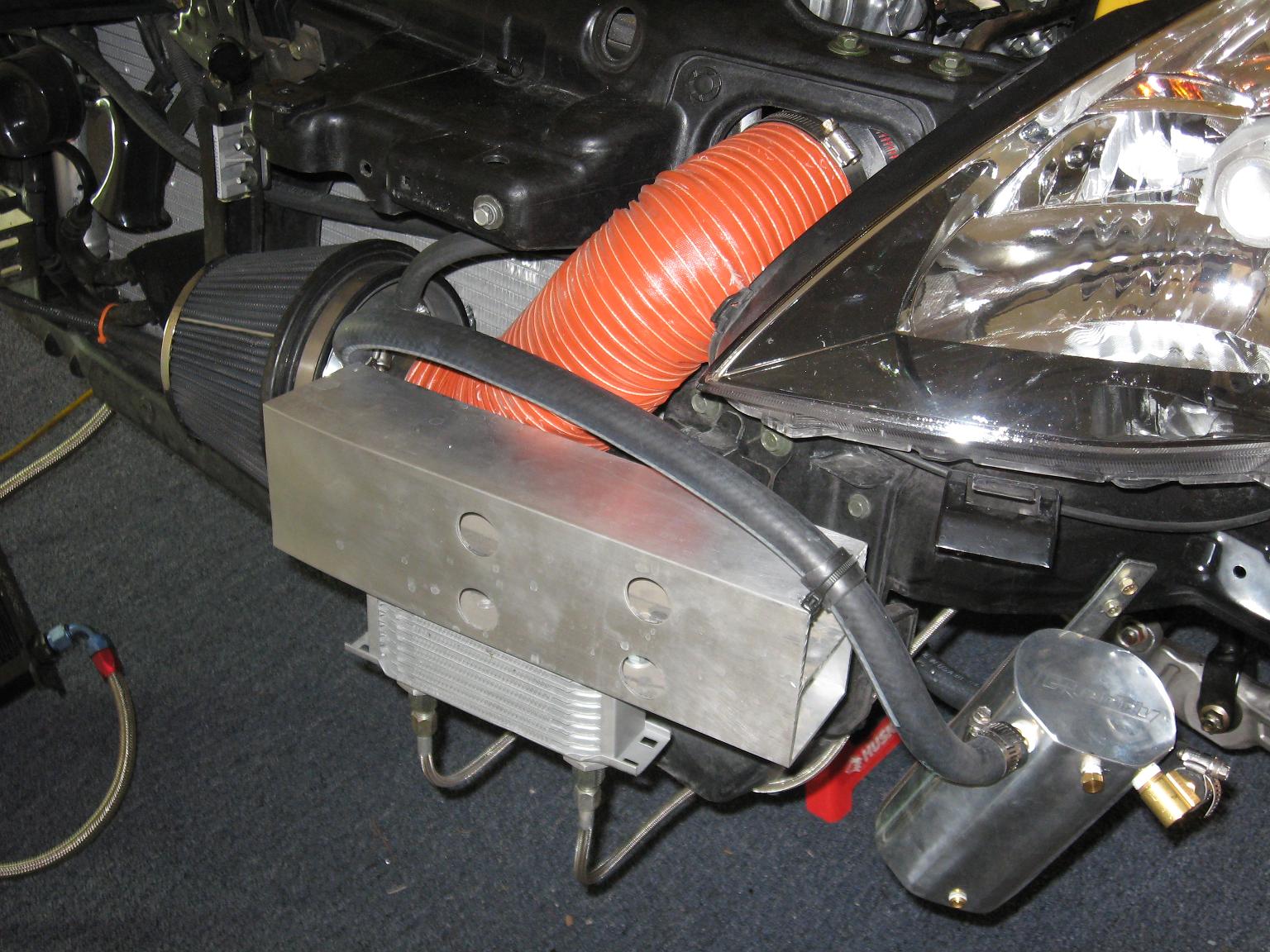

Originally Posted by JET MECH
black cooler is a stillen unit ( main oil cooler ). silver cooler is a unit i put together myself ,it is a supercharger oil cooler. it cools the supply oil just before it enters the supercharger. as far as i know i am the only one who has ever done this on a z and it works pretty damn good. the intake tube i fabbed myself using some 3.5 dia aluminum tubing with aircraft scat tubing and at the end i installed a velocity stack.
nice. Im thinking about running dual oil coolers as well. One for the motor and one for the SC. Noticed that i hit over 250 degrees just cruising on the hwy at 80mph......thats a bit high for my liking. I was thinking about upgrading my ic for aethestics but now that i see theres room to run to oil coolers instead ill probably go with that. Abui will be proud
Also, im going to run dual small oil catch tanks. Everyone seems to install one catch tank on the pasenger side which stops oil from flowing back through the upper intake plenum but doesnt prevent oil from leaving the crankcase and into the intake when under boost. You need to add another to the driver side between the valve cover and vortech filter.
maybe i did not tell you this already but i do run dual catch cans! the one for the left hand side or for the intake into the airfilter is behind my bumper cover on the left hand side. i will see if i can find a pic for you. it is hidden away nicely!!!
