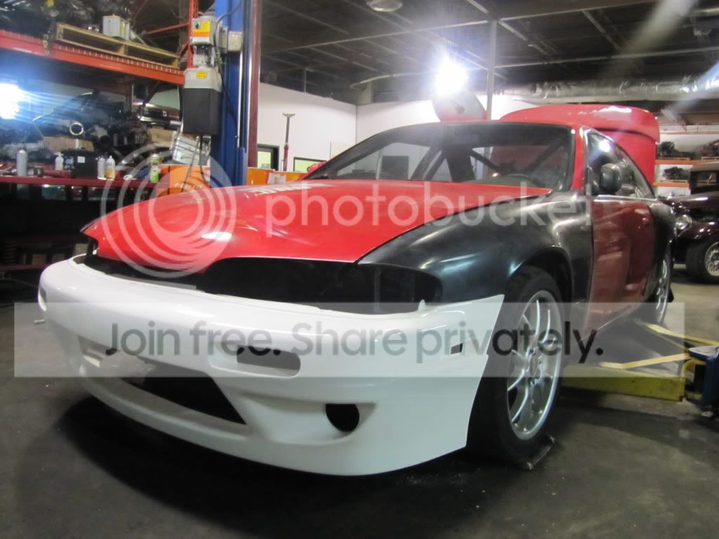

In between the daily grind and numerous projects we have going on Brandon's car is almost finished. John was able to spend most of the last two days getting everything together. With the season starting up we obviously want to get this beast back to Brandon in time to shred some tires and enjoy the ride.

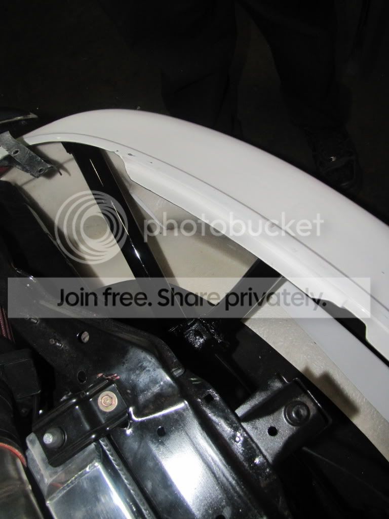

Custom made the front crash bar/bash bar, which fits perfectly with the Rocket Bunny front bumper. Fitting of the sides and rear will be done soon.

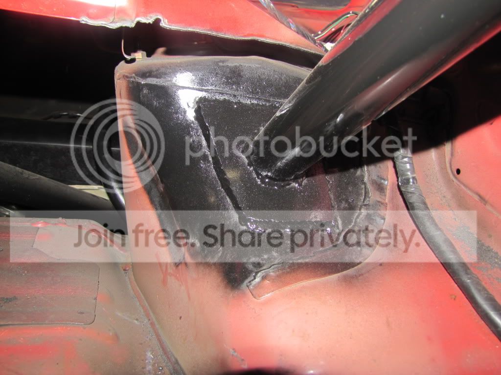

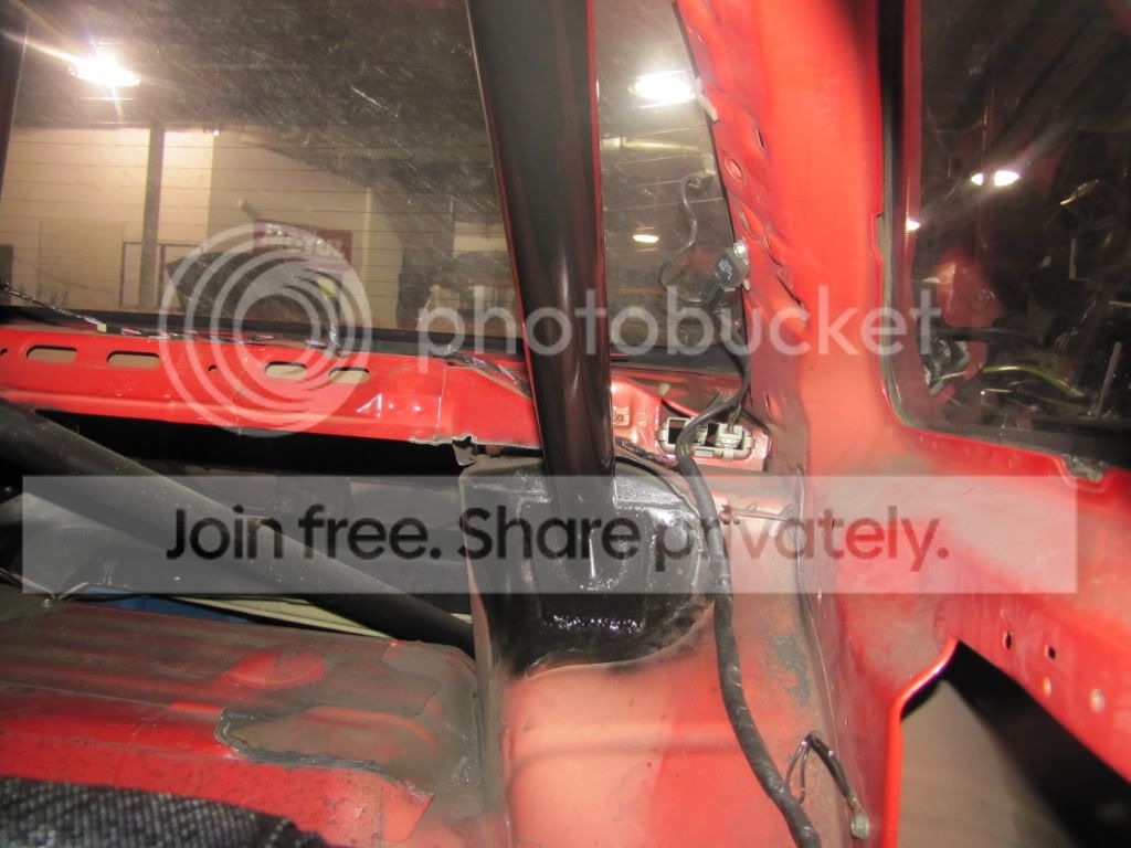

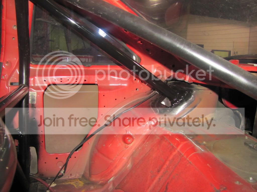

To pass tech for XDC we needed to add two down bars.

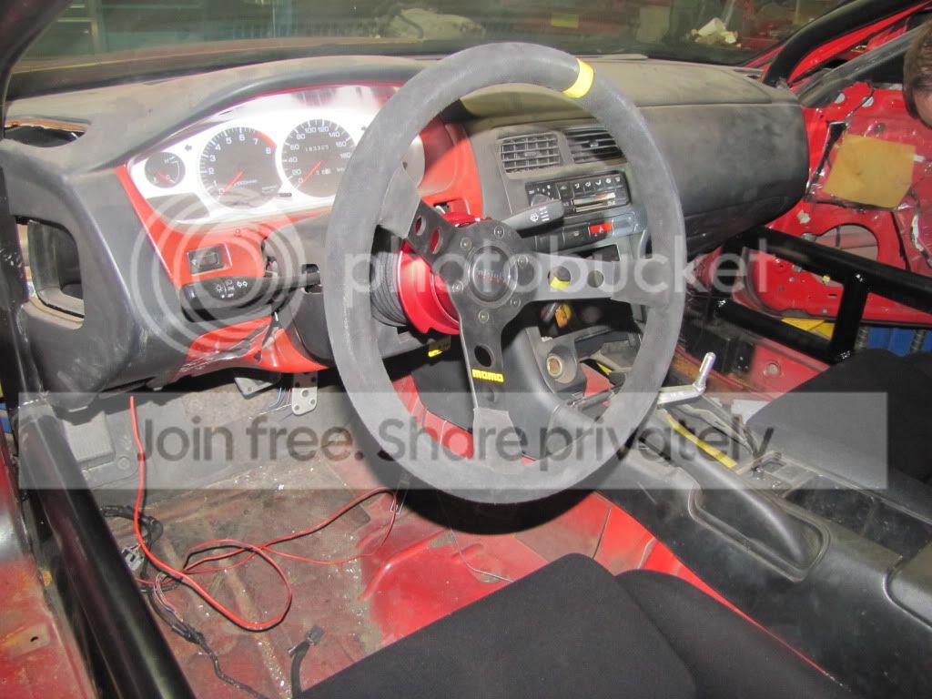

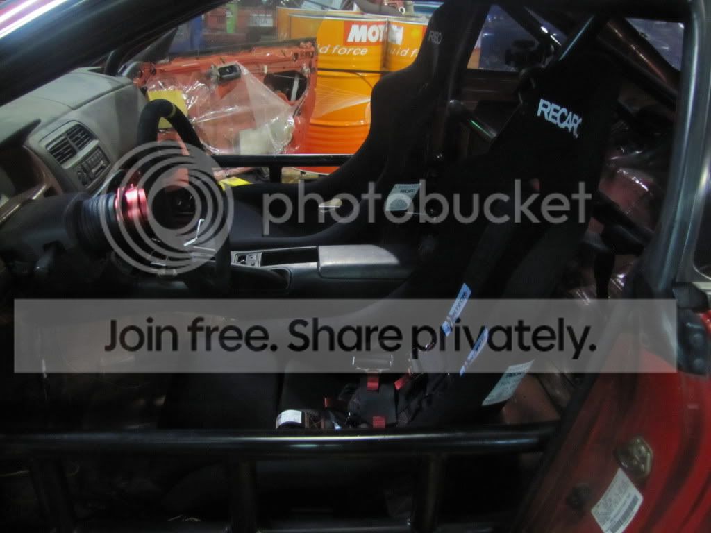

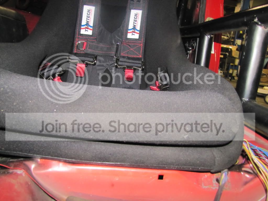

If you know Brandon he is a taller gentleman so we made the seat fit accordingly. Custom brackets & hammering of the floor pan was required. The passenger seat is sitting on a Buddy Club "Super-Low" rail so they say.
Momo wheel --> NRG quick release --> Momo hub
Interior all together.
How tall is he? Just curious as I'm 6'4" and when I sit in a Recaro Pole Position my shoulders are a good amount above the harness pass through holes, and that's without even having my HANS device on. I'd be worried about using a harness with that seat if he's over 6"
Old Mar 17, 2012 | 10:47 AM
JE's Avatar
JE
Vendor - Former Vendor
Joined: Jan 2011
Posts: 127
From: Baltimore, MD
He is just about as tall as you I would say. With harnesses on and locked in he fits comfortably.
Old Mar 18, 2012 | 08:28 AM
dan avoN7's Avatar
dan avoN7
Posts: 158
From: Danville, CA
I was referring to the harness angle. I also fit very comfortably in a Pole Position but the shoulder harness pass through is too low. Unless he has really long legs/short torso by looking at your picture it would seem the harness would be at at least a 45* angle or worse with him seated properly. Just wanted to point that out as spinal compression would be very bad if he was in an accident. The shoulder harness angle with him strapped in should be anywhere from 0-20* (from seat back to harness bar), 20* being the very MAX.
Old Mar 19, 2012 | 06:02 AM
JE's Avatar
JE
Joined: Jan 2011
Posts: 127
From: Baltimore, MD
I know what you meant, but my short answer was comfortably. We spent a few hours with him here one night verifying proper angle, seat height, harness setup & pedal distance.
