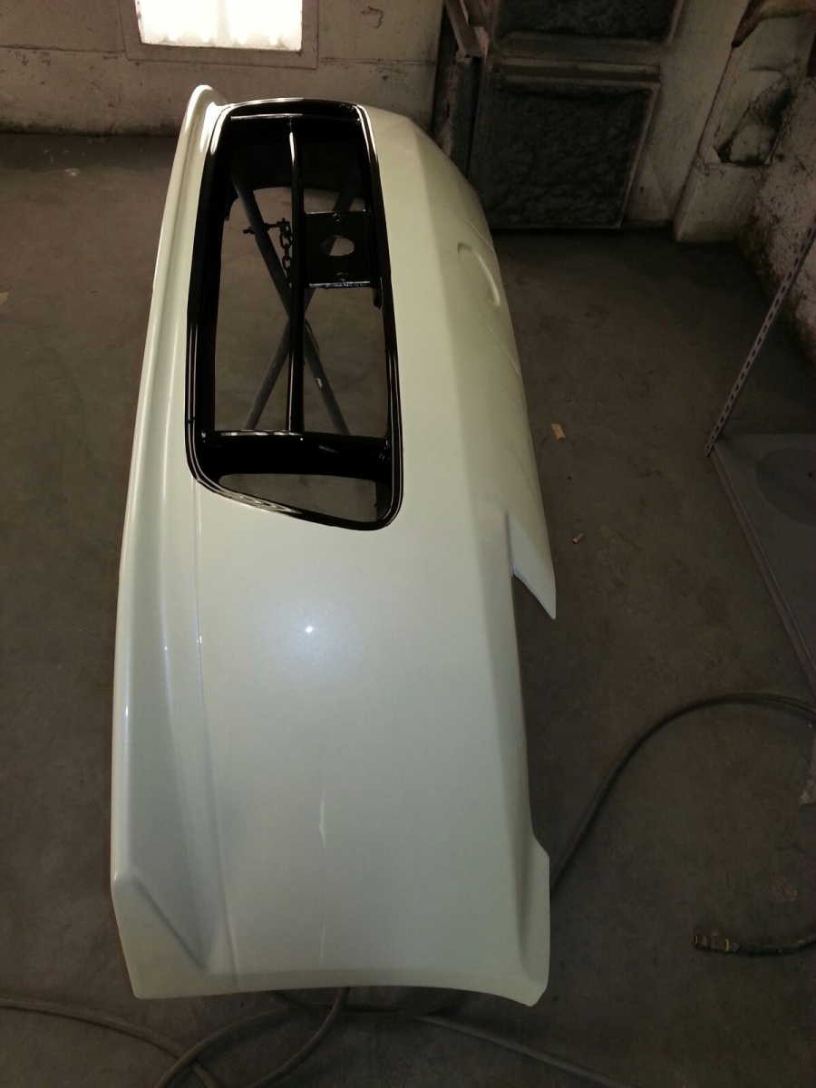

Cars been at the body shop getting some work done to it.

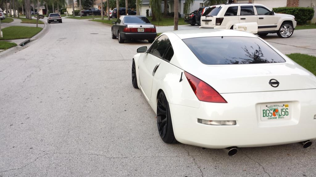

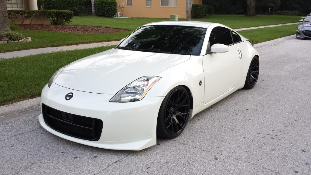

Finally got the car back. Here are the results for now, adding spacers soon.

Nice work bro keep it up, we need more Z owners like you

looks absolutely sick dude. i love it

Couple more Shots

get bigger brakes

Great work! Yeah, the bigger brakes will set it off.

some 15mm spacers and you are gunna be at milestone!

Thanks guys and ya bigger brakes would definitely be nice it's just not in my budget right now.
Throwing a 15mm in the rear and a 5mm in the front for now, I'll re-stud later.

2 things.
First, it will be impossible to throw on a 15 mm spacer without re-studing.
Second, there's no reason to re-stud when you could get spacers with exisiting wheel studs. In fact, they are just as capable as re-studing. Less time. Less money. Less hassle.

I'm putting on a 15mm bolt-on-spacer on the rear... it has built in studs. Then putting a 5mm slip on spacer on the front(you can get away with it without re-studding). My rear wheels have gaps and my fronts do not, simple. My frame does not drag on the ground and I'm obviously not running -15 degrees of camber or more clearly, so my answer would be no.

But anyways, please don't get 15mm slip-on spacers... most say that 5mm is the most slip-ons should be considered for.
A better option would be hub-centric spacers with their own studs
Like these: http://www.motorsport-tech.com/adaptec/car/nissan_s
Not trying to tell you what to do OP but many would agree that this would be the best way to go.

You're gonna have to run -15 degrees of Camber with a 11" wheel +5 offset combo if you want it lowered at a decent amount. I'm assuming with a 255 on an 11" rim you're not gonna want any fender gap. Ipso facto, my video.
