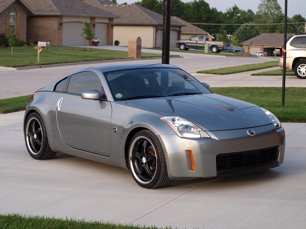

Old Dec 18, 2013 | 04:56 PM
KornerCarver's Avatar
KornerCarver
Posts: 3,387
Likes: 171
From: Republic, MO
Originally Posted by jdmlove1
i wouldnt bother polishing a silver car, they never shine !
Silver cars don't shine???????????? Check out mine.

Originally Posted by ntwillie1
I disagree. I know light colored cars are hard to get the paint to pop but it can be done.
Amen guys..
My "silver" car shines .. and everywhere I go since I've detailed it I get people talking to me about it.
The few pictures I took were with a cell phone, and it didn't handle the sunset light well (and I'm no prof. photographer ).
Still,.. if you know car finishes, you should be able to tell to some degree the way the car looks even in the pictures I posted.. especially if you go to the full stream of them.. (like 4 total pics)... here:
Then zoom in ..
This picture, while not the most flattering angle of the car.. shows the rotary work much better than the others... Take a look at the reflection.. and definite "Shine" on the driver side here:
http://www.flickr.com/photos/111739693@N04/11415430745/
But , yes.. Lighter colored cars (the lighter you go).. are harder to get to shine and have a "mirror" finish like say on the opposite end of the spectrum a Jet black car. But, I absolutely LOVE the color of the one I have -- It almost looks different than some of the other Z's.
The ones I see rolling around here look a darker grey .. mine looks to be a little lighter and more "silver"... but maybe they are all the same,.. what do I know!
I invite you (whoever said don't bother with a silver car they don't shine) -- to come see my car in person any time you want.. for real! We can talk shop too.
I'm STILL not done with my car .. I'm about 98% there.. but I do the stuff many people don't even bother, or think about.
That looks super clean.
What products do you use on it?
It looks a bit darker than mine? Is it the same paint scheme? Maybe different lighting, better camera?
My Z is Siverstone. I suspect your car is Silver Alloy Metallic. You can check for the paint code on the firewall to be certain of your color. For the most part, I use Adams Polishes products. I have a Griot's Garage 6" d/a buffer and a 3" d/a buffer. Try using some Adam's Americana wax. Outstanding shine.
I'll check for the color code.. thanks.
Also, I'll look into those products, I'm always looking at new products to try. Much appreciated! Your Z looks super sharp,.. good job on it!

Definitely Silver Alloy, Color code: K23
