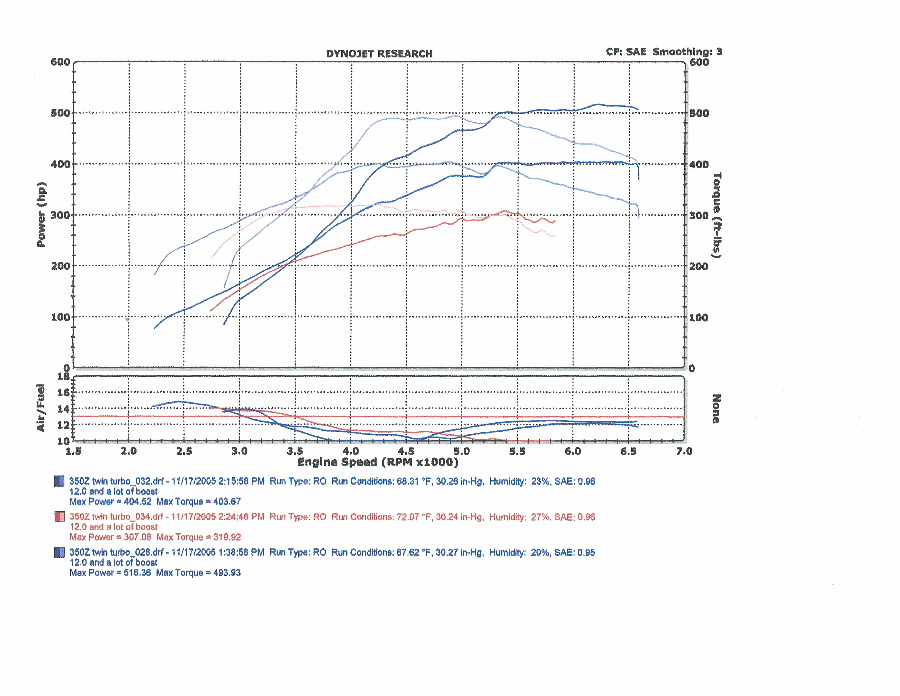

Had HKS EVC installed and dynoed at Millennium Autosports in VA Beach. 3 pulls are off, low and high boost.

Nice Numbers.. congrats
is that your AF reading? .. lil rich ?

Wow I hope thats not "tuned" way rich midrange and a too close for comfort 12:1 @ redline. What kit, fuel system, boost levels you running?

greddy TT, AAM fuel system, 5, 8, 15 boost levels
why are you not pleased with millennium?

They had no ideal how to tune split sec and i ended up not gaining any horsepower and cost my $450 for that. Unjustified expense and I just reloaded my previous map. CPRacing is where I had my original tune down and they were great. Only cost me a couple hundred...not $450. Crazy. Now I might go with UTEC so we will see.
