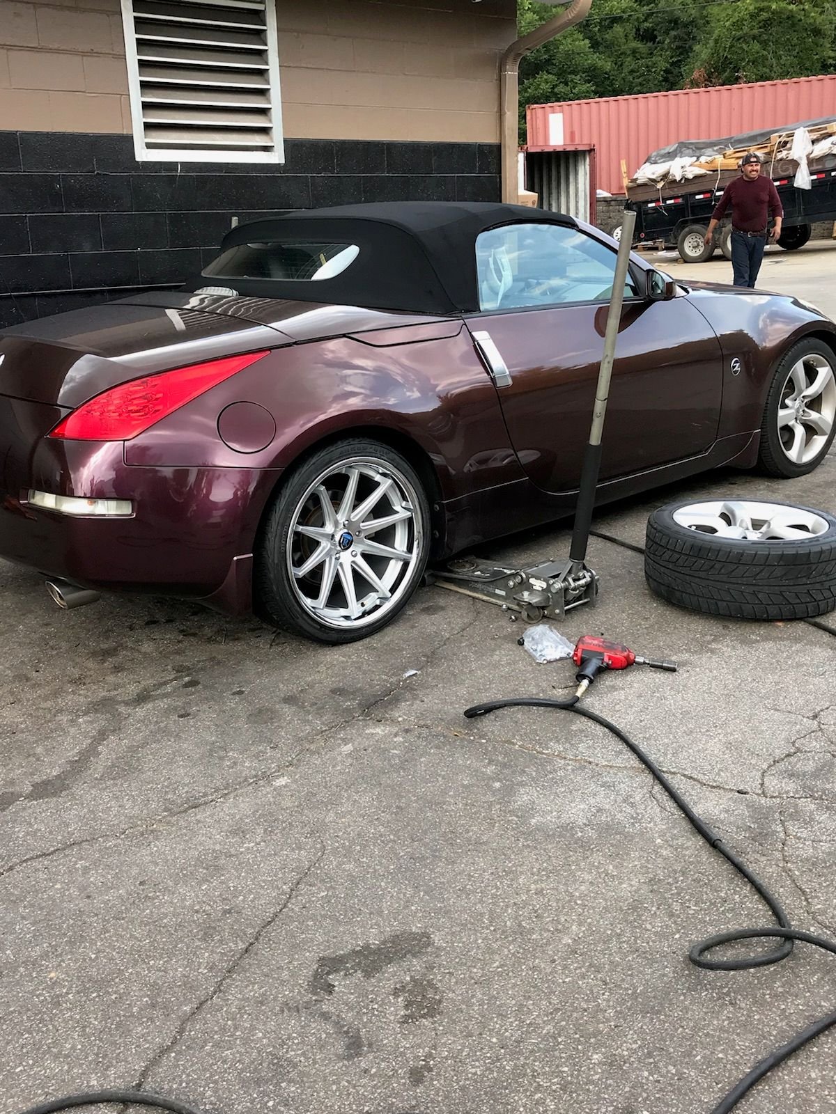

Paid a visit to a local wheel and tire shop looking for 19'' Ferrada f3 wheels, but he had these on picture included on floor for 1400 set, 1900 with tires. Any feedback? I'm a little hesitate because I like the 5 star look, but this is a good deal.
These are what I think looks good, anybody else like these?

I ran 20" on my setup and it killed my performance. I think they look a little too big but could be worse.

Oh, come on! Who doesn't like more rotating mass, accelerates and brakes so much faster...

I agree with you, I originally wanted to run the 19's (5 spoke wheel pictured with 275/245 combo, but this clown ws trying all he could to sell me on any other wheel he had on the showroom floor. He insisted on putting one on my car to see if I like it, but I told him I didn't like the style wheel and it was to big in my opinion. So I'm shopping around for the other wheel I have pictured but they are in hot demand and most wheel outlets are low on stock.

The five-spoke is a good looking wheel but unless it's forged, I'm guessing it'll still be heavy.
I run exclusively 19" forged wheels with lighter tires and while my wheels are still light (at ~20# each), vis a vis most replica wheels, they're still not as responsive as, say, a set of 18" RPF1s (with light tires). Best performance and strength combination is going to be sub-20# wheels with a full weight of around 40-43#/corner (or less of course.)
However, if you're not pushing your setup hard (track, AX, or even hills running), the extra few pounds isn't going to kill ya. My Nismo V3 rears were boat anchors at 29# for 19x10 (compared to my LMGT5s or LMZ5 S-Tunes at 20#); but any of my cars with them on were just fine (because the front 18s were OK-lightness so decent steering response; until I really started to push on 'em. Then, acceleration suffered a slight bit.)
