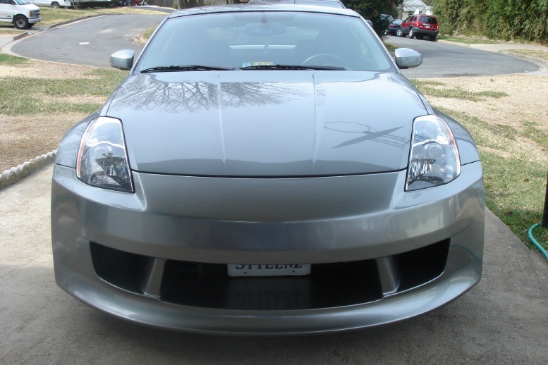

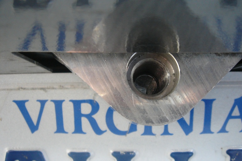

Just buy a 5/8 bolt and nut from Home Depot,98cents. Drill a hole in the top of the license plate to size of bolt. Thread nut and bolt through the back of the license plate and through the back of the tow hitch, in that order. Tighten with nut. No bracket needed.
Thanks Mike...I got the idea from him at the AAM meet as well.

But the Home Depot bracket... that's ingenious. Might have to do that. How long of a bolt do you need?

Its a 5/8 x 2" bolt. It wont thread the whole way through but it will enough to stay on securely.
