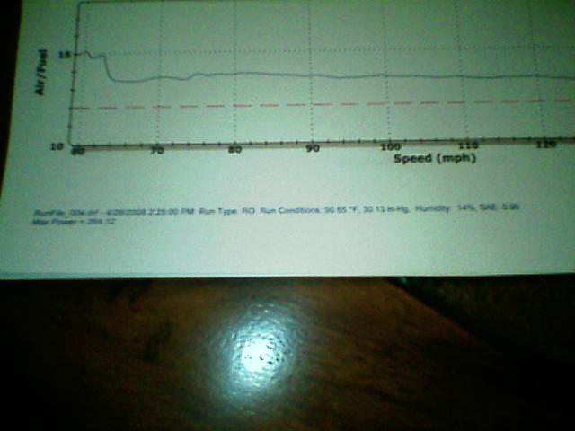

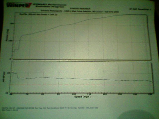

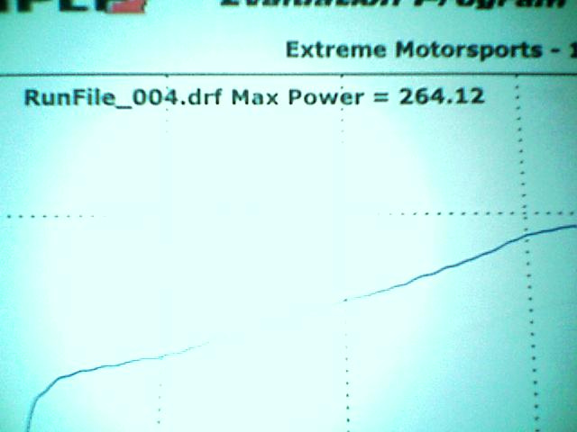

Heres an update: baspence went to extreme today and recalculated the dyno based on speed and not rpm.
Gave around 265 whp. (i dont remember the exact number)
Old Apr 28, 2008 | 02:43 PM
  #73
baspence's Avatar
baspence
Joined: Nov 2007
Posts: 313
From: From NC to VA to TN
crappy cell phone pics....
sean (the owner of extreme) put the pulls on the speed format instead of the rpm format because the plot was broken up. when you put it on the speed setting it was obviously not broken and could get a more accurate number. still not what I was hoping but not that bad. as you can see it was 90 degrees the time of my pull.

the reason it changed from rpm to speed is because the computer wasn't getting a good signal to read it correctly. basically the tach on the computer was jumping around and the power that it measured at the rpm with the jumping wasn't accurate. when you go by speed there's not multiple numbers for a given speed. that's why the number changed. we went back and were looking at it and the rpm was all broken up, changed it and it was a smooth line. we didn't change anything else, just looked at it in a different mode.
