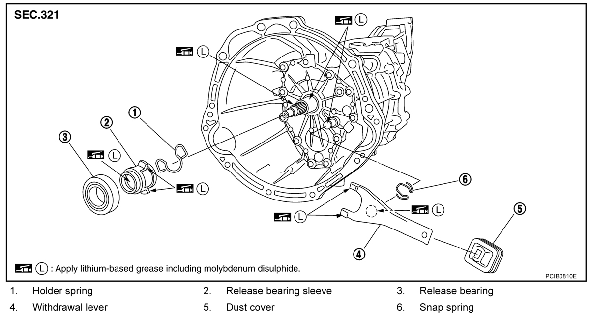

My father actually talked with his BMW mechanic and came back with the same answer as well. So, if there is a good chance its clutch issues inside the bell-housing, how difficult is it to drop the tranny? Is it something I could probably do in my garage with the help of 1-2 people in a weekend or is it worth getting it to someone with a full-fledged lift? I've dropped the tranny out of my '67 Mustang several times with no problems but that car was a tad less complex than the Z.
I bought this car when it had ~51,000 miles on it and the owner replaced the clutch/flywheel as part of the purchase, so I'm wondering if they may have mis-torqued something or not installed something properly. After taking a look at the service manual (CL-13....See attachment), I'm guessing the "Holder Spring" or "Snap Spring" may have come loose / off. Any other suggestions? As I mentioned the clutch pedal and hydraulic system now seem tight and functioning properly. I've tested the Slave Cylinder and it is definitely depressing/releasing the fork.

Long story short. Unknown to me, a short time before I bought the car (~18,000 miles ago @ 51,000 miles) the clutch/flywheel was apparently replaced & whoever did it didn't loktite & torque the flywheel bolts correctly. 1 of them ended up unscrewing itself & spending a few months rolling around in my bell-housing, tearing up everything in sight until it finally got caught & stopped it in its track. Hello new clutch, flywheel & throwout bearing.
