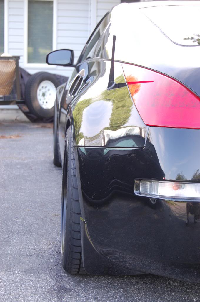

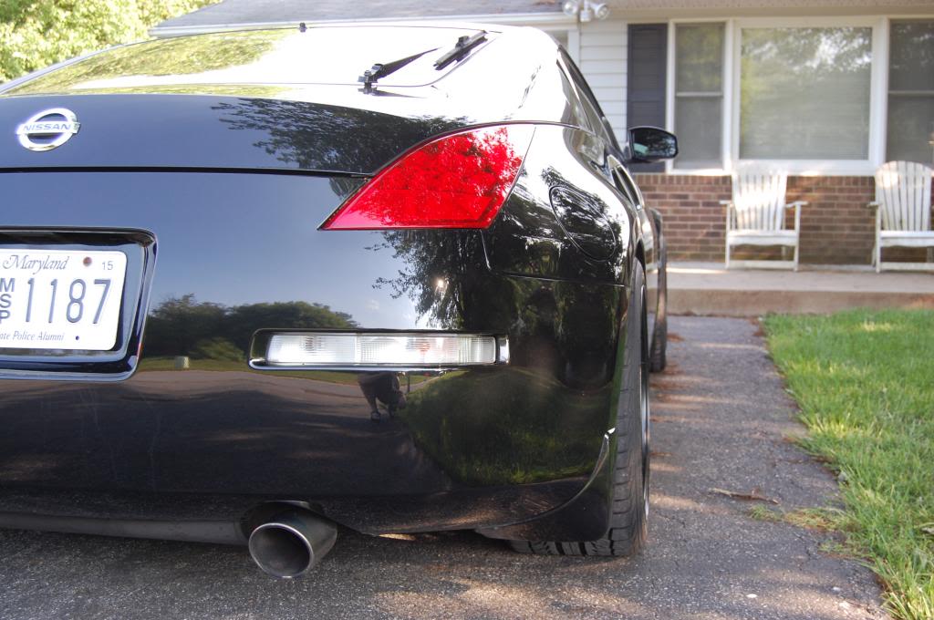

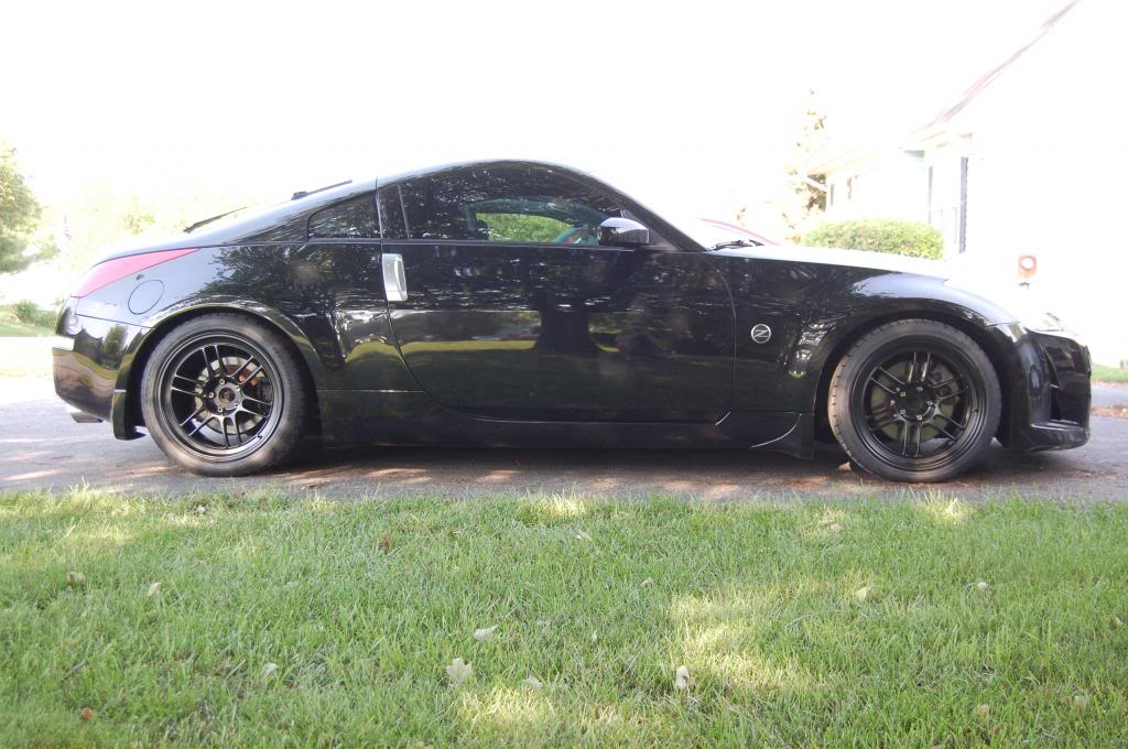

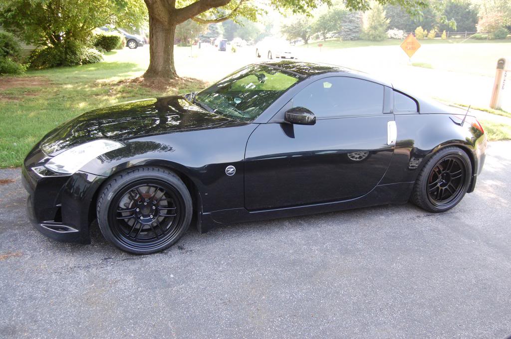

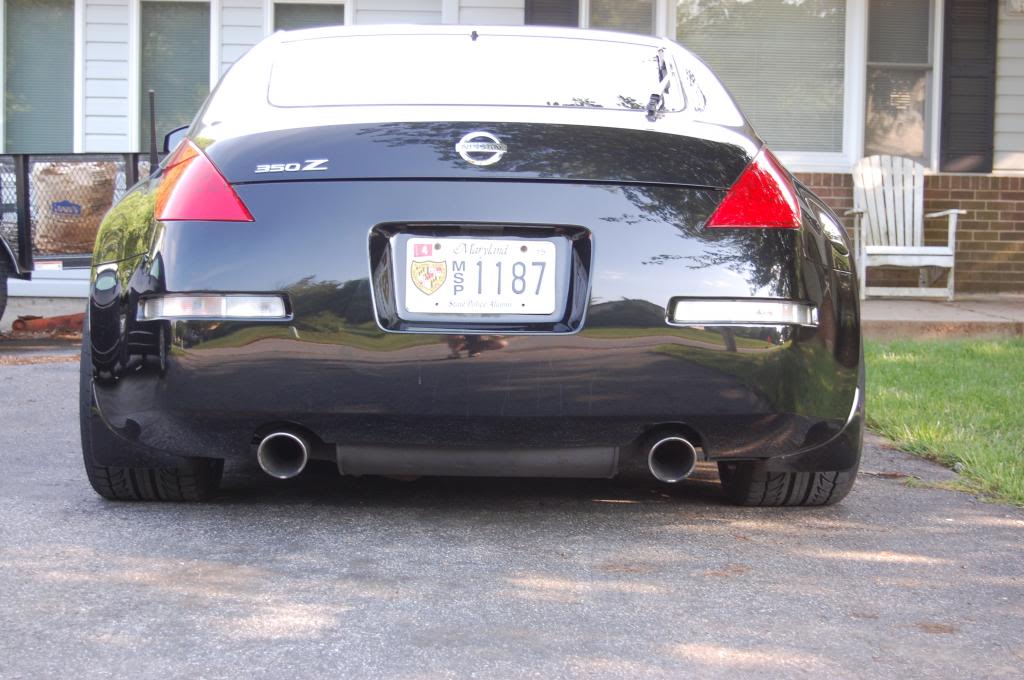

Done that several times, figured it out. Have to get use to the incremental increases each time I adjust it. As it sits right now:

Bought the SPC camber kit and the tech that did the alignment said he can't adjust camber in the rear even though the SPC rear camber arm has been installed. Same Tech said I couldn't adjust the height in the rear any higher even though I did today...which is what led me to believe I should get a second opinion.

Need to go lower.

Looks like stock height.

it's 1.2" lower in front and 2.5" lower in rear, the rear still rubs when i go over bumps and when I make turns. If I could adjust the camber I would be fine but apparently the camber arms I got adjust toe they said. Makes no sense to me

Your fenders rolled??

Don't lower it more I like lowered and functional which is what it seems you have accomplished. As you adjust camber in, toe goes out of spec. That's with just using arms. I had to use camber arms, "toe" arms, AND eccentric bolts to get for correct and get as much positive camber as I wanted (straight line traction)
The tech may be right in regards to your setup but didn't explain it correctly. Roll the fenders and be done with it.

Lowered anymore and handling goes out the window. What are your alignment specs?

I'm happy with how low it is just need to roll the fenders, purpose is for the occasional track days and if I go lower I won't have as much travel. Not sure what my alignment specs were something around -1.0
I used the SPC toe bolts that cane with the camber kit but after reading around it seems that bolt moves all the time throwing off the alignment, may need to buy the SPL bolts with the eccentric bolts to really dial it in correctly. Looks like the "standard" camber for my setup is around -2. Far as rolling the fenders thinking about taking it to Elite, you guys have any other recommendations?
