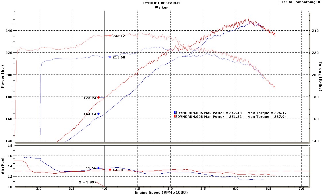

Just to put my .2 in here. After I got done porting and polishing my 05's engine it was not until I swapped out the factory headers that I saw the largest gains. I would realy look into Long tube or like headers. Here was my graph before and after headers on my 05. I can only belive that you should see better gains with your set up.
intake
5/16
port and polish intake/heads/tb
nismo exh.
intake
5/16
topspeed headers
nismo exh.
Attached Thumbnails New dyno numbers: 294 rwhp-dynoheaders.jpg
