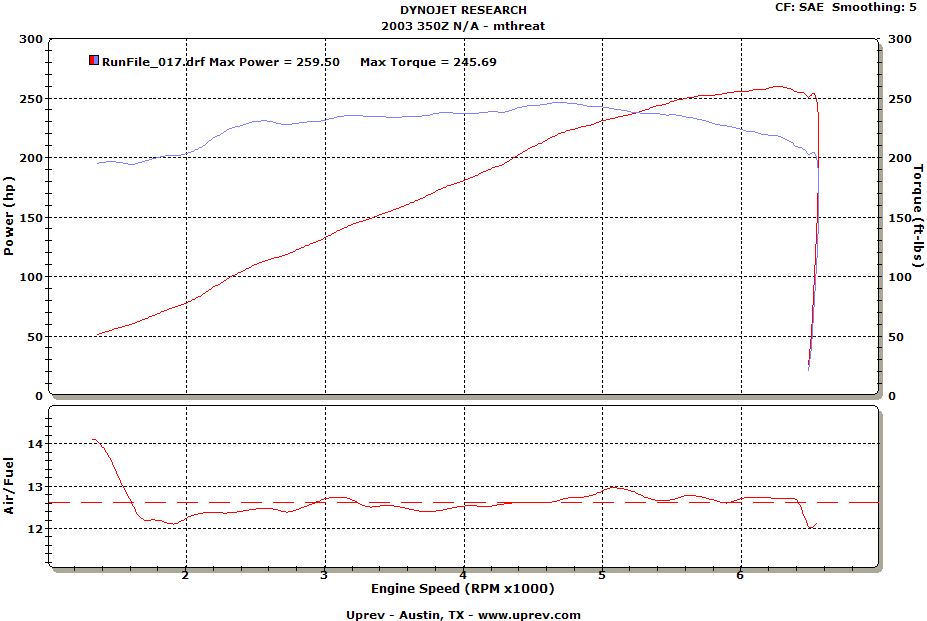

Update - Jared @ Uprev tuned my car today. The dyno chart is below. I had him give up 5-10 horsepower by tuning it a bit rich, and by not advancing the timing beyond stock, in order to keep the engine temps safe for track use. We tried advancing timing a few degrees but we heard pinging above 5500 rpm. (Remember I have 11:0 compression pistons, and stock is 10.3:1).
The peak numbers don't really matter, but they were 259 horsepower and 245 ft-lbs torque. Gas was 93 octane pump gas. The temperature was 80 degrees, humidity around 30%. Altitude around 700 feet.
Comments, advice, welcome as usual.
