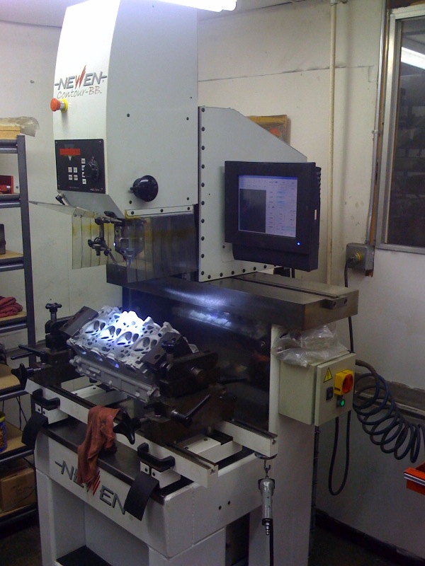

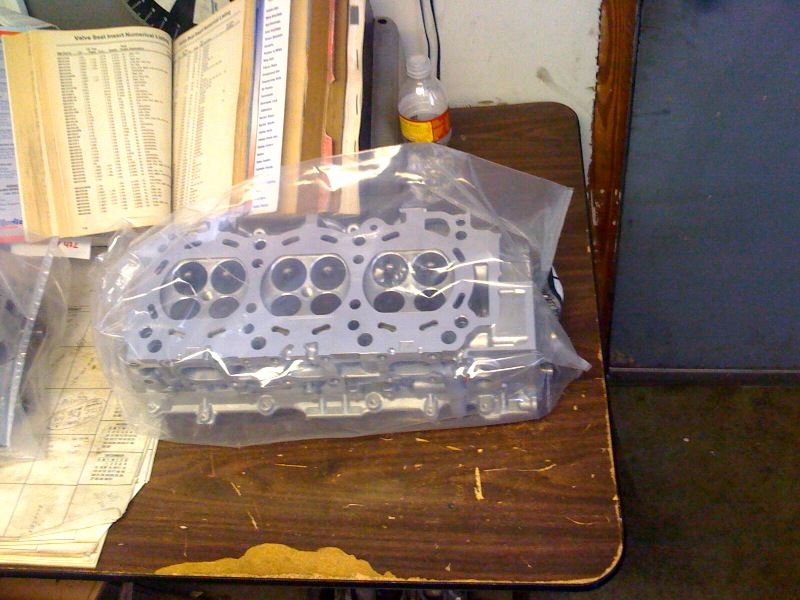

In other news.. I got the heads back from the head expert, Brooks Elliot, today. They look awesome. He ended up doing a 5-angle valve job on the intake. Here are some pics. The first one is the machine he uses to do the actual valve cutting. He programs in the angles he wants, and tells the computer approximately how much metal is already there, and the machine cuts each valve seat in about a minute and a half. The screen in the 2nd pic shows the 5 angles (if you look closely). The line on the left is where the metal was originally, and the lines on the right is what the machine will cut (the 5 angles). The difference looks big, but it's actually millimeters or less. The last pic is just one of the heads wrapped and ready to go.
