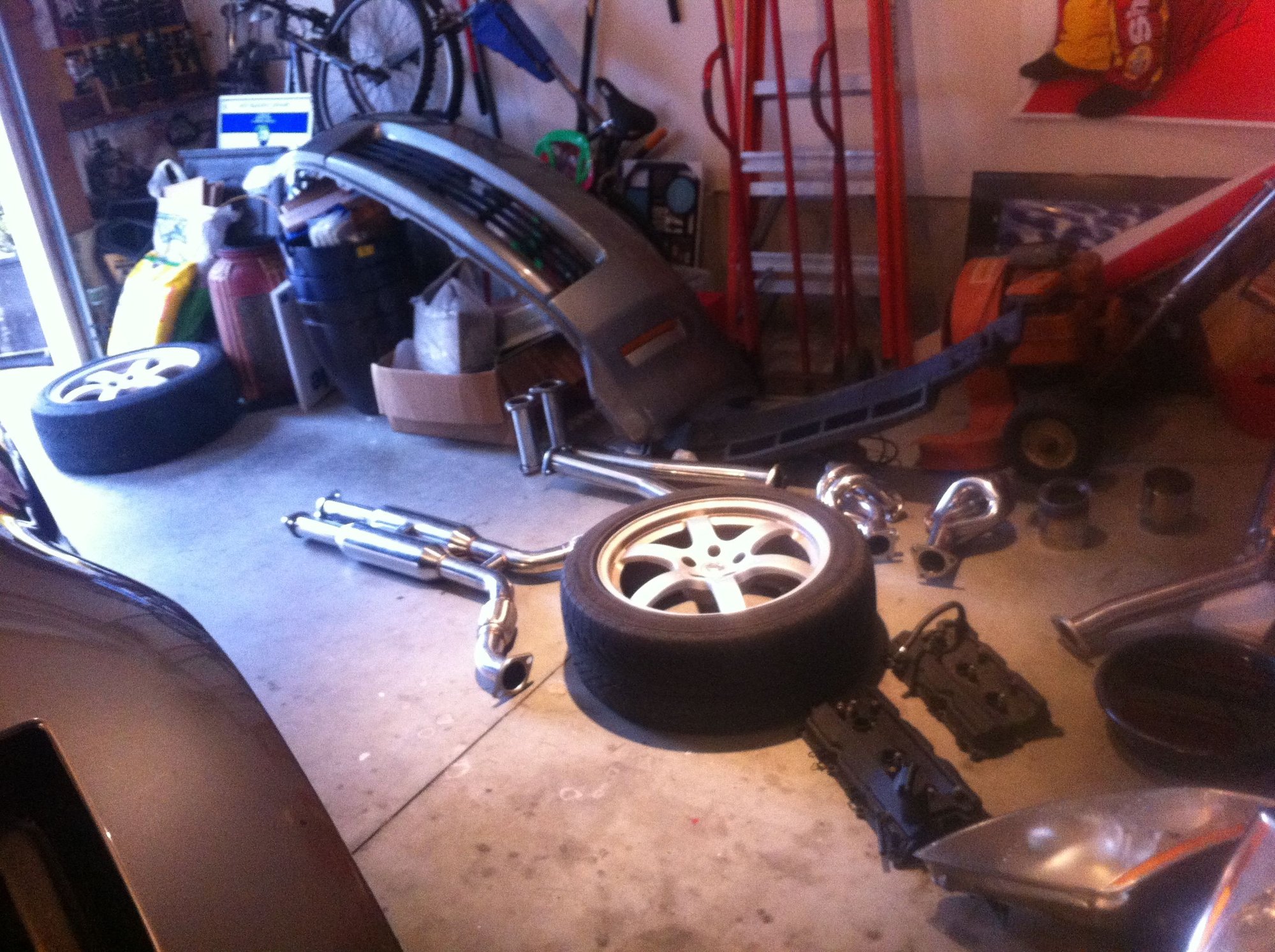

alright i am back in Italy now and i wont be seeing my car for another 45 days as its getting shipped to me.Good news and bad news here. Went home and solved a whole host of problems on it (found them after seeing it for the first time) Headers were a PITA even with the valve covers and upper intake removed. But they are on.. only other problem was they rubbed the steering column a small amount then turning to the right, so they got a little trimming from my die grinder and everything is well now. other problems I found were.. A massive oil leak from what we thought was just the valve cover gaskets ended up being from the front timing cover.. where it was missing 10 bolts.. yes 10 bolts... i guess thats what happens when you buy a car from a dude that blew up a turbo motor, swapped a stock one in and was just trying to get out of a loan??#fail. The rest of the process was pretty painless.. the LTW flywheel,new clutch, and tranny took about four hours to install and made putting the headers in with the tranny off very easy. She also got a new themostat and headlights while she was apart. BAD NEWS: the flywheel pulley (unorthodox racing LTW) seems to be stuck on there (yes it was on when I got the car, I dont trust ltw pullies so i tend to keep stock harmonic balancers especially with high rpm) The blue point impact (700 lbs/ft breakaway torque) broke a couple sockets trying to spin that **** loose. SO, i didnt really have the time to put the wheels back on and put it in 6th with the e brake up and a take five foot pole to it.. so needless to say the rod bolts and rev-u oil pump didnt get done.. oh well.. more for me to do when the car gets here if i can get the crank pulley off.
sorry for the crappy pics, I was flyin through this as I didnt have time to get much done. All this work was accomplished in about four days of work for the record. (with the help of my best friends of course, having extra hands always helps)
here she is, front end off (those a/c quick disconnect lines suck! i want to get some bolted lines or find a solution for this cause im pretty sure i ruined the one line trying to release the QD with those stupid tools that are supposed to work) the oil in this pig was disgusting.. this car has evidence it has been sitting for a minute too.
just showing how tight some of the header bolts are.. such a pita.. by far the LONGEST part of anything on here. Transmission was removed, flywheel and clutch back on, and the tranny was back in FASTER than it took to get the headers done. Look at all that gunk from the valve cover and front cover timing leak.
parts pile, new headlights were also put in it was a might as wel thing, the guy that owned it before me was lowered so he took out the fender liners (PORQUEEEE?!) at least fender liners for this car are only 80 bucks a piece and ill be running a splitter in the future so i guess its not too bad. The OEM headlight went out because the ballast was filled with water that was getting up from the wheels straight into the headlight housing making it a fishtank. PS if you guys are buying new Headlights, and already have an oem xenon HID setup, go ahead and buy the Halogen OEM housings ( about 200, good quality too) and just swap your harness form the hid headlights, cut a hole where the ballast wires run through and walla you have OEM quality headlights, OEM HID setup/wiring and your saving 400
She got new shoes too, Falken/Ohtsu FP7000, great tires and great price for them too. 245/40/18 rears and 225/40/18 fronts. Next set of tires is going to be 245/40 or 255/40 in the front and 265 or 275/40 in the back, i wasnt a fan of how stretch and low profile these had with the track rays.

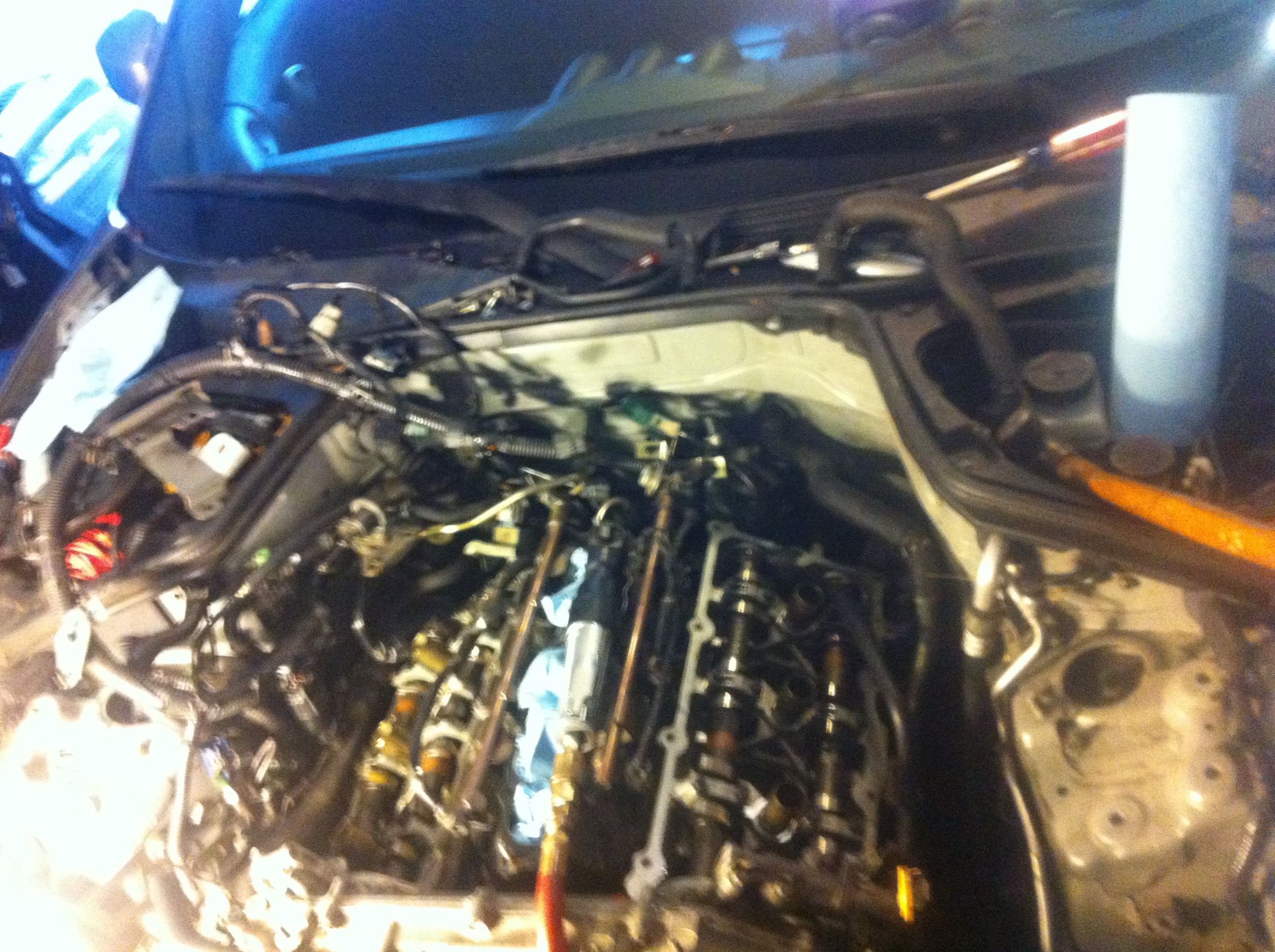

Measuring valve lash on the exhaust cams. FSM states .26-.36mm on the exhaust side for cold lash. I prefer a little on the loose side so they have some room to tighten up as the valve faces wear a tiny bit, so if anything is out of spec its OK to be a tad loose, A TINY BIT. As it wears it will tighten and not loosen.
No, im not actually measuring in this pic. Here's what she looked like before her voyage down to Charleston, SC.
Ill just be swapping around intake and exhaust buckets, mixing and matching until I get as many buckets within spec that I can, then I will order new ones if I need them (Hopefully not)
One tight, one loose.
