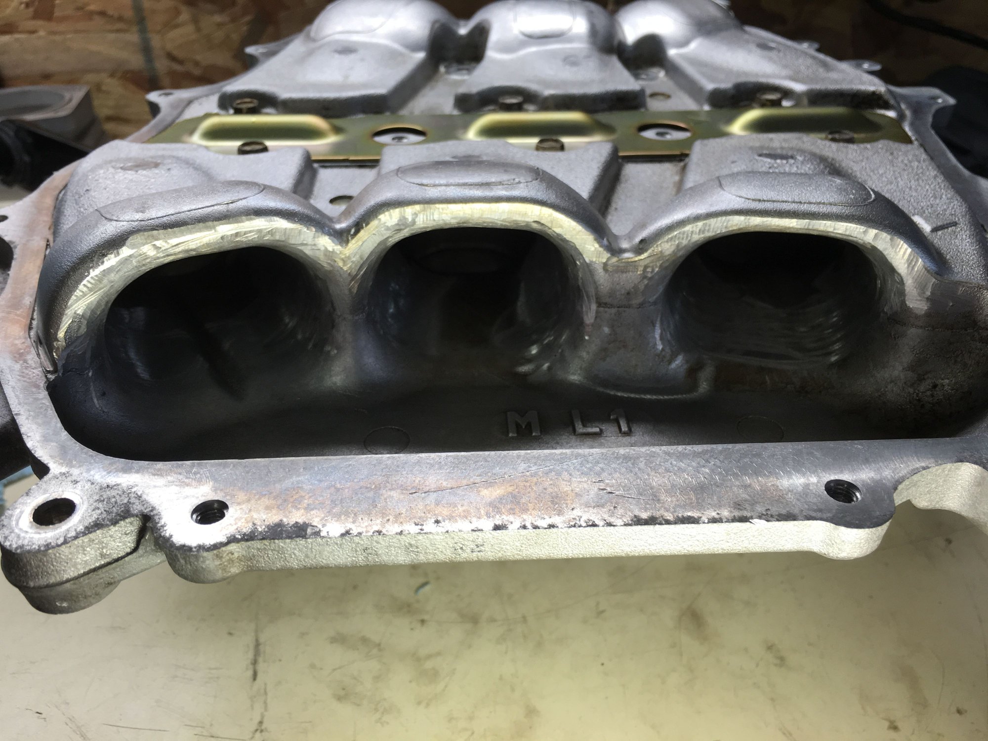

I finally got a reliable supplier for flanges. The 2 people who sent me plenums they are complete and I have contacted both of them. These 3 are ready for homes.
Old Mar 7, 2016 | 05:37 PM
  #133
1cockyZ's Avatar
1cockyZ
iTrader: (46)
Posts: 491
From: Toms River, NJ
That's 3.5"
That water line is actually not touching but that is how close the fit is
OEM like fitment

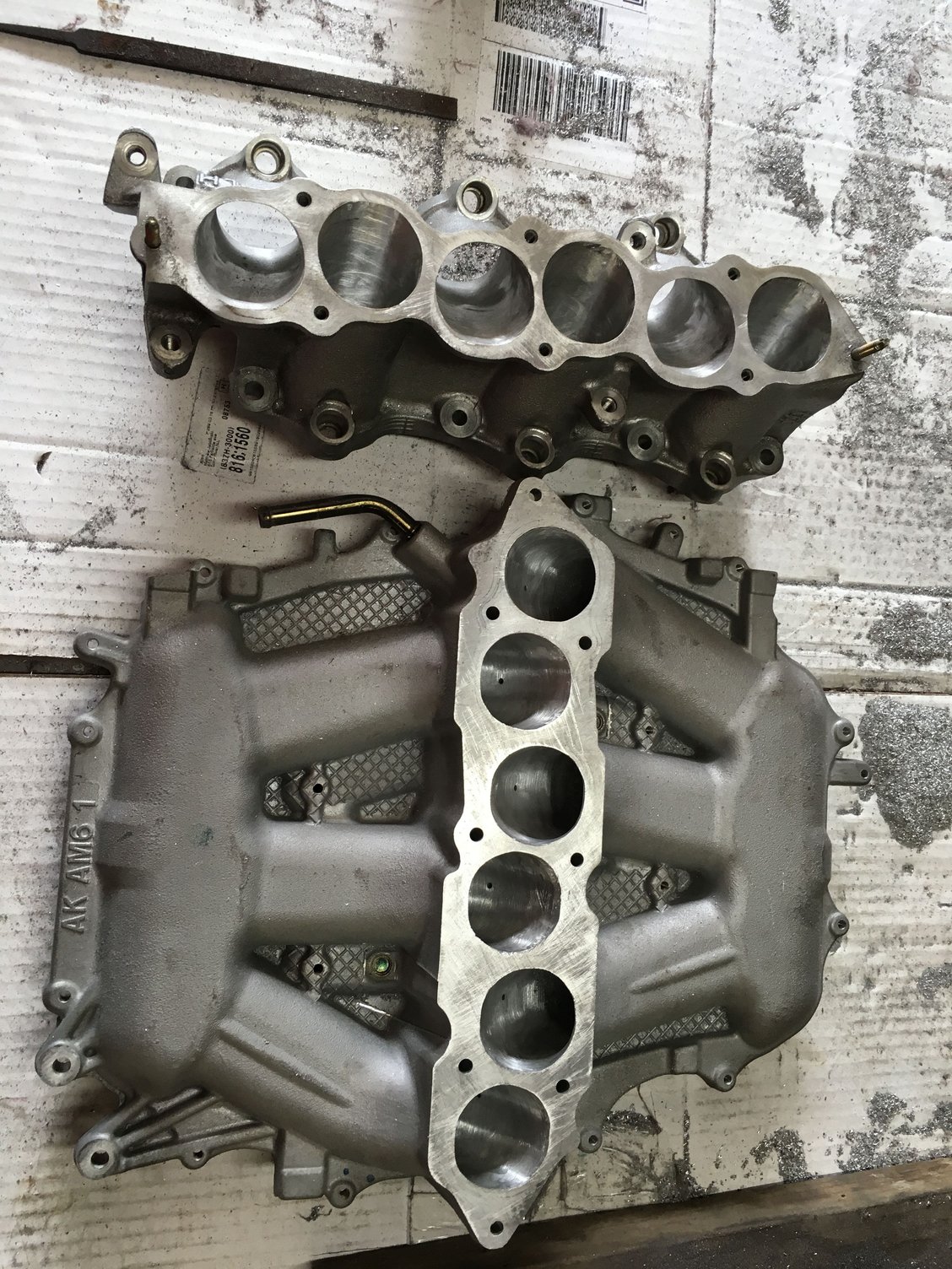

The overlap from collector to lower
Port matched
A little off the top. Been wanting to do this for a long time just to see if it works.

So you've port-matched them, do you plan to "port" them as well?
These were fairly nice casting, some of the better ones that I have worked with.
Old Mar 10, 2016 | 02:12 PM
  #136
1cockyZ's Avatar
1cockyZ
iTrader: (46)
Posts: 491
They are to the edge of the gasket. Nothing super wild. The entries was where I focused.

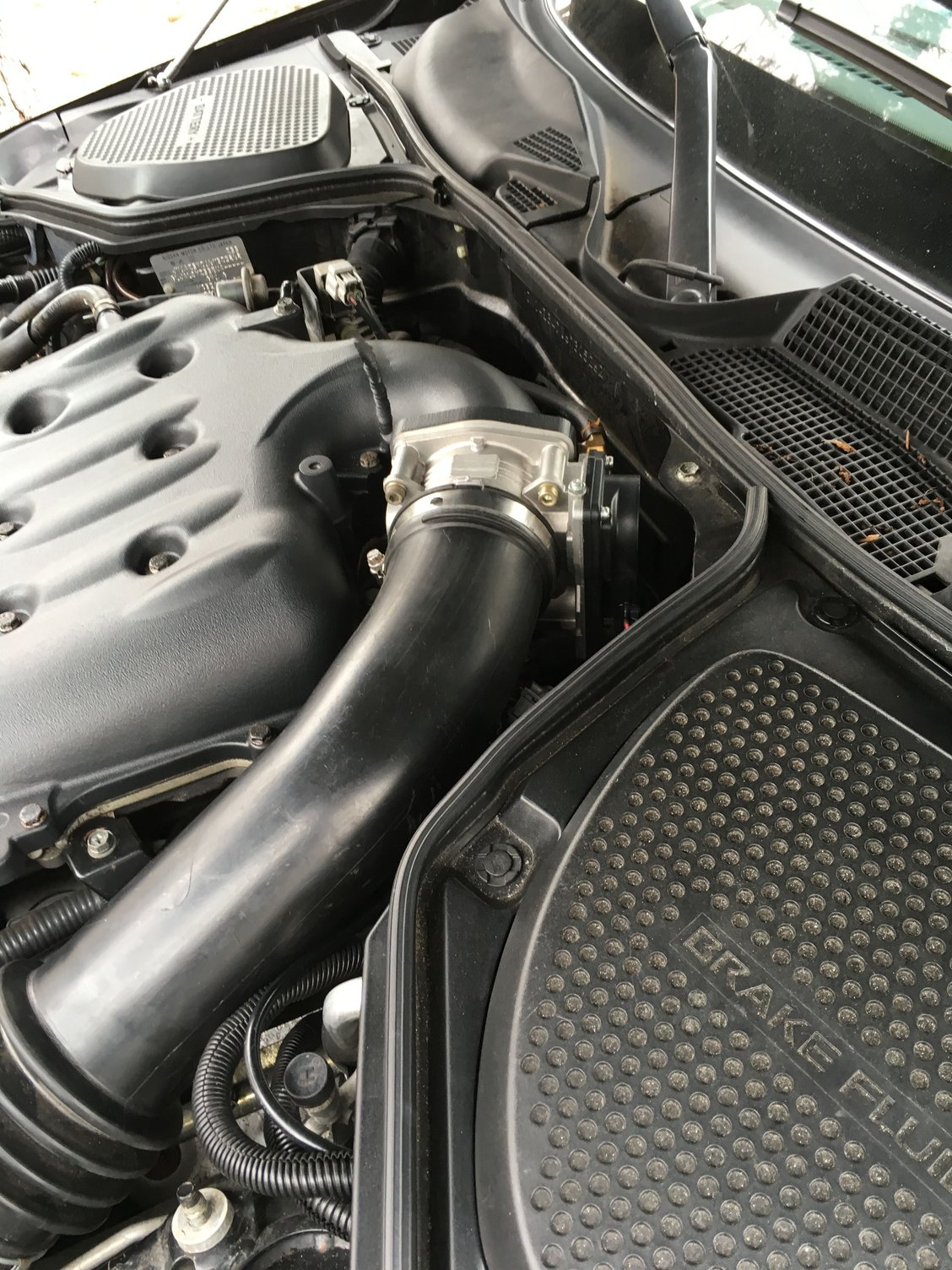

Powder coated one texture black, one of my favorite finishes.
Old Mar 20, 2016 | 06:35 AM
  #139
1cockyZ's Avatar
1cockyZ
iTrader: (46)
Posts: 491
Installed the first one yesterday. Fitment was great, with the spacer the one coolant line on the throttle body had to eliminated.
