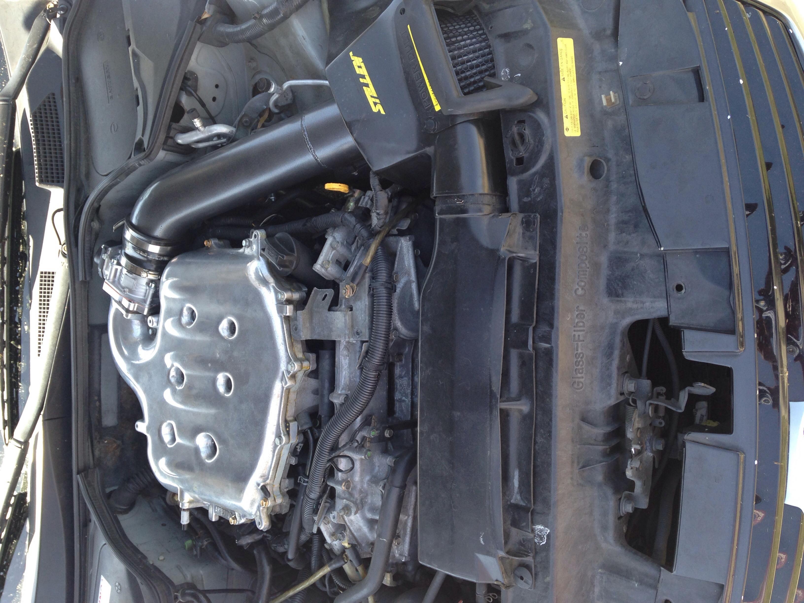

Side pic

My 3.5 intake setup with 3.5 velocity stack and R2C filter.
Both lowers are ported with a 1/2 spacer.
Sorry for the sideways pic.
