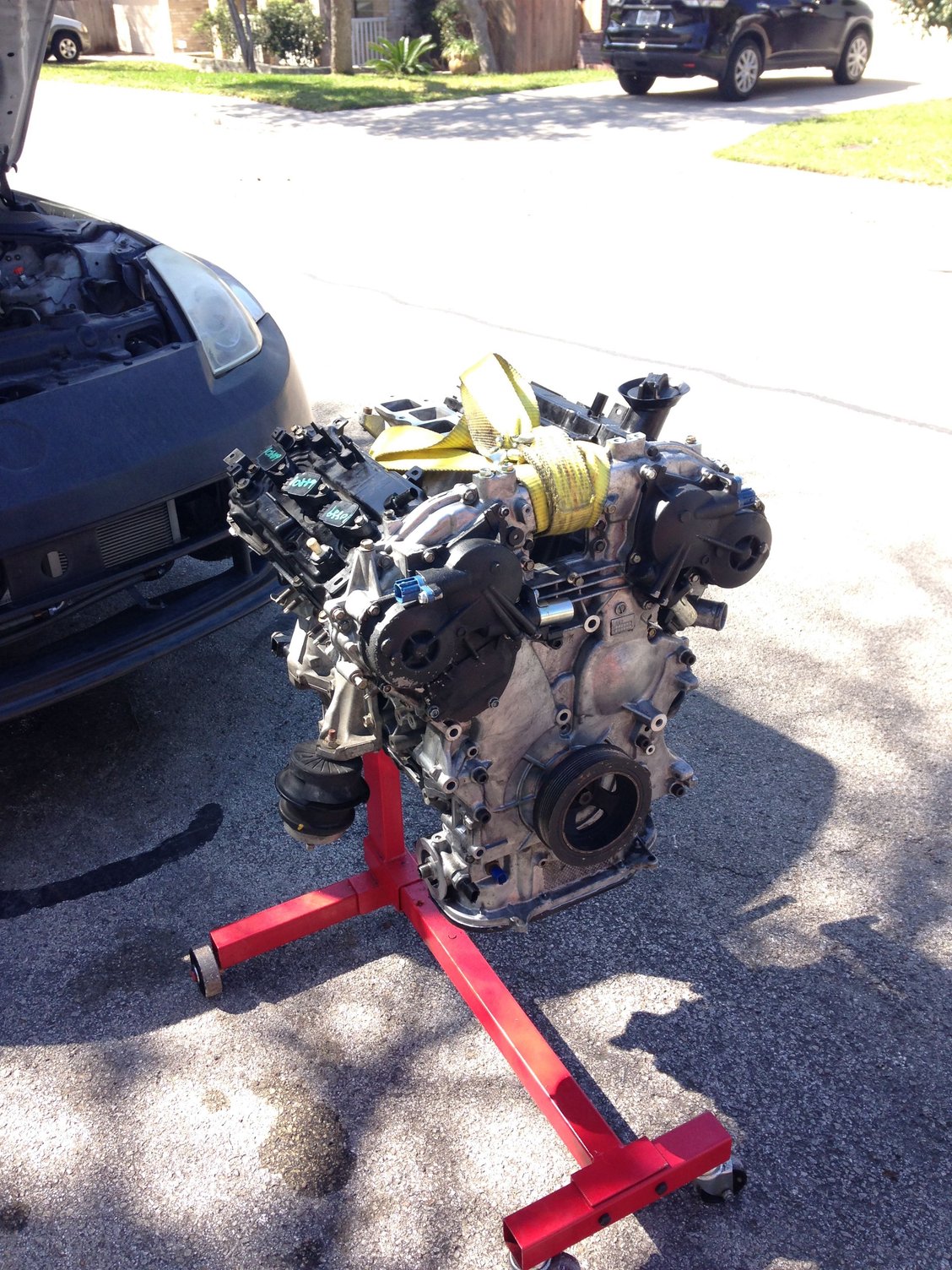

Little more than a week ago, the motor died
Source of the problem is definitely the crank key. Bouncing off the rev limiter at 8k rpm was probably what did it haha going to replace the crankshaft, gear, and pulley. I also plan to do some checks to make sure no valves got bent. Once I get the motor back on the stand, I'll take a bunch of pics of the insides to see how the bottom end is holding up to abuse. Lets pray that amsoil is doing its job

Got the engine out about 2 weeks ago.
After disassembly, I found that the journals are lookin a little rough Gonna take the rev limiter down to 7700
The bearing closest to the flywheel side of the engine had the most damage
