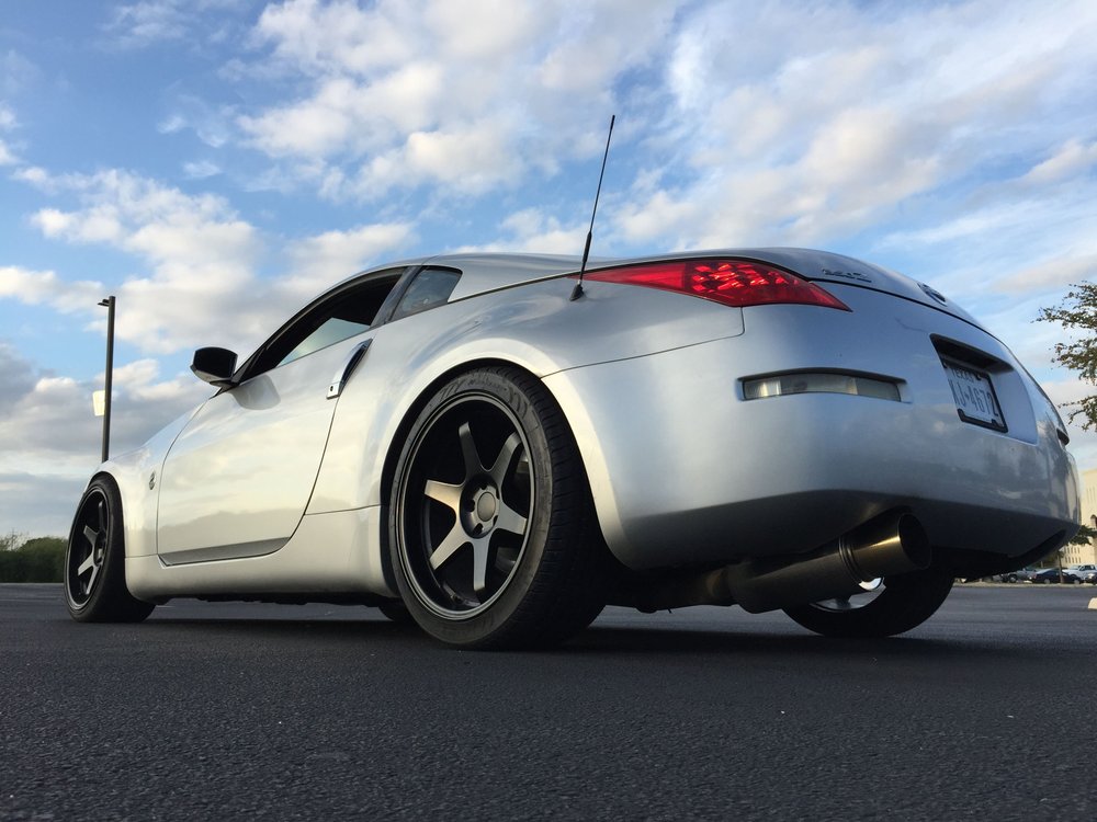

First off, the iPhone 6 has an amazing camera

My self fabricated 3" single with the GReddy RS muffler
