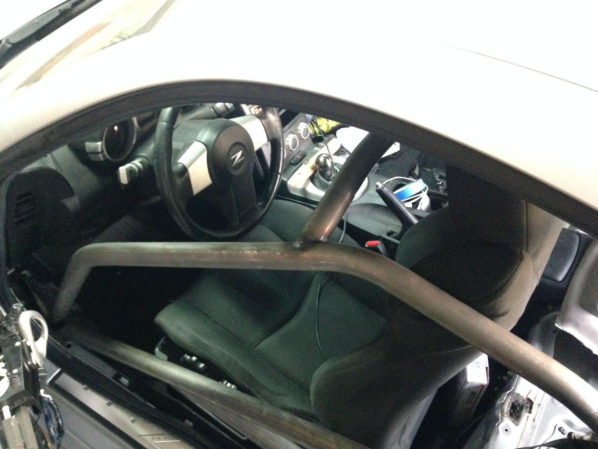

Still lots of work to do but I finally got started fabbing my roll cage. Hoping to be done by the end of the year

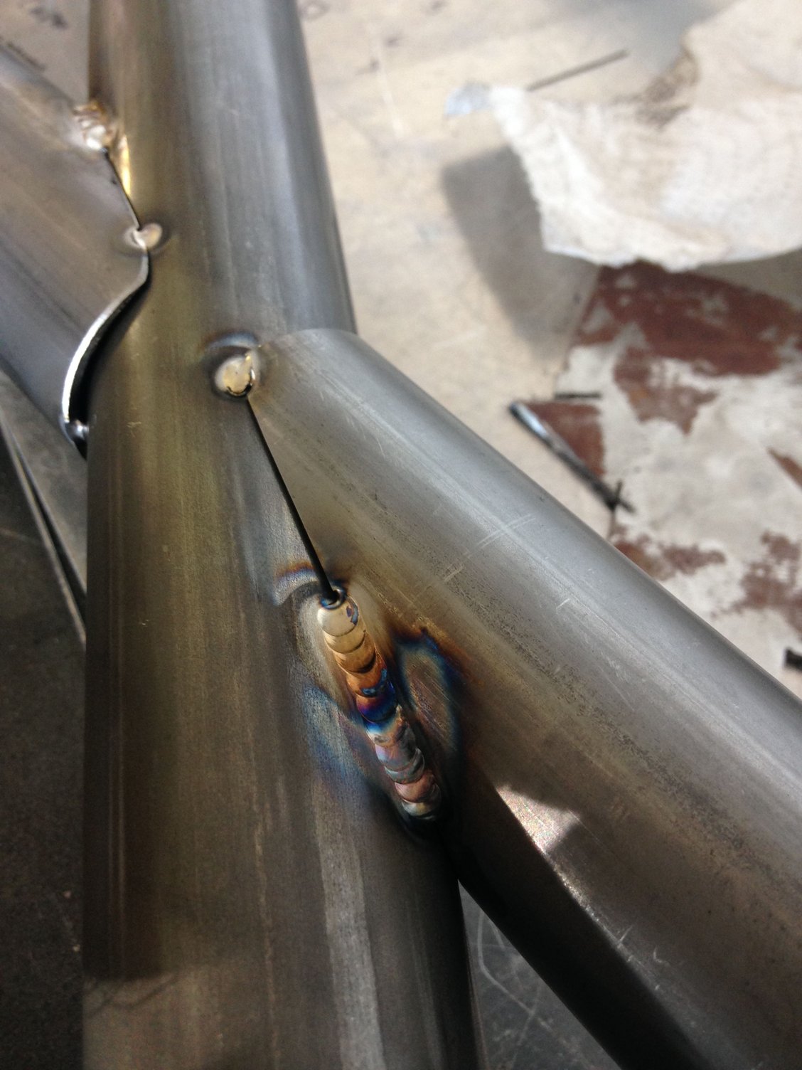

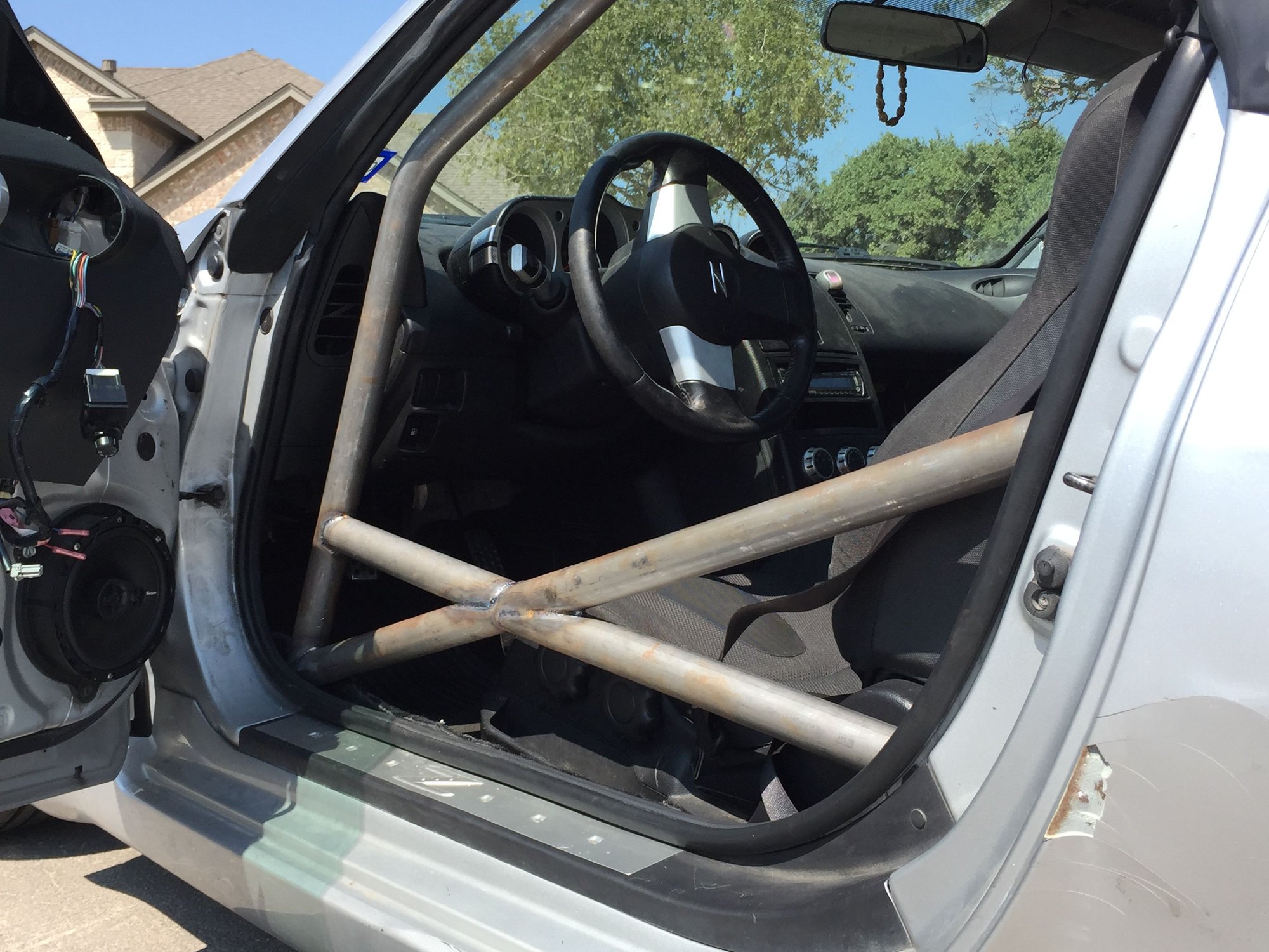

Sadly, the bend I made to make clearance for the roof is not FD legal So I had to cut them out and weld in straight pieces which wasted a little material
I CAN'T WAIT to finish this thing, clean everything out, and bolt the seat back down

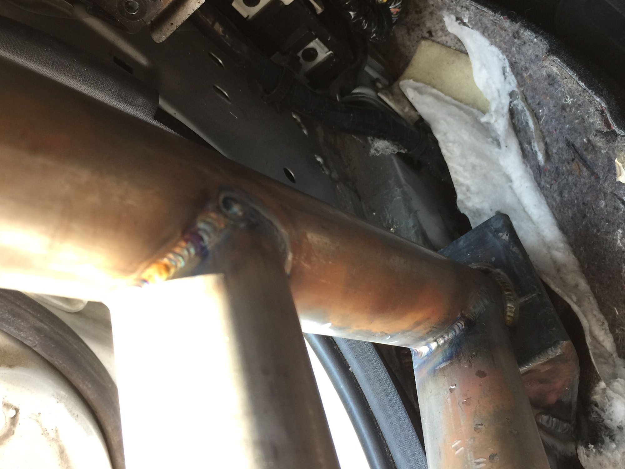

With the rear section complete and the door bars tacked in place, I was able to move this whole part of the cage forward and reach the tight spots for the main hoop/door bar welds that would normally be impossible to reach.
After tacking both side hoops in and welding as much as possible to the roof brace, I was able to break the tacks on the main hoop and door bar and move this whole thing down and once again get the tight spots
With all of the hard spots done, it was finally time to weld in everything else

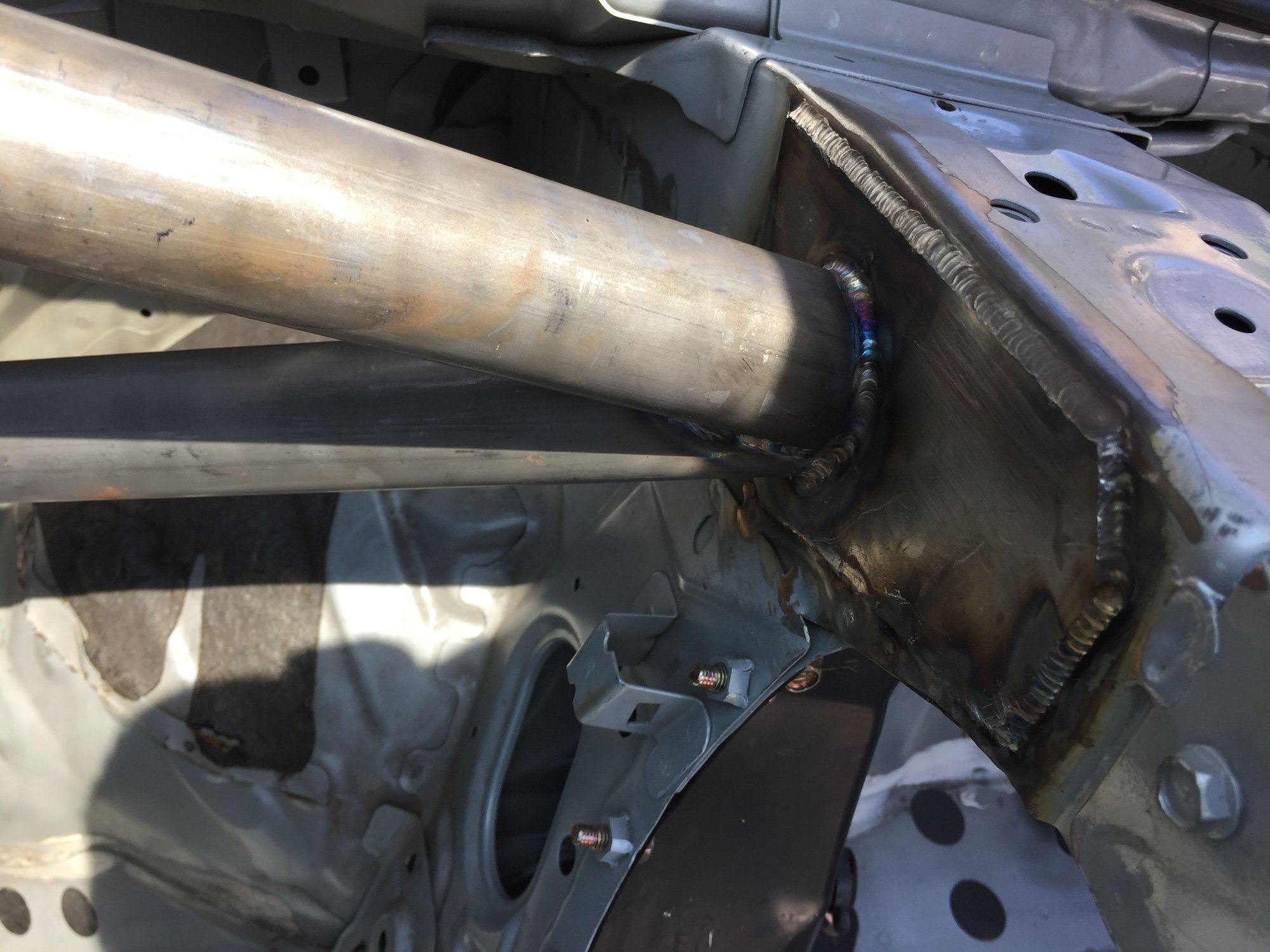

I am somewhat ashamed at how the main hoop base plates came out

Nice work, why are the OEM seat belts still in place
Old Sep 17, 2017 | 07:01 PM
  #58
venture210's Avatar
venture210
Joined: Apr 2013
Posts: 551
Likes: 46
From: texas
Short answer, convenience
I'm going to get 5 point harnesses since they are a requirement for the stuff I plan to take the car too. It's just nice being able to drive the car when I feel like and strap in quickly
