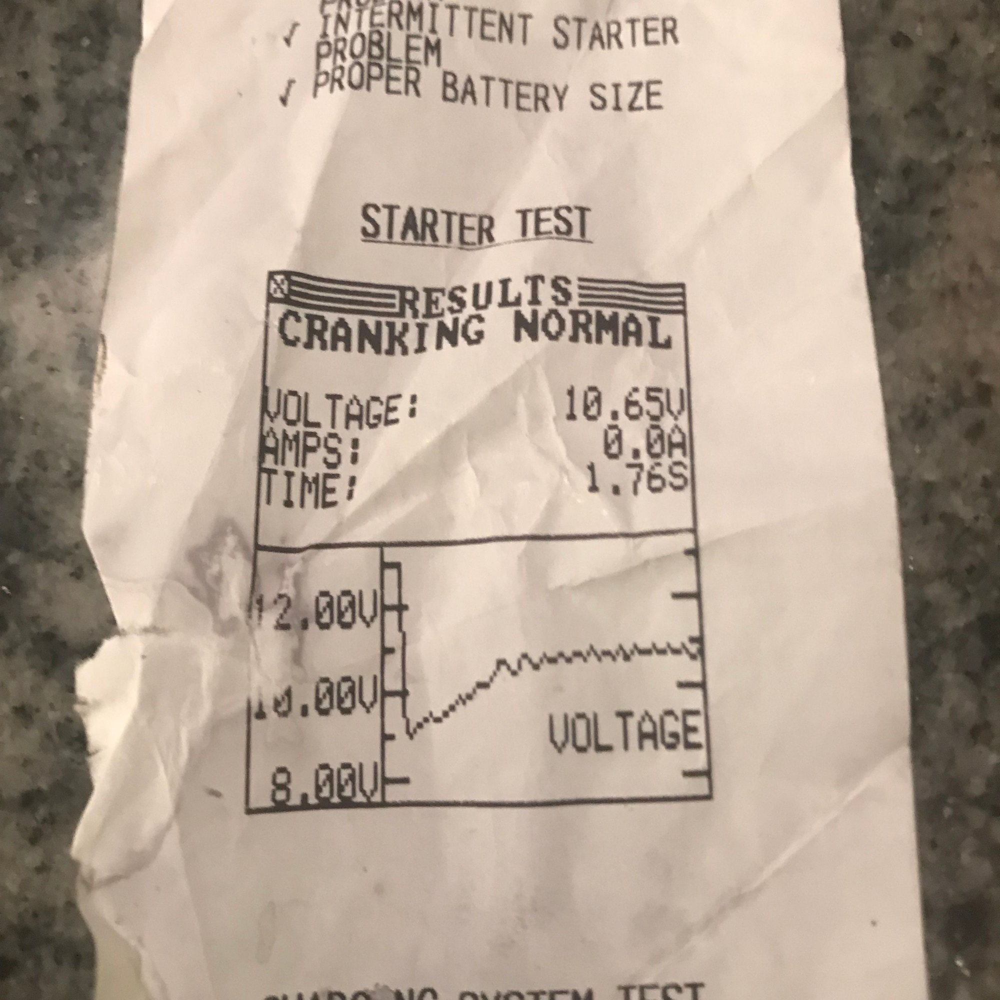

The car is cranking a few too many revolutions before firing for my taste, so Im off to the Advance Auto to check for codes and check the battery tomorrow.

Turning over too many times could be a dry start, would check your fuel pressure. Might be time to replace the fuel pump.

Yes I contemplated that theory. It does sound a tad weak when cranking, so Ill check the batt first and then move to sensors, fuel pump etc.

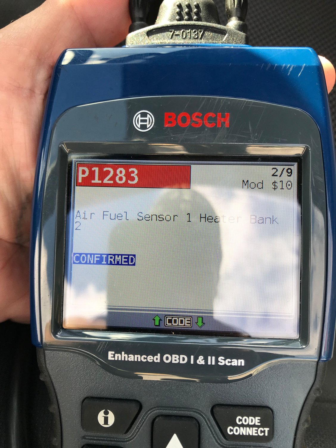

So, today, I went to the Advance Auto to have my battery and charging system checked and everything checked out. They did not have a code reader, so I travelled to the O'reillys and had them run the codes.
I have a cuople of codes that may solve my hard starting issue, Im 90% sure the camshaft position sensor is the cause of my hard starts after some research into the subject.

Cam sensors can definitely do this, Make sure you replace both with OEM

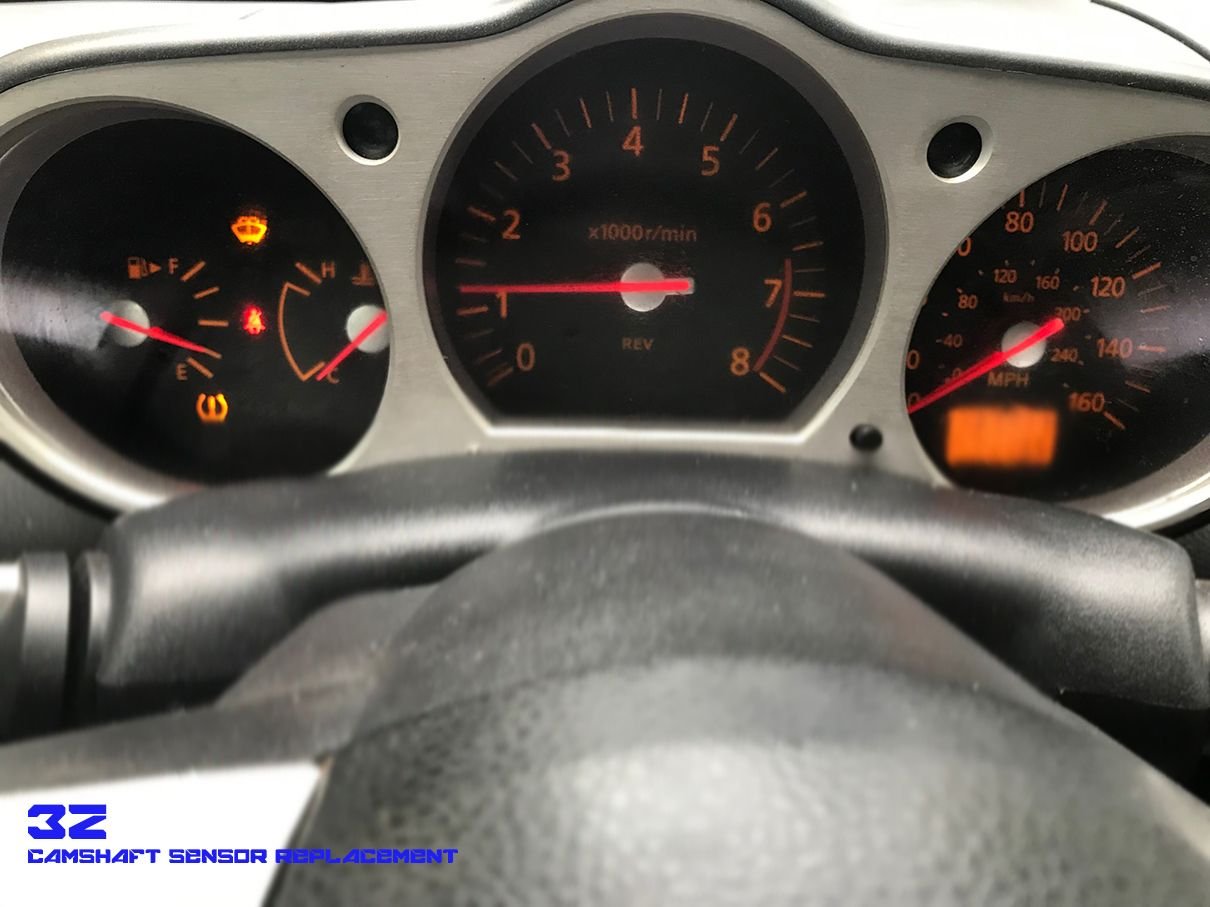

So Amazon sent me a silk pillowcase instead of my sensors. Somewhere, someone got a bunch of 350z sensors instead of their sexy pillowcase. So after opening that little gift, I just headed out to Advance and bought one.
Instant fix. After placement of the sensor, and a "quick reset" of the ECM,; SLIP and TRACTION CONTROL light are now off as well as the check engine light.
The car starts instantaneously, with no extra revolutions before firing. The extra sensors from Amazon will go into a tool box in the car for future use if the existing one fails.(1 year warranty) The Air/fuel sensor code will likely trigger the CEL down the road, I suspect there is a small leak near or at my test pipes triggering (lol) it.
I am wondering whether I was in "limp mode" and not getting 100% out of the car?

I hope someone reads this and is able to fix the hard starting/stalling of the 350z. It is an easy fix, Nissan would charge anywhere from 350 to 550 to do it; it can be done in 5 minutes. This maintenance is important to do because the Z can stall out while driving and lock the wheel in traffic.
Just remeber the "clip" pushes "in and ejects the sensor unlike most connections that pull "out" That one thing is the only sppedbump I encountered.
