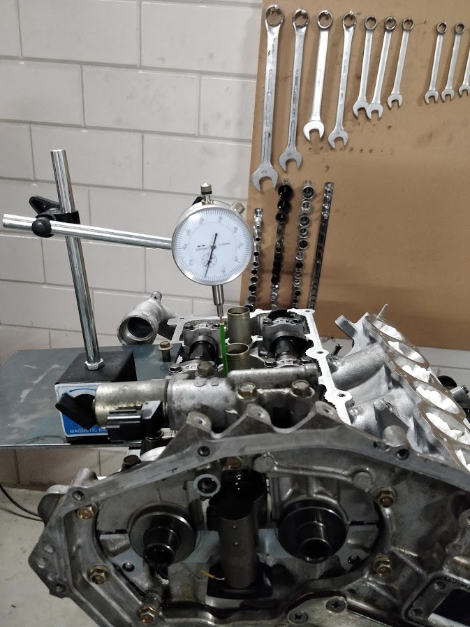

We discovered that the cams need different timings then the Nissan manual describes. So we contact the manufacture on this issue and started over...
We need to find to absolute TDC as show in the image below and then time the cams by how much they push valves down @TDC. So tonight we will once again time the engine.
In the end it tooks us multiple days to set the cams correctly because we couldnt use the OEM markings for timing anymore and it was a hard job todo to have the cams in the correct position and then tighten the sprocket on it without moving the cams.

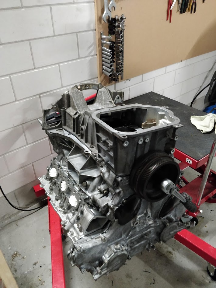

Also some new parts have arrived

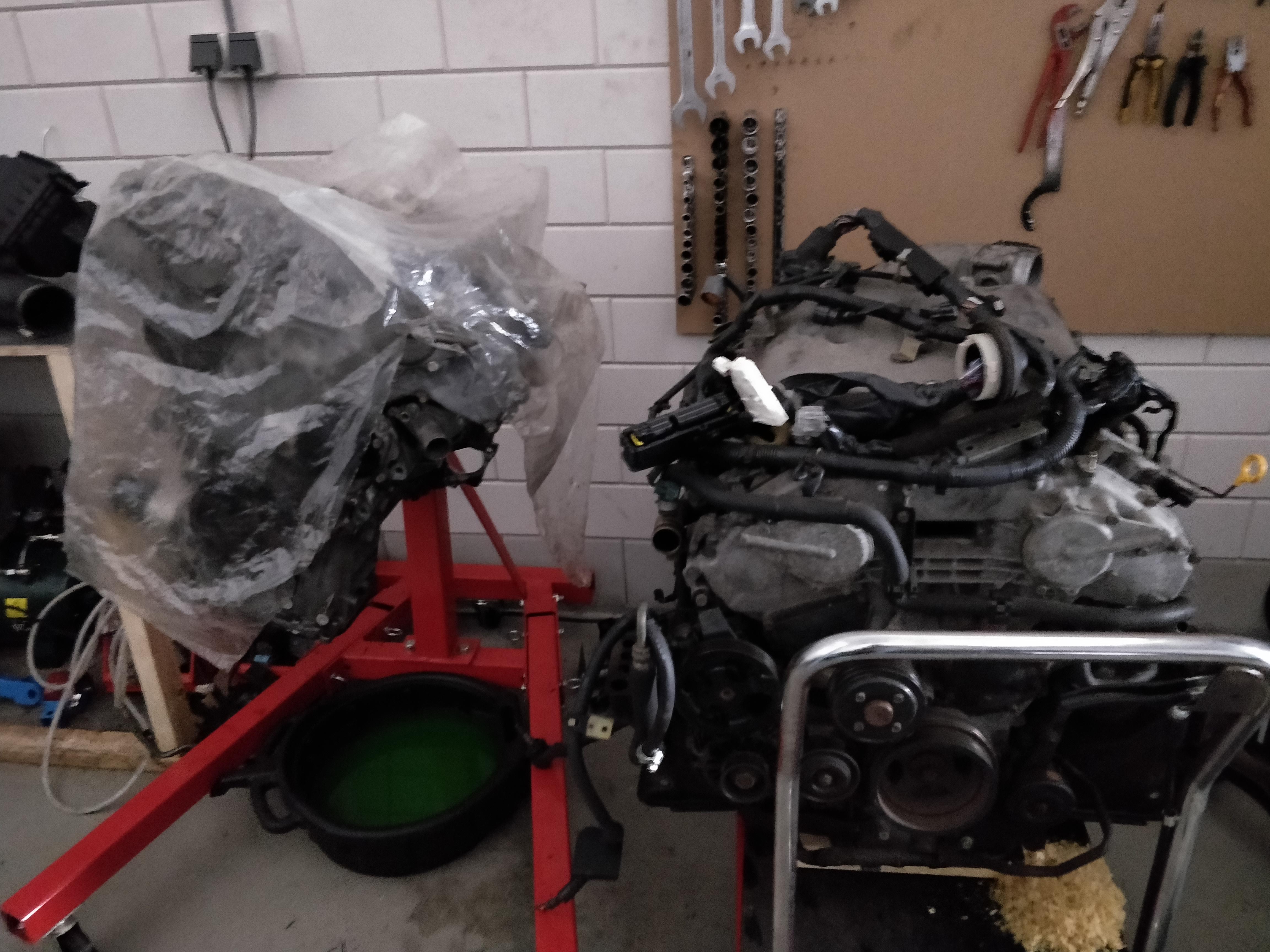

Last week we finally had time to start finishing this project.
The old engine has been removed
We then swapped some components from the old engine to the new engine and also fitted those nice long tube headers.
The engine is now in the car and tonight we gonna fit the transmission back and start connecting all the wires.

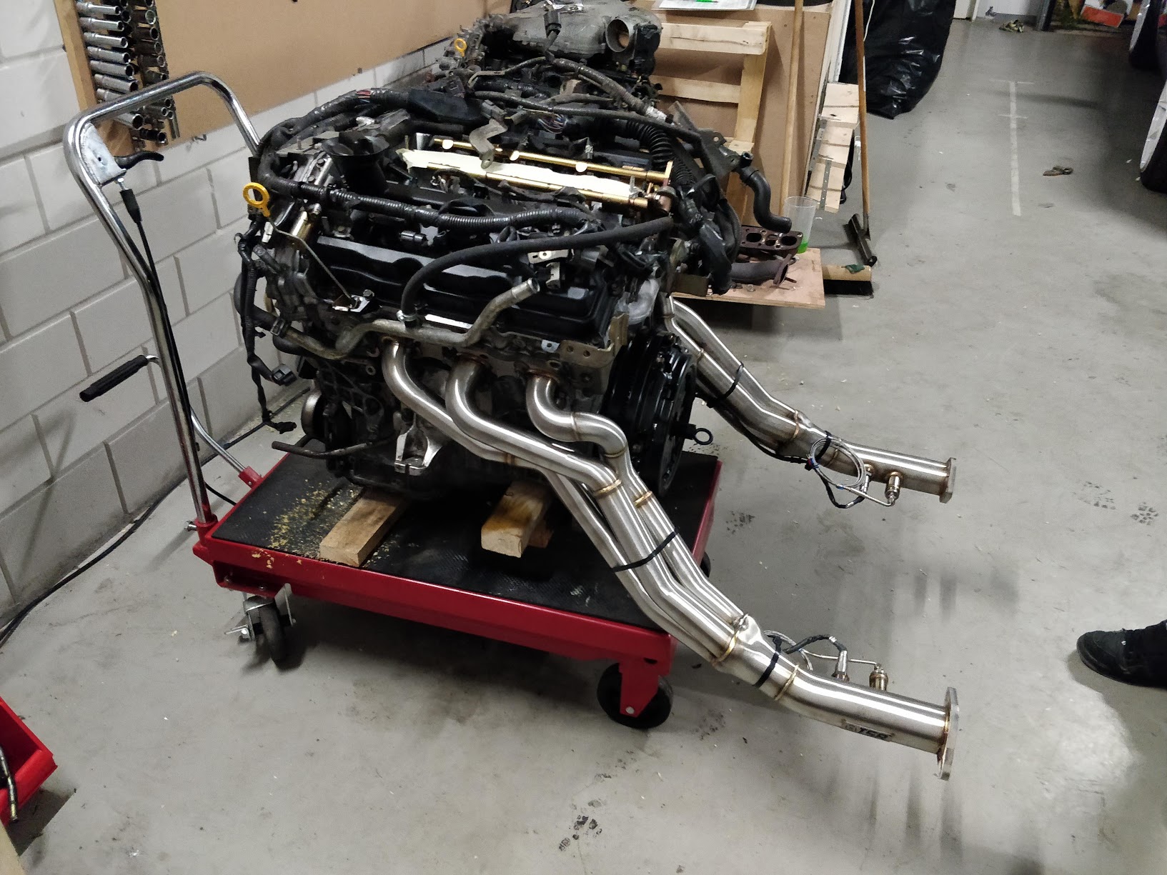

If you look at this picture with the headers installed yeah can see where they are positioned (after the widebands). I know its not the best spot because closer to the engine would be better but i want to get it done :P
Well yeah the cams are gonna be a pain in the *** to drive. The first response i got from the manufacturer after contacting them was "Are you gonna use this car on the road?" Uhhh no?
I have a haltech elite laying around so im gonna use that for now and gonna tune the car myself so no trouble getting the car to a tuner

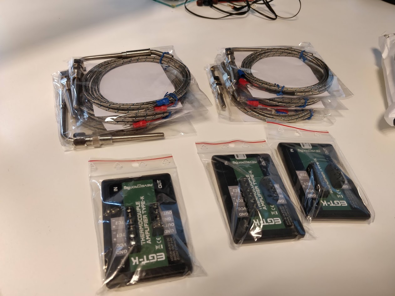

Yeah I thought it was common or at least expect people todo a little research but I have been told by multiple people that they run w60 because they have a turbo (on a stock engine).
Ik gonna use them just like you, to monitor the temps. The reason I got 2 was, because I needed something in the headers to seal them off, second they came in pairs 😉
And from my knowledge I don't see a problem to put them there or further back in the exhaust system.
