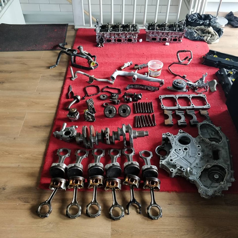

Well my engine started to have problems (very low compression test, lose of power) and after helping out friends with their turbo or supercharger projects i wanted something else because i don't care that much about power.
The idea was to go simple and not to go to wild (replace gaskets, different cams, other intake, done!).
But after swapping the engine i got from a friend of mine (he had one in reserve) things started rolling.

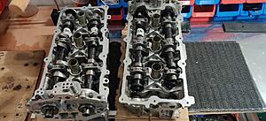

Well i still wanted different cams because why not and i was looking at the JWT C8 but then i found out a seller near mine location was selling some proper race cams for 1/3 the price of a JWT set. So now im the owner of some 294 duration 12mm lift cams... ow boy.
At this point i was like 'Yeah lets just go full retard and see how far we can go'.

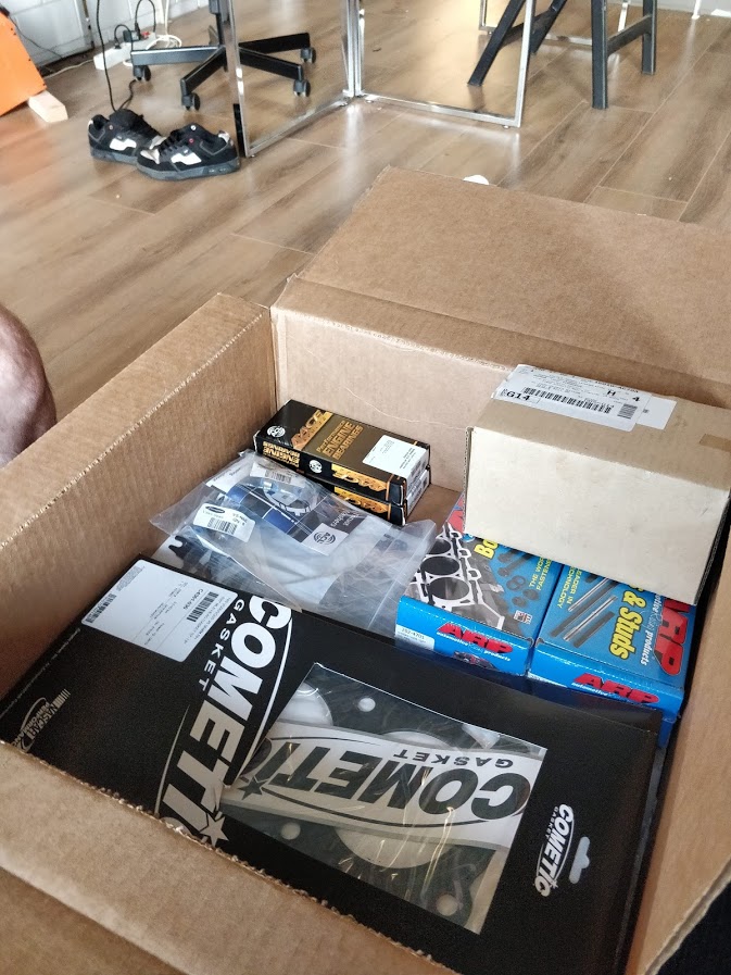

Ordered some parts in Amerika, like gaskets, studs, new rev-up oil pomp (i want to rev higher but not $1200 nismo pump high), etc
So at this point all the parts i needed where in and time to start fitting but we ran into a small problem. The cams didnt fit.
After contacting the manufacture they told us that we needed so special parts to lift the buckets and ofcourse heavy springs.
Right now we can start building!

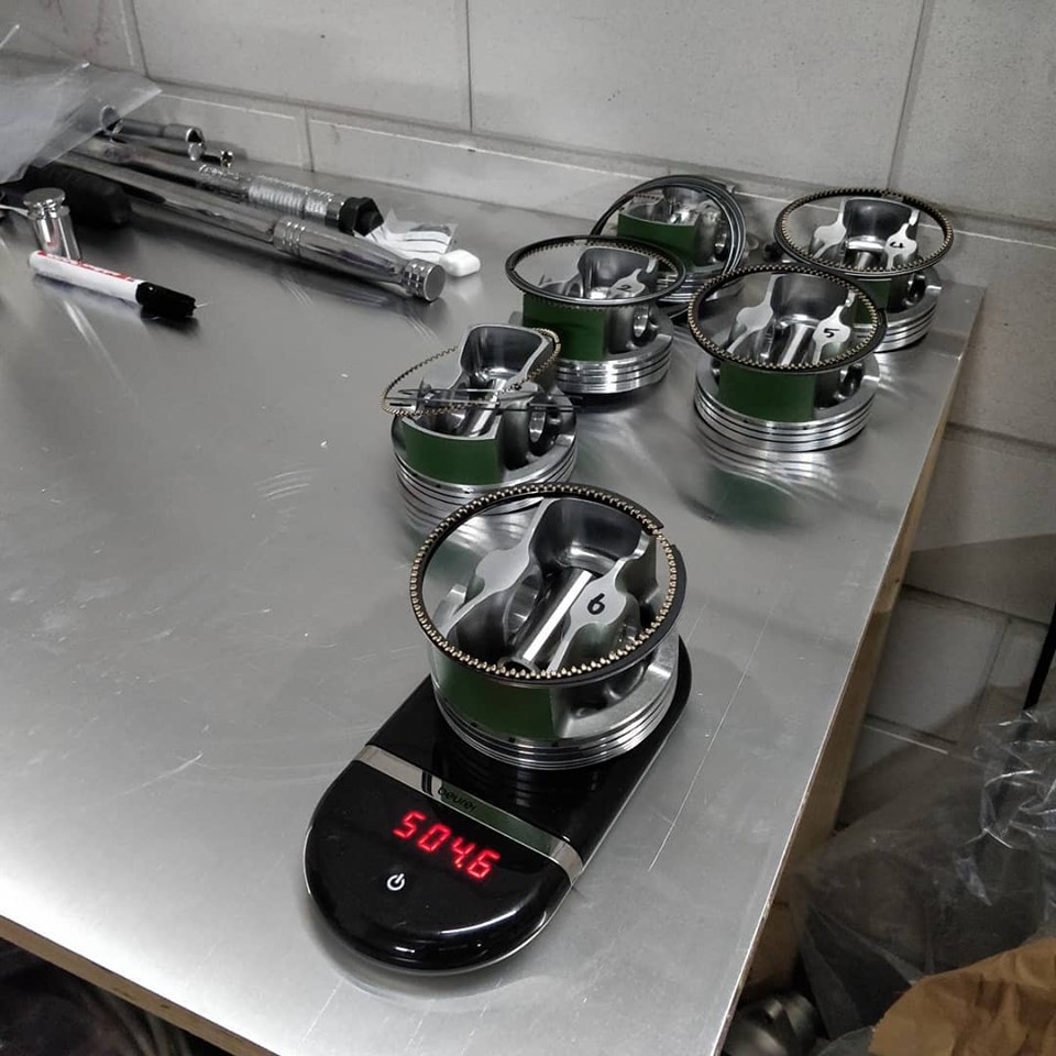

measuring the weight of the pistons

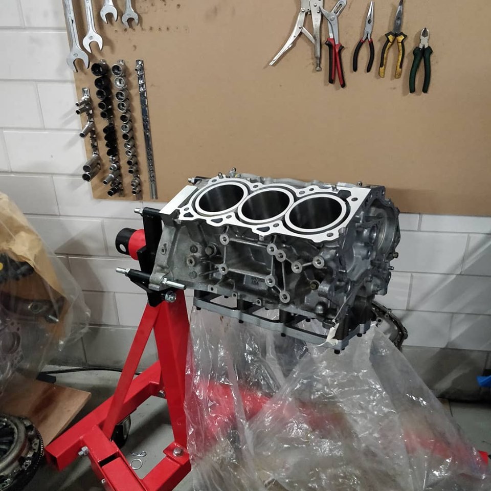

Setting up the block

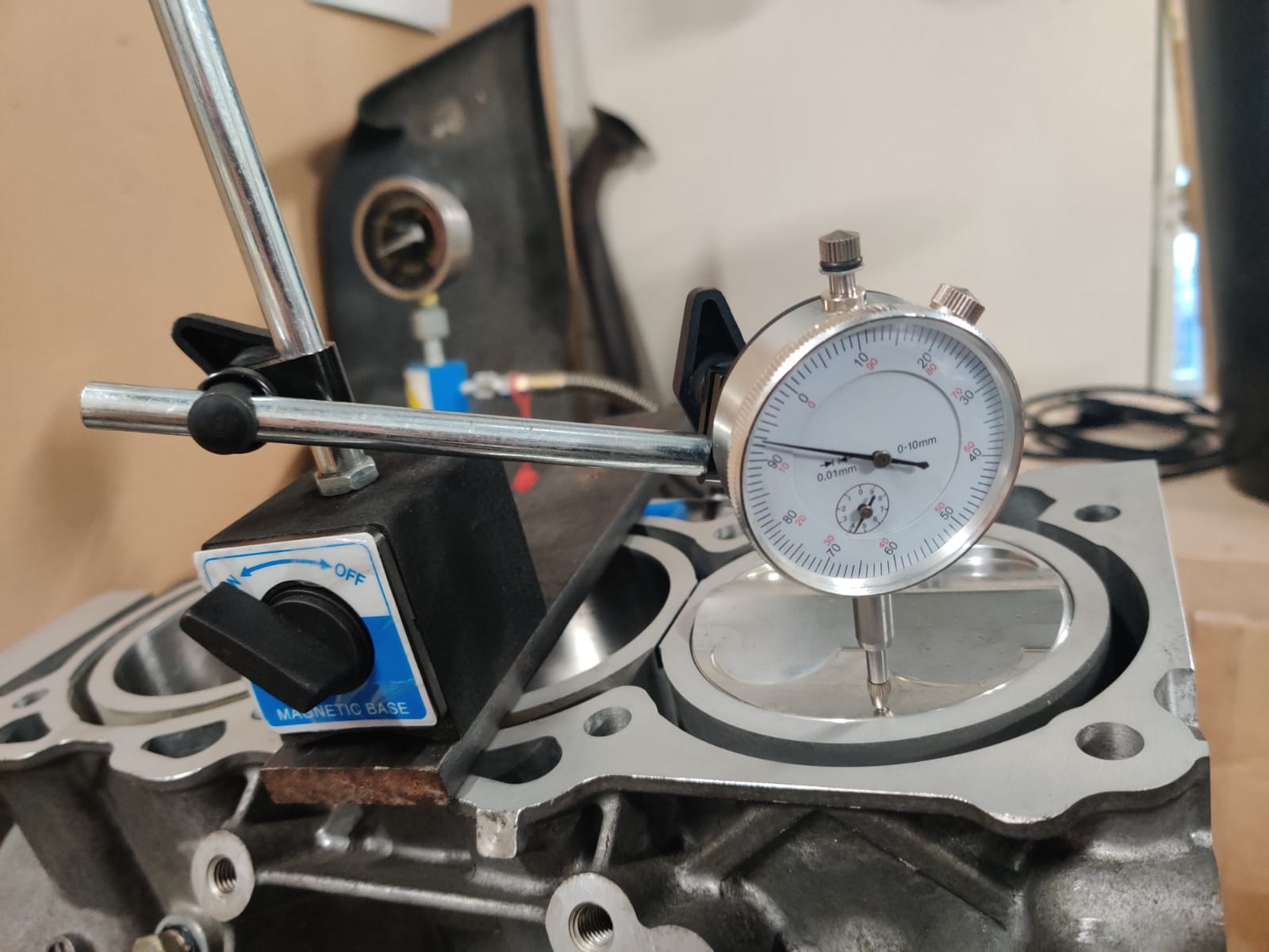

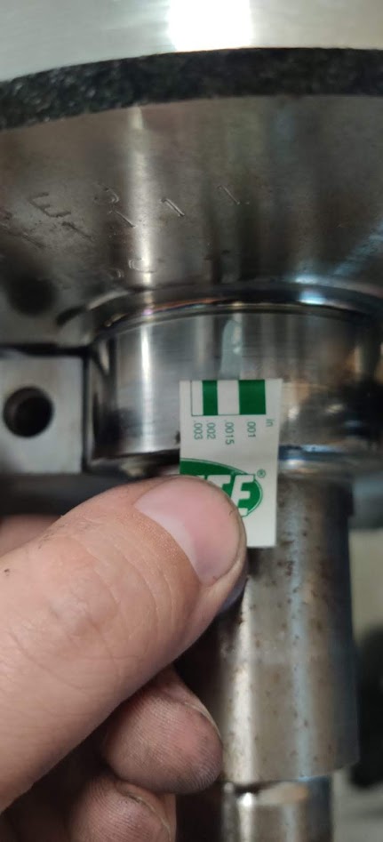

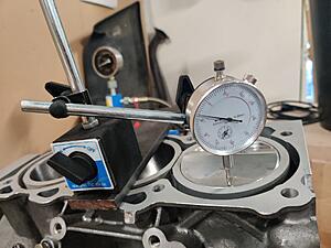

Re-measure all the clearances (had a local shop do this first for ordering the correct parts)

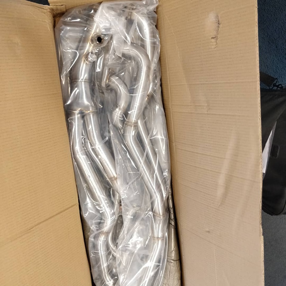

For the exhaust i have bought from Torqen the ISR longtube headers and this will be connected to custom exhaust.

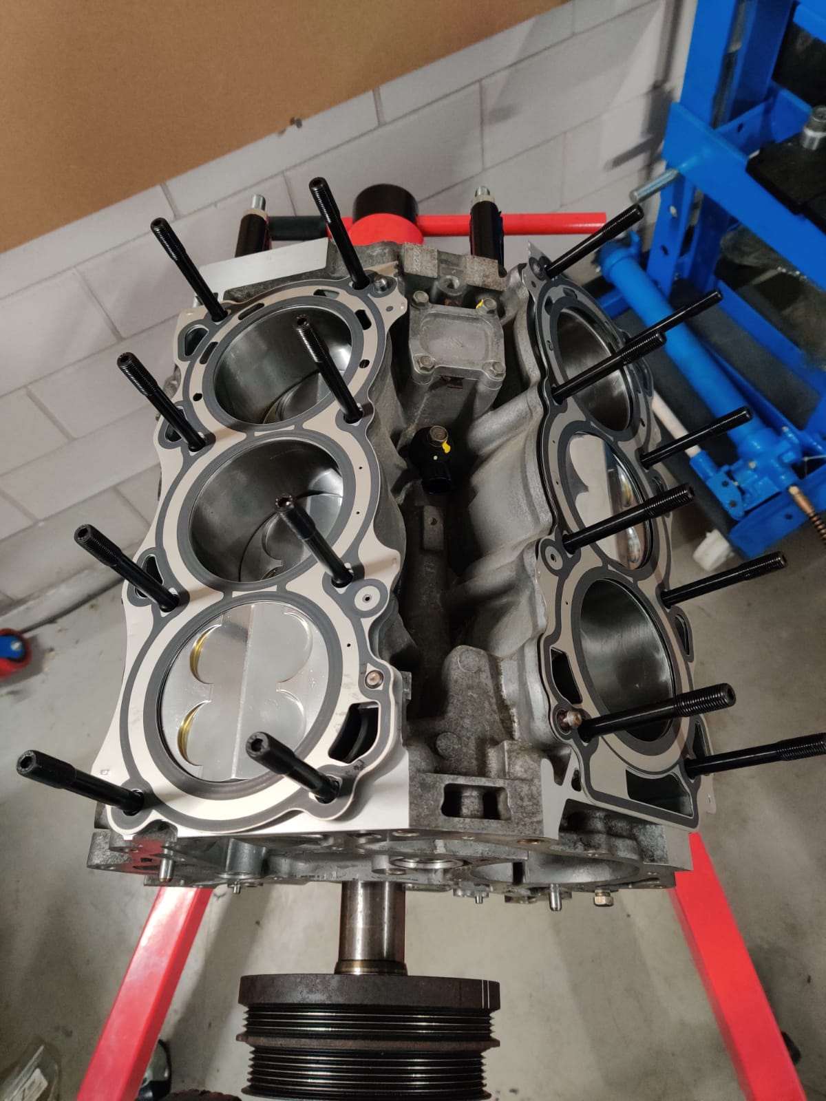

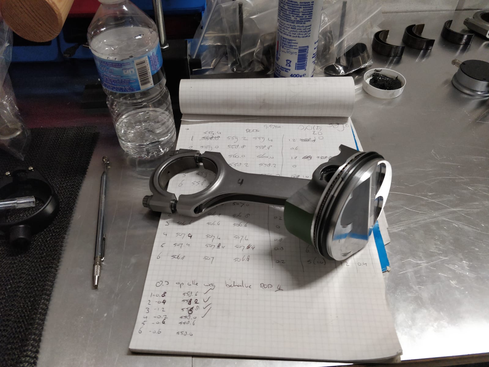

22-10-2019
Balancing of the rods and pistons are done
Gapping the pistons rings are done
Fitting all the rings are done
Then we found out the connecting rods don't fit the pistons... Well that sucks (small end is to wide of the rod)
25-10-2019

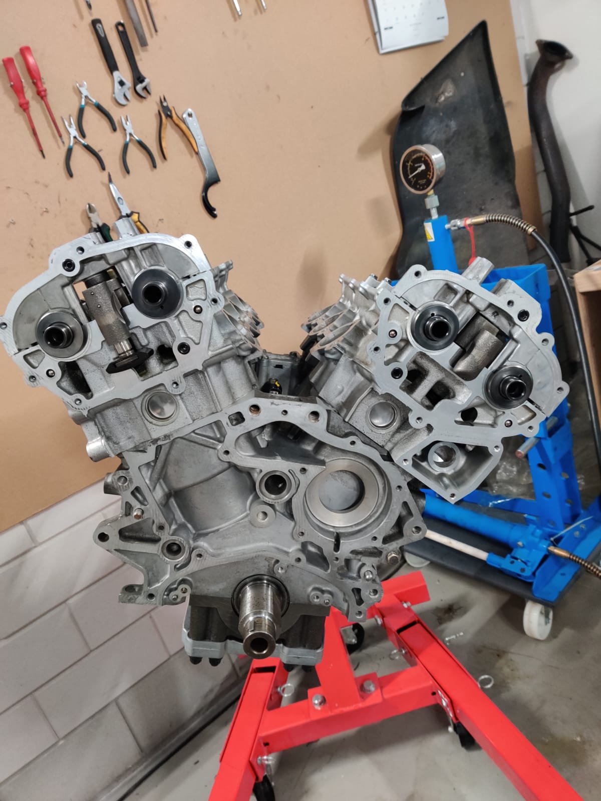

So i changed the Pauter rods for some Eagle rods and can continu to build te engine. 10-12-2019 Big update and parts list

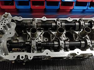

  • Main bearings from ACL
  • Main bearings clearance measured and confirmed
  • Main studs from ARP
  • Thrust washers from ACL
  • Thrust clearance measured and confirmed
  • Eagle Rods
  • Rod bearings from ACL
  • Rod bearing clearance measured and confirmed
  • Rods balanced
  • Cosworth pistons(high compression)
  • Piston to wall clearance measured and confirmed
  • Pistons(en ringpack) balanced
  • Piston rings gaps measured and adjusted where needed
  • Supertech oil seals

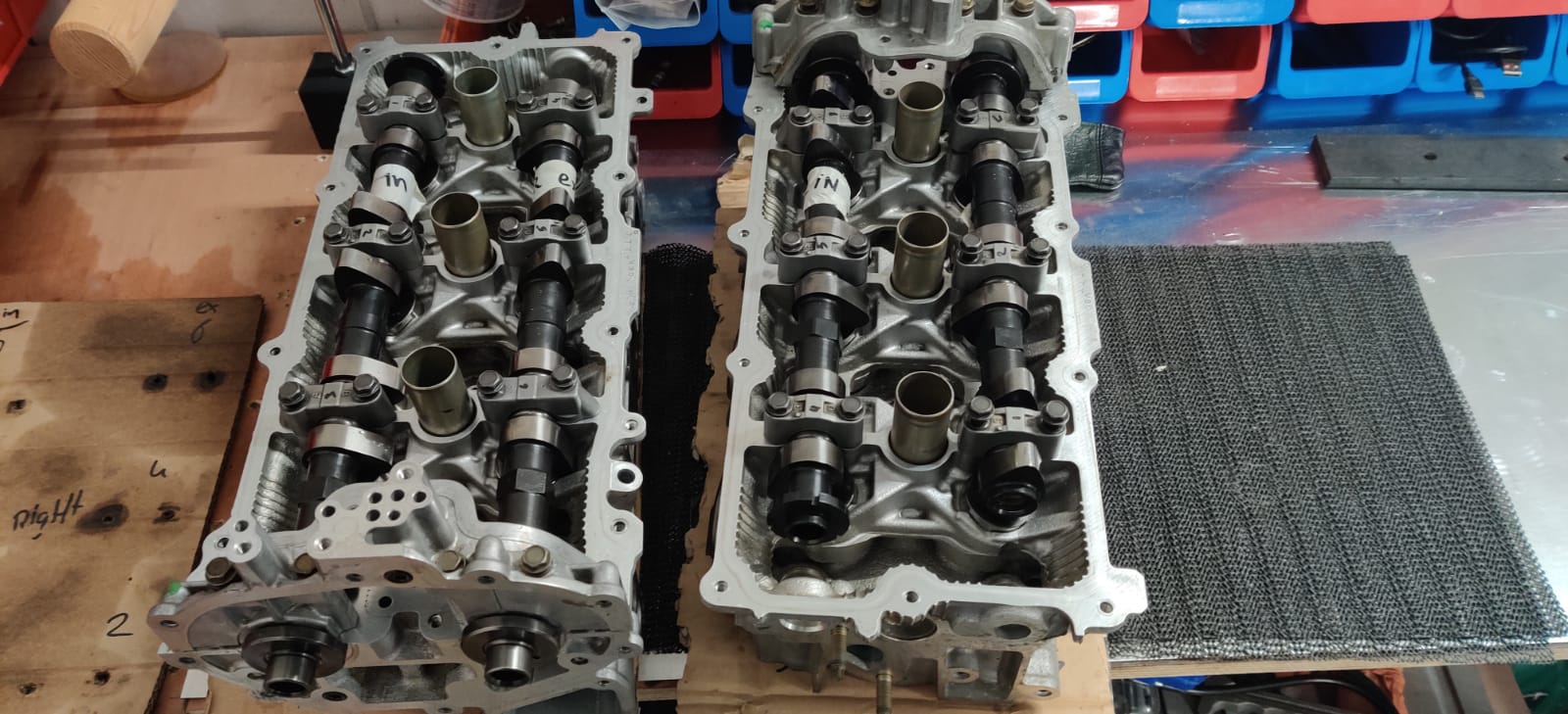

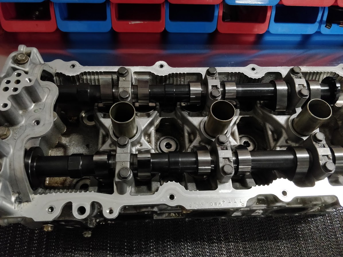

  • Cat cams springs
  • Cat cams lash caps (to raise buckets)

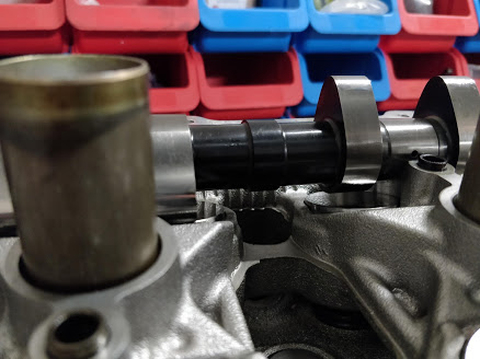

  • Cat cams race cams(intake: 290 duration 12mm lift, exhaust 274 duration 11mm lift)
  • Cam oil clearance adjusted
  • Valve clearance corrected
  • Deck clearance measure
  • Balanced everything including the bank account!
Todo for next time:
  • pre lubricate heads with molly and oil
  • measure piston to valve clearance
  • create self and oil galley gasket
What we learned:
  • Apparently there are letters on the brackets that hold the cams.
Ow an i also bought a roll cage...
11-12-2019

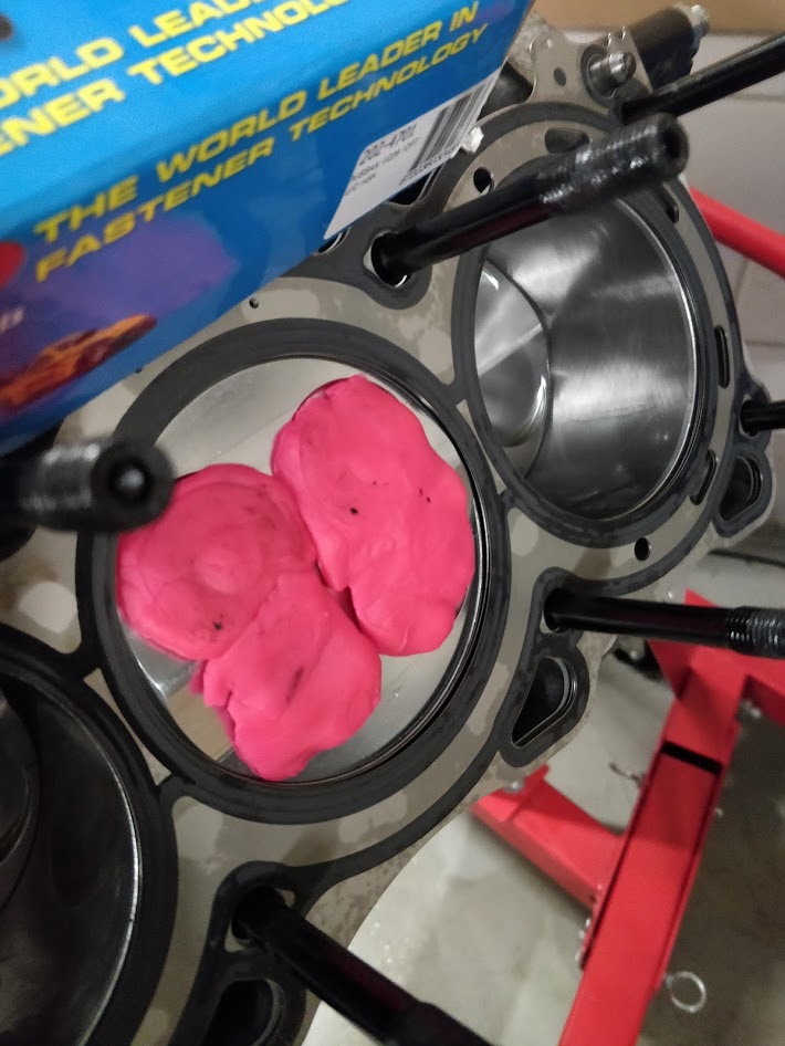

We measured the piston to valve clearance using the clay (play doh) method.
We have around 5.8mm clearance so everything is good
