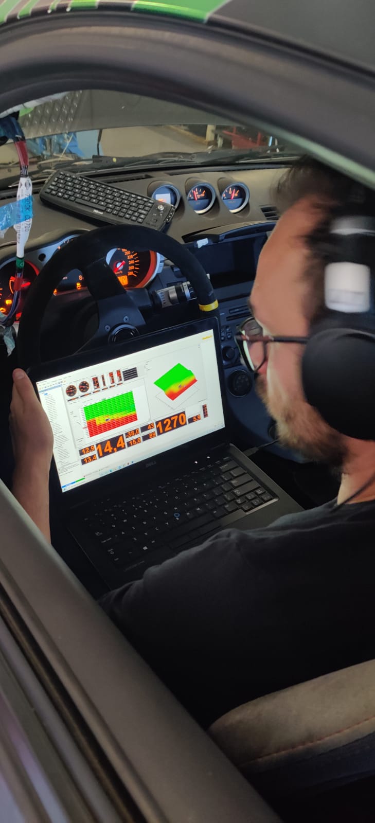

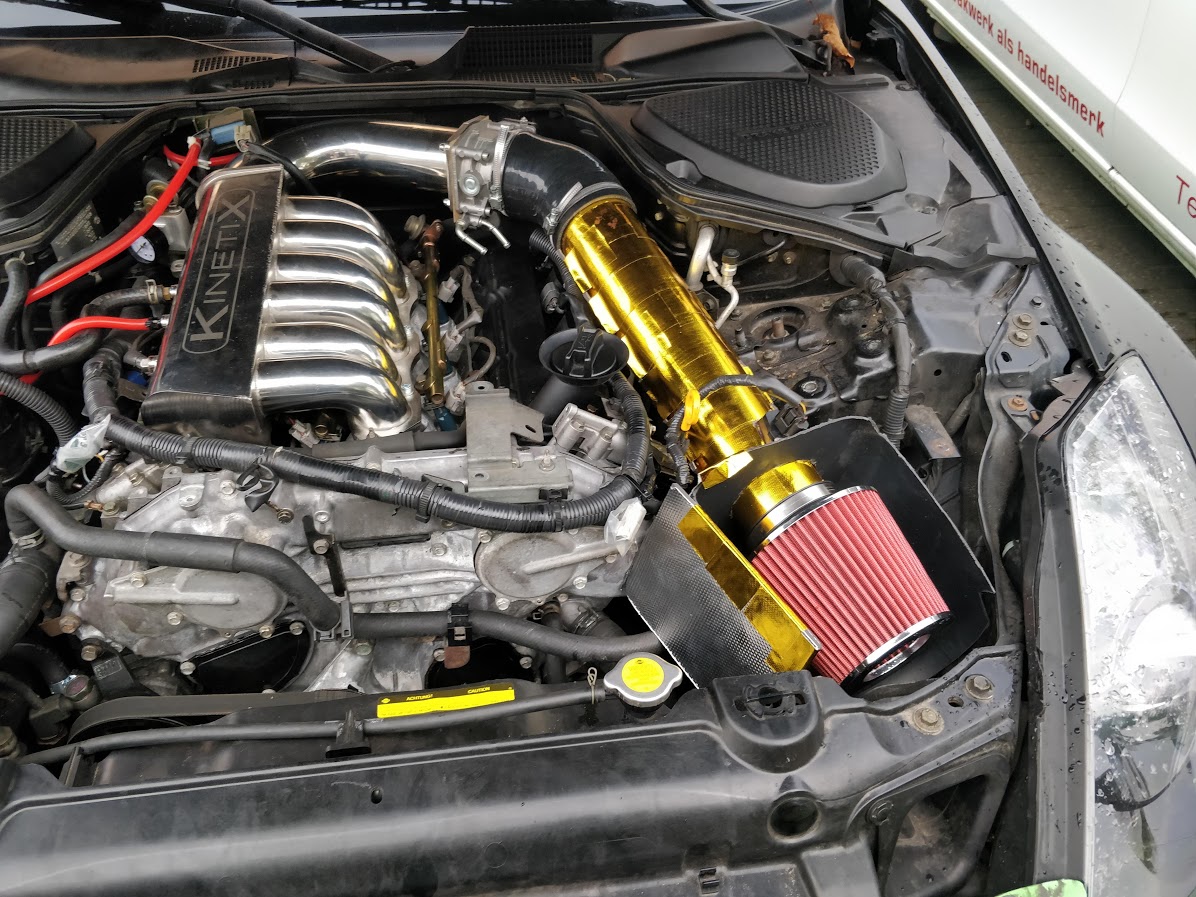

Update time:
Started mapping the new engine and the break in of the engine. Found some small problems like to high air intake temp and oil leakage. But other then that engine seems to behave great.

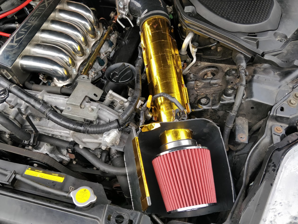

Photo's from the intake:
The intake now is a 3.5 inch steel intake (can't weld aluminium yet) wrapped in heat reflecting tape with underneath a heat shield.
The 'heat shield' near the filter is a bucket from a local construction market.
Still have some issues with heat soak so gonna change the steel pipe for some plastic pipe to see if that makes a big difference. The other solution will might be a ebay electric intake turbo thingy to give enough cold air to the intake (by blowing away the hot air surrounding it)

Yea - gold tape isnt a great insulator ... reflects heat well but it doesnt insulate. I used fiberglass wrap a few years back and it was better than nothing. I would look into fiberglass heat wrap and I would vent the hood. The engine bay gets hot (no kidding?) and you gotta evacuate that heat some how. Hood vents will do this.

I use the silver heat wrap, its about half the price and for what it's doing well worth it.

Yeah im currently looking at hood vents because the problem only occurs when standing still and by opening the hood the problem flew away

May look wonky but if you wanna cheap, you could always settle for hood spacers for the hinges
