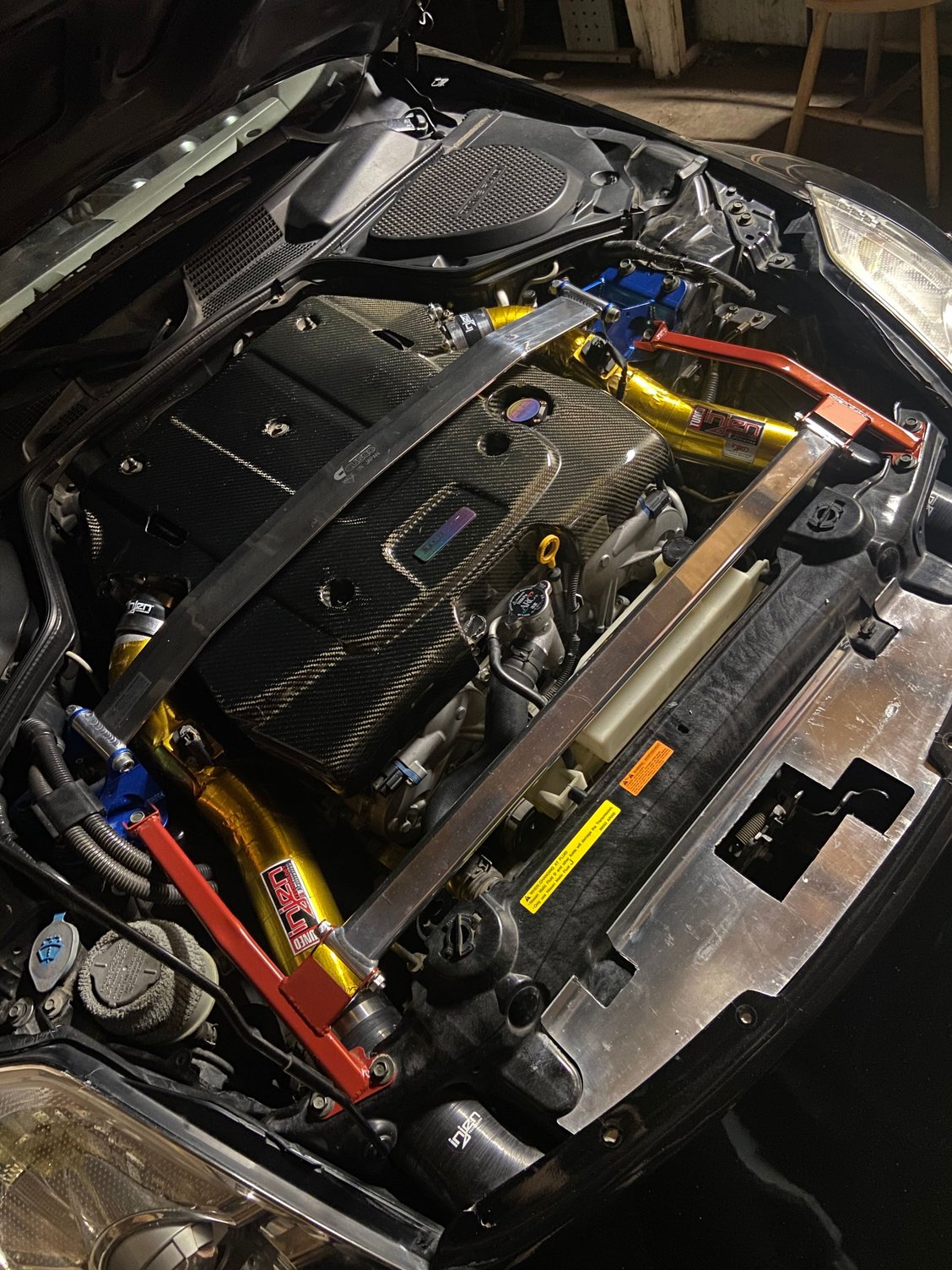

I would suggest the Carbing bar, looks good and has enough clearance to clear a spacer IIRC. Don't know if it works for HRs for sure tho. I understand the need to keep a certain brand but generally I hate catless systems. I was fully ready to buy the ridiculously priced Tomei cats but they were discontinued before I pulled the trigger.
Someone suggested to me about getting a CNC base plate to act as a spacer. This would raise the tower and be a better alternate than washers, however something like that should costs a few hundred. I'm more inclined to keep trying with GT Spec.
Amuse sells HFC at a robbery price of $1,999 USD. Bulletproof contacted me to let me know Amuse sells a titanium test pipe version for $1,500 USD which isn't even resonated. Hence I feel he standard R1000 is the best deal. I do agree, I'm more of a fan of cat system. However, I will say this. Since the install of both R1 exhaust components, the sound has quiet down quite a lot. This makes me believe I can get away with test pipes just fine...

I sure you have to pay someone to scan the tower if you wanted it tight, then again you could just copy the strut bar flange and call it a day. The Tomei cats were $1500 too, yikes.

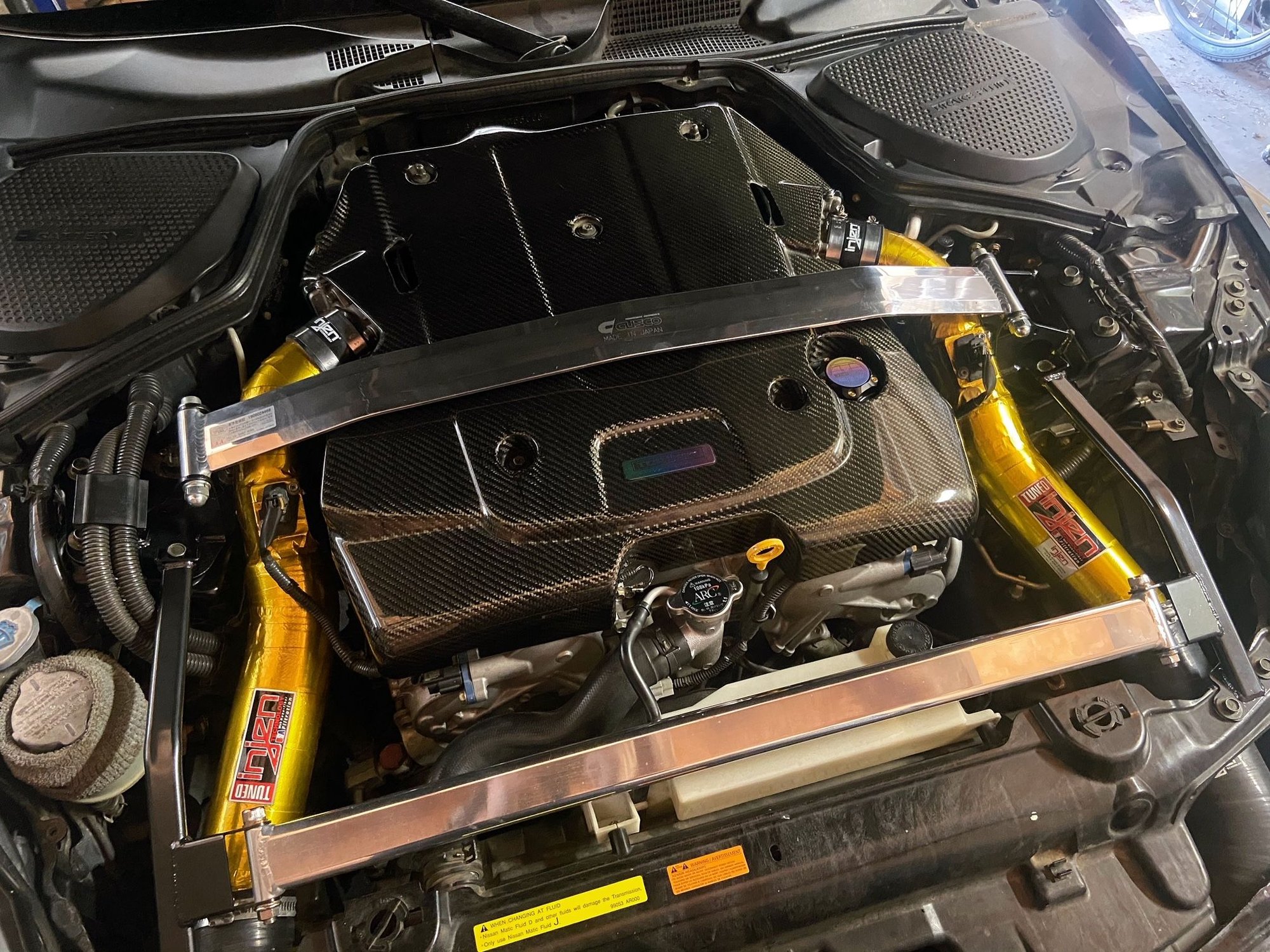

Been a while... not pictured I have bought Berks HFC from CZP. They’re seem to be OK for my taste... may look into something
After installing Toyo R888 305/35/18, I’ve purchased the Z1 Camber/Traction Arms Street Version. Will install perhaps tonight. Along with Bellrace Works diff. brace which I am looking forward to driving!
I am on the fence for a Nismo fin cover... but I really don’t want to drop the diff yet, as I’ll
wait for an opportunity for a 3.9 Diff. So I’ll keep waiting.
Brace installed, super simple. And wiped everything down with Dawn Detergent soap mixed with Water in spray-bottle which does a phenomenal job!
I’m now looking at Stance Aircups full kit to work on my HKS Coilover. Not looking forward to wiring nonsense.

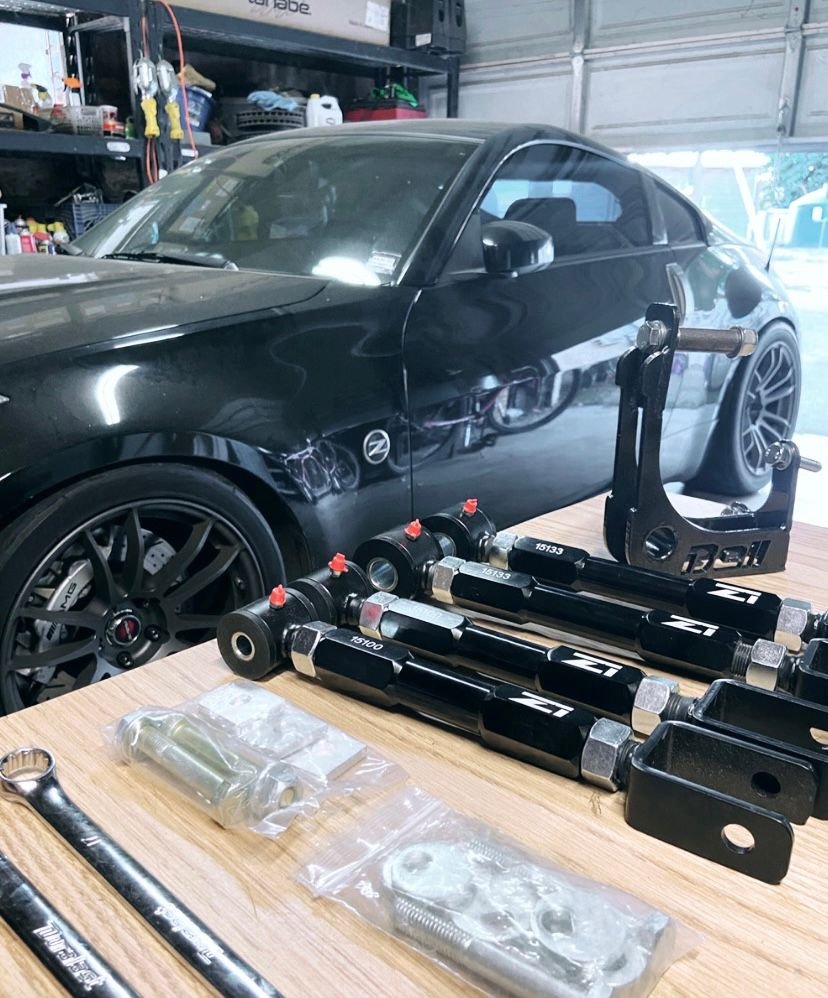

I got around installing the Z1 Motorsport Traction/Camber Arms which IMO enhanced the ride, mainly due to new bushings haha. If anyone got a Nismo diff laying around and wants to let it go for not so much, let me know. I really want to get the SPL Mid-link Arms but no way I can pay $900 for it, I found them for $720 at Bulletproof Automotive. I was hoping for some used ones for sale for like $400-$500. I don't think I really need it though... what I do need is some dry ice cleaning on the undercarriage, looks dirty all the time.

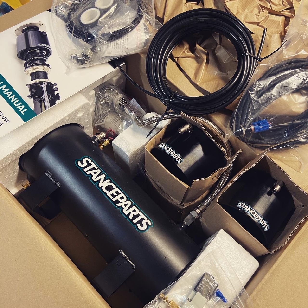

Still waiting on Stance Air-cups but look what finally came in... pretty hard to find but I did end up getting my hands on one now. I need suggestion for the color for the Cusco strut tower end plates and the Cusco H-Brace end plates. I'm not into bright colors, blue and this Lexus orange has to go. I was thinking. . . gun metal or a dark grey.
You can run without the strut tower and run a naked-look like this one. (this was before polish and bolting it in)

If you are keeping the Cusco bar just match it I think.

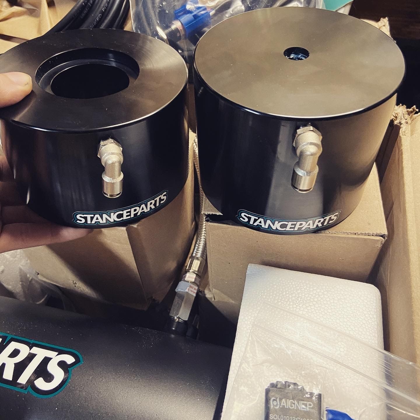

Now since I have OEM-style coilover, I happened to learn Stance offered the divorced air cups which had to be asked as it wasn't public knowledge. They only currently offer this for 350Z and BMWs only. What luck, and Stance told me that if I had a true-style set-up, the air cup could not be used in the rears because it was too large, which now I feel it in my hand, I can believe it. So...you want front lift? Sure! Want full-lift, OEM-style only.
These holes are the diameter of the shaft for my current coilover which ae HKS IV SP. It came out 14mm of the front shaft and I measured the HKS spring perch at 55mm... which Stance told me they only had 50mm sizes which is based off the BC spring perch. So... I need to buy BC spring perch and my springs will work because HKS uses 2.5" springs on all 4 corners with helper springs. (I will buy them, DM me pls)

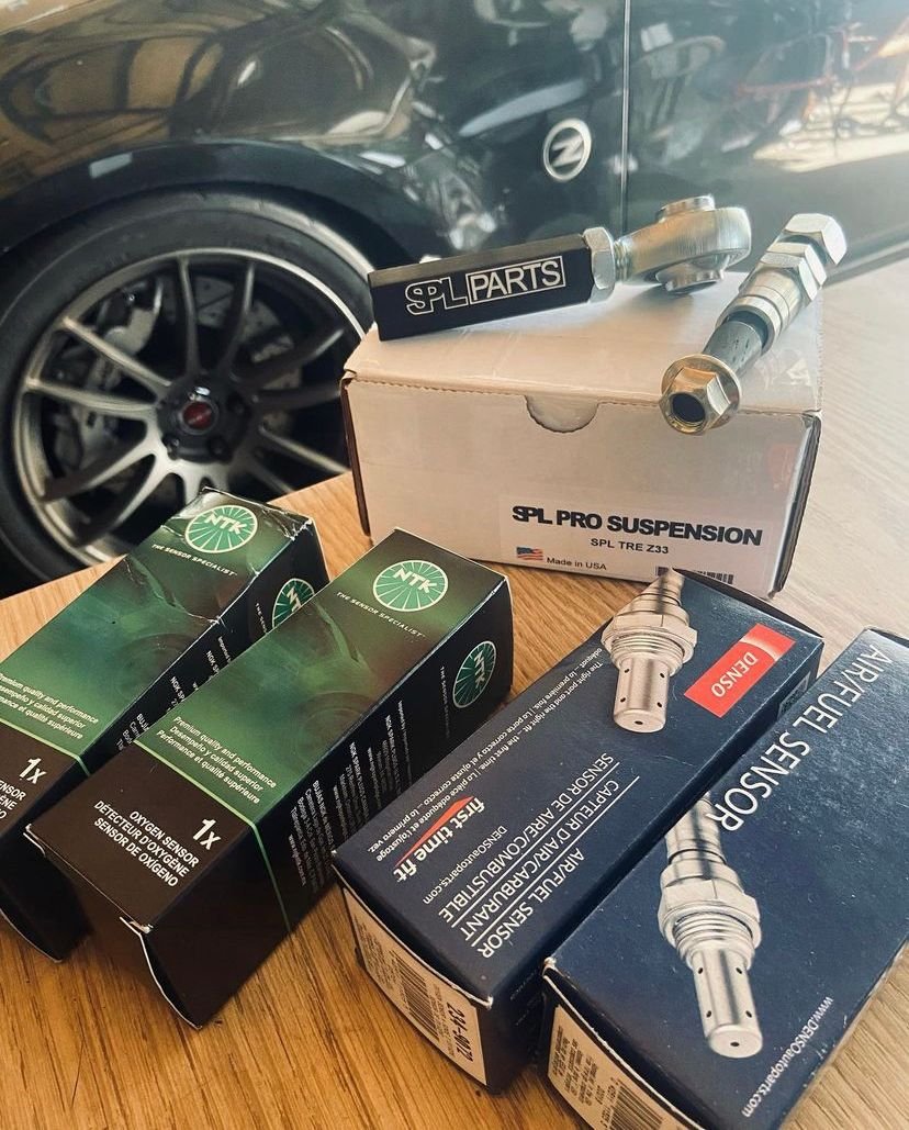

As well as SPL Outer Tie Ends V5 to install. With a pair of Upstream and Downstream sensors from Denso and NTK. I had already installed the new Denso upstream which fixed my CEL. But I have a CEL for another code. . . . It's a Large Leak in EVAP Canister I need to replace my box by the exhaust then. I had trouble installing the SPL outer tie ends actually, because I cannot remove the old OEM outer tie ends out of the arms. . . . . I need help here. Use pickle fork and what heat and WD40?

@Vitamin_B12 I took your advise. I was able to to flip the nut upside down and hammer it away with strong emotion. The nut on the driver side got mangled so I had to cut it out with an angle grinder. But now look, new shiny parts!
Looking forward to the SPL Outer Tie rods doing work, along I installed brand new Nissan wheel hubs also on both side to which I took that chance to clean up the spindle arm on both sides as well. Using brake cleaner and an electric wire wheel, it looks like a new replacement part. The hardest part is actually removing the brake caliper and installing them... you have to be very patient and snake in the nut/washer on the inside between the caliper and rotors. Surprisingly, the rotors still got life in them, no lift. The AMG Brembo OEM brake pads still have a ton of life in them. This is to my guess that larger pads surfaces area means less work to stop the car therefore increasing longevity.

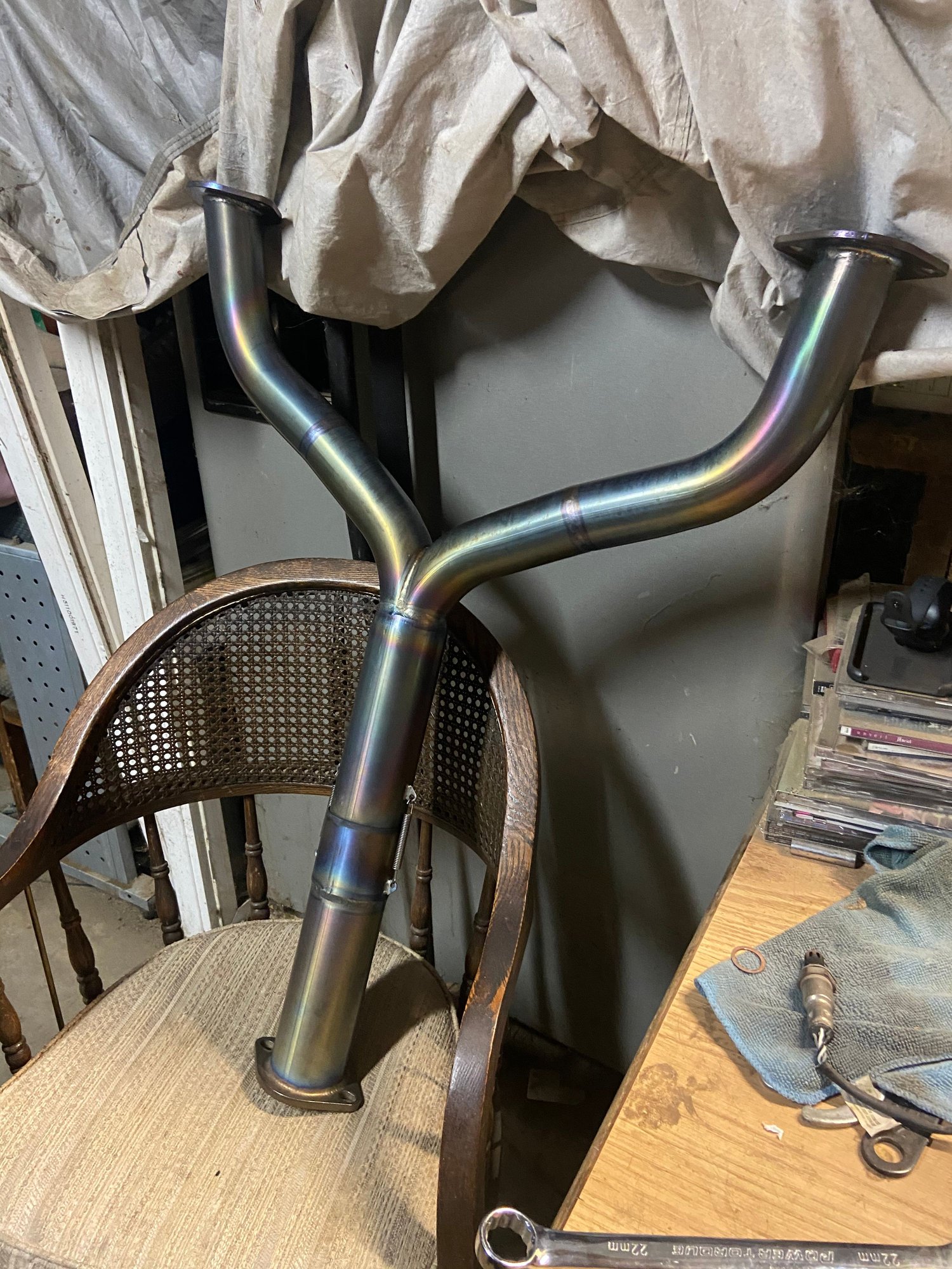

The Amuse R1 Titan exhaust is good. The issue is the Amuse R1 Titan y-pipe has these springs that holds the 2-piece together and I think it's worn out. I will try to replace them with new springs. Although I've seen some people from Japan weld them together.
This is the Amuse R1 Titan y-pipe in question. It's a little embarrassing for a $1,500 - $2,000 USD y-pipe to be rattling, yes the price is insane.
