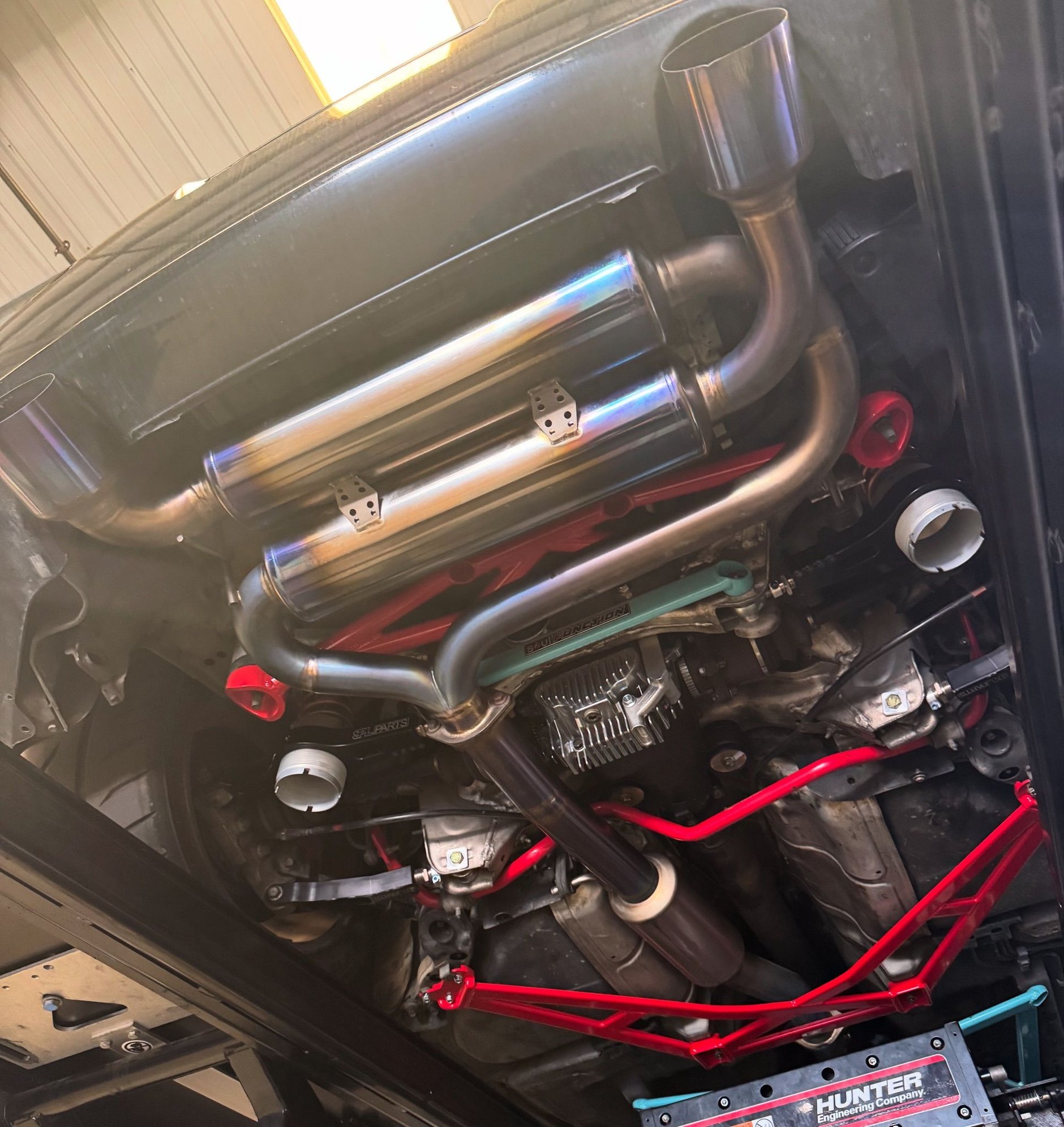

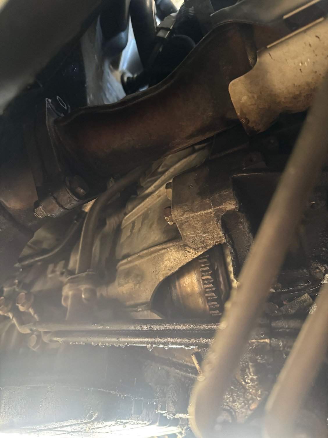

The diff itself I noticed was spewing out gear oil on my exhaust setup which I'm not happy with. So I looked around and bought this little guy for a cool twenty dollars to store overall oil in this catch can.
I think I may have possibly overfilled it because I don't think I drove it too hard to get it up to them and overflow out of the breather too much.
Here it is installed... looks decent.... til the next day I learn it didn't work. The catch can didn't get any oil and the hose near the exhaust ruptured. I think either the heat from the exhaust allowed it to expand or it was too weak and the pressure blew it open. So, for the time being, it just has a longer vent hose to allow the overflow, overflow out far from my exhaust setup. I don't think I can repair the finish on the titanium with oil burned onto it though.
I was thinking about this cooling kit if the diff isn't actually overfill. I'm going to do a diff oil change in about 900 miles.

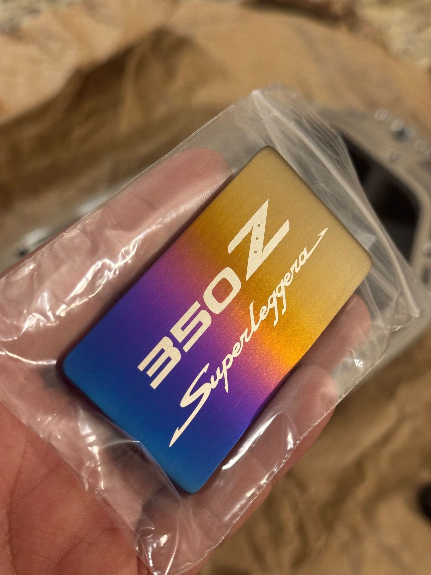

My Superleggera Titanium plaque came in. Looks good. Just keep it safe til the body kit gets here.
I think it'll look great in the cabin. Maybe too flashy to be honest.
Maybe'll I'll look into a raw finish instead, or a black finish. Maybe it can go in the engine bay?? Perhaps the carbon fiber cover?
