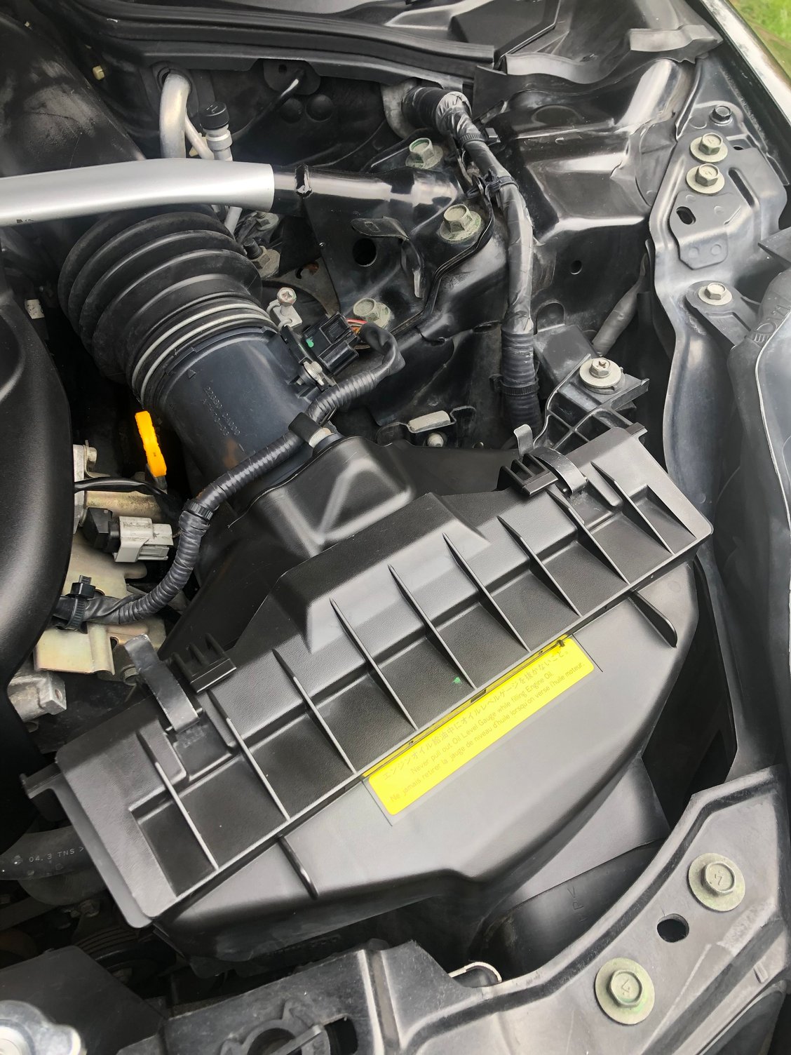

It’s the box on the driver side of your engine bay next to the manifold it has 2 clips on it to open up
This is it

"Cabin" air filter

Originally Posted by Longryder
While your at it check the cabin air filter it’s probably shot or real dirty from filtering the exhaust
This is it
Oh god damn.....please dont reproduce
