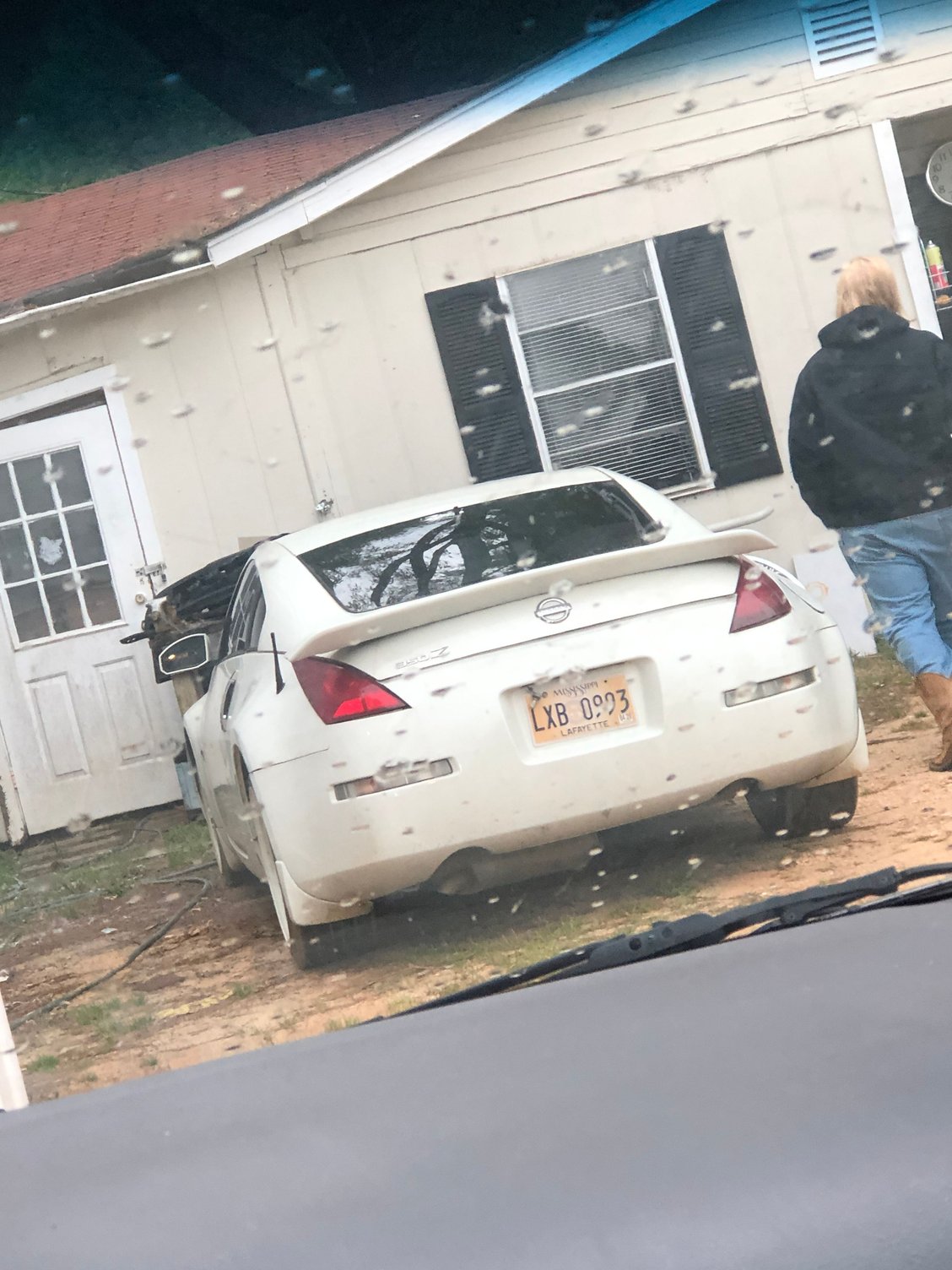

So I’m new to driving and cars in general. I recently bought a 350z for 3 grand. The guy didn’t speak good English and it seemed like a pretty good deal. Except later after we checked it out I realized that it was actually a rebuilt car and the back end was pretty beat up under the “screwed on back number”. I found the car on Vinreport.io and it was apparently rear ended pretty bad and the person who “rebuilt it” did a pretty bad job of fixing the back end. I would like to get it fixed, if not fully replaced. Any advice on how to do that and or how much it would cost to get the back end replaced? Thanks
Post on facebook market place, new fenders, bumper, lights
Picture of the damaged is sustained in the accident. And what they apparently “rebuilt”. When I look at now it looks like they lazily just pulled out the back end and it’s all broken back there and nothing fits flush in the back end

Good luck.....the rear quarters are not replaceable so if they are poorly repaired you may not get em any better without spending a ton of money, bumpers are reasonable and easy to replace, that tail is horrid.

Muffler is some random part thrown on there

I mean you can replace them, but are not bolt on....you have to cut them out and weld em back in.
Is the rear bash bar intact? I honestly would pull bumper off to see what is left unfixed under it

Hatch looks a bit skewed also...

Looking at the damaged photo, if they didn't properly fix it the way travlee said, you're looking at getting a new rear end

Can't you get get legal involved? It's a wrongful sale. Anyway, you can drill out the spot welds and remove the quarter. And welds the new one on. But, it may be too much work.

Damn, that sucks. From what I see, it's probably not worth repairing. There are plenty of people selling shells cheap after a part-out. It's a ton of work, but you could end up with a (relatively) straight one from two.

I don't see how it can not have frame damage. If it were mine I'd do this in reverse. Take it in for an alignment or a shop that does frame work, see if it is/can be put in spec. If yes then great, evaluate how to proceed with cosmetics and enjoy life.
If no, it'll never drive correctly, may put you at risk and will eat tires. Function > form always. Good luck.
