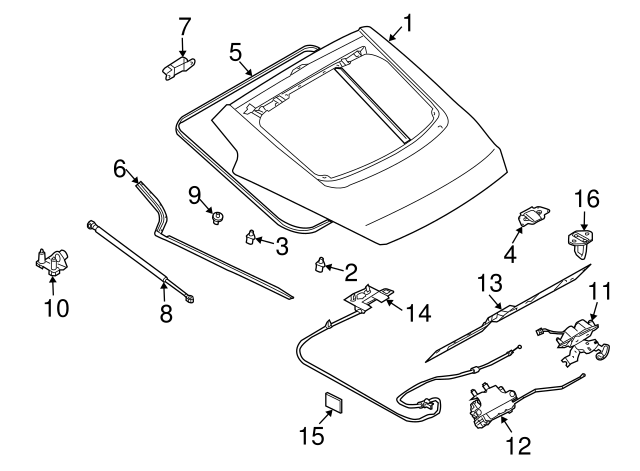

i corrected the courtesy part link, look at the last picture. it hard to tell.
With recent developments thanks to your diagram it looks like I'm looking for hatch moulding clips/pins. Now it's just a matter of finding the right ones
