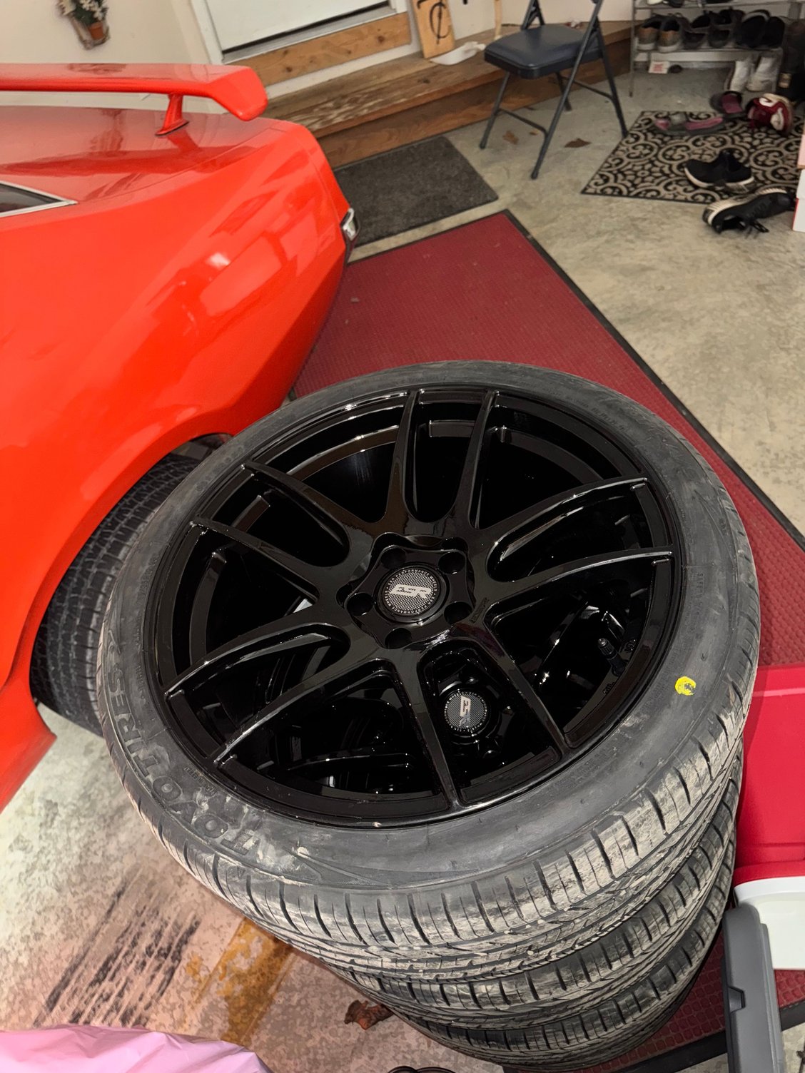

Wheels I have for it.

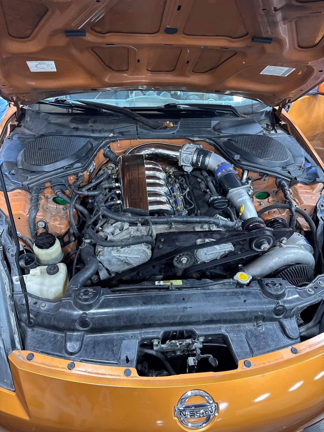

Engine bay, also have headers, cat back exhaust with titanium tips, and more.

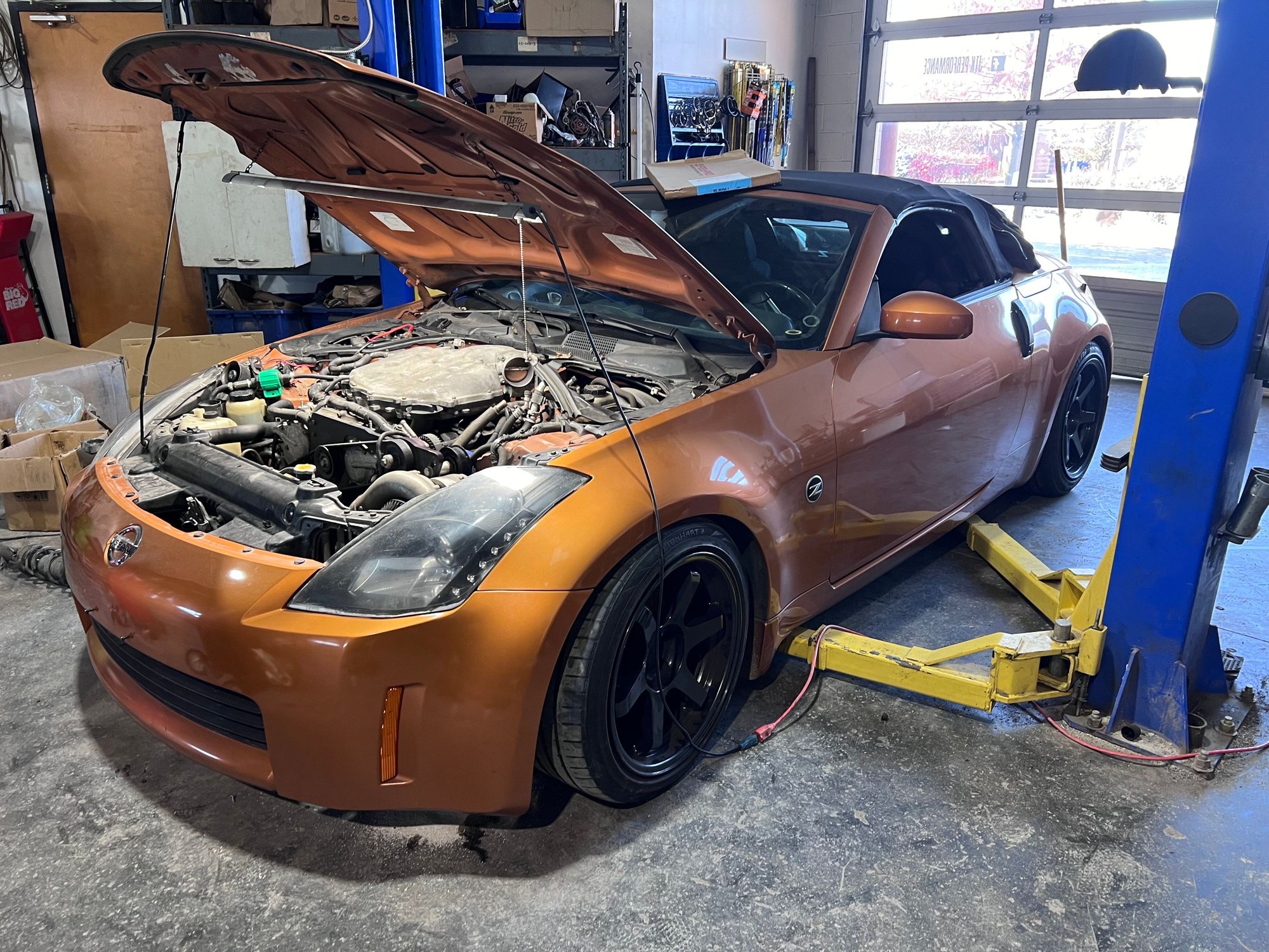

Side shot of the car. Plan to paint and change color!

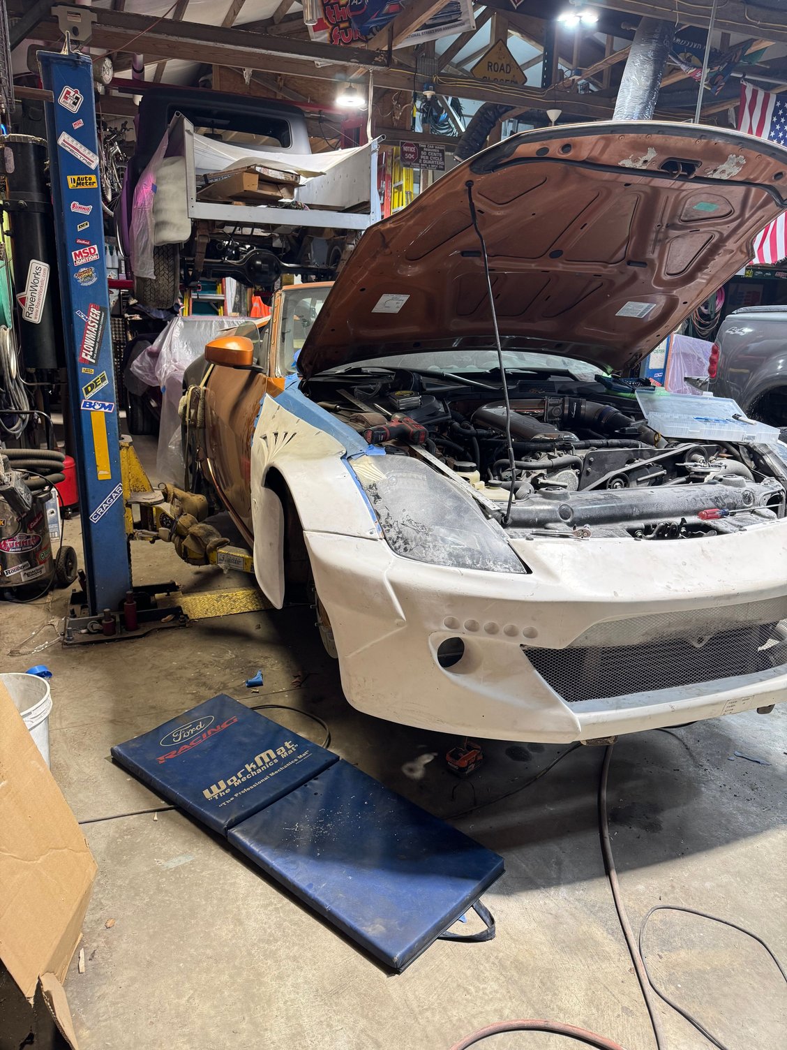

It's more of a knock off Rocket Bunny. Fenders, Grill, Quarter Panel Flares. They just don't line up right with torquing or bending the fender or bumper more than I should or fabbing it to make it make sense. The body lines just don't seem to line up right and Fitment is rough.
Here's the farthest we've gotten. It looks good from afar but the body lines just won't line up.

I'm guessing that's an issue with the fact it's a replica knock off kit. I bet there would be poor fitment on a coupe as well. Unfortunately, if you want good fitment, you've got to go authentic, but that's $$$
