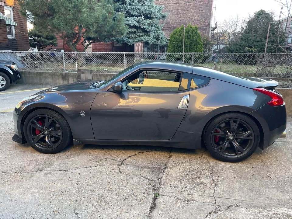

If or when I get a title, I will be looking for a set of either of these in black, or will get them powder coated. Are the top and bottom picture 350 or 370 wheels?

Never mind, they are both 370 wheels.

Yep, both 370Z wheels depending on trim level. Btw, that top pictured black 350Z (1st pic) is running the TwinZ Design duckbill spoiler along with the other TwinZ body kit goodies (diffuser, rear spats, side skirts and front lip). To my knowledge, Z1 Motorsports is the only business with distribution rights for TwinZ products in the USA. They are very well crafted pieces and it shows in the prices. The shipping costs are high and often outweigh the value of the individual part.

That's right. The middle picture shows the OEM 370Z 19" "Sport" wheels manufactured by Rays and found on MY '09-'12. Stock specs are 19x9 +47 in the front and 19x10 +30 in the rear.
The top and bottom pictures show the OEM 10 spoke wheels that were found on later years and other trims like the touring and base. I think they are 18x8 +43 in the front and 18x9 +15 in the rear.
The high offset in the front is the reason why you need to run spacers on a Z33 for proper fitment unless you're able to source a square setup with all rear wheels.
