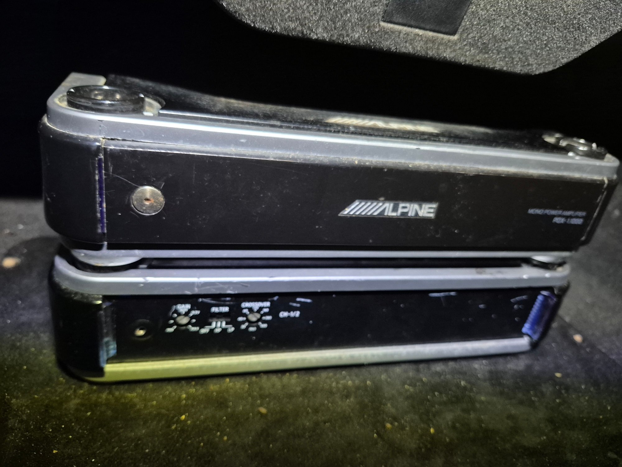

Yes, there is a sub box behind the drivers seat and an amp mounted on top of the access panel to the fuel pump, of course. I am taking out the pass seat this weekend for more access. Good idea to disconnect the radio stuff.

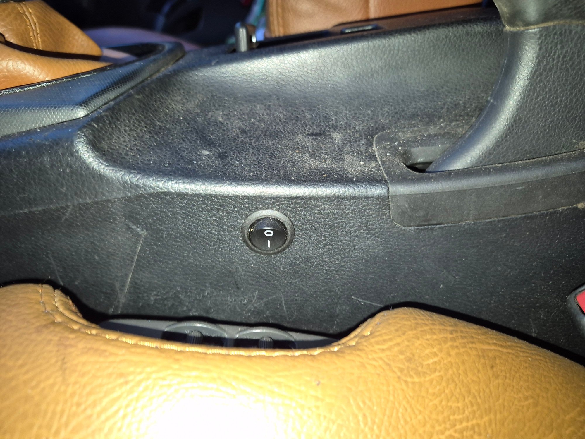

There is a switch on the side of the center console, I assume this is not OEM. Photo below.

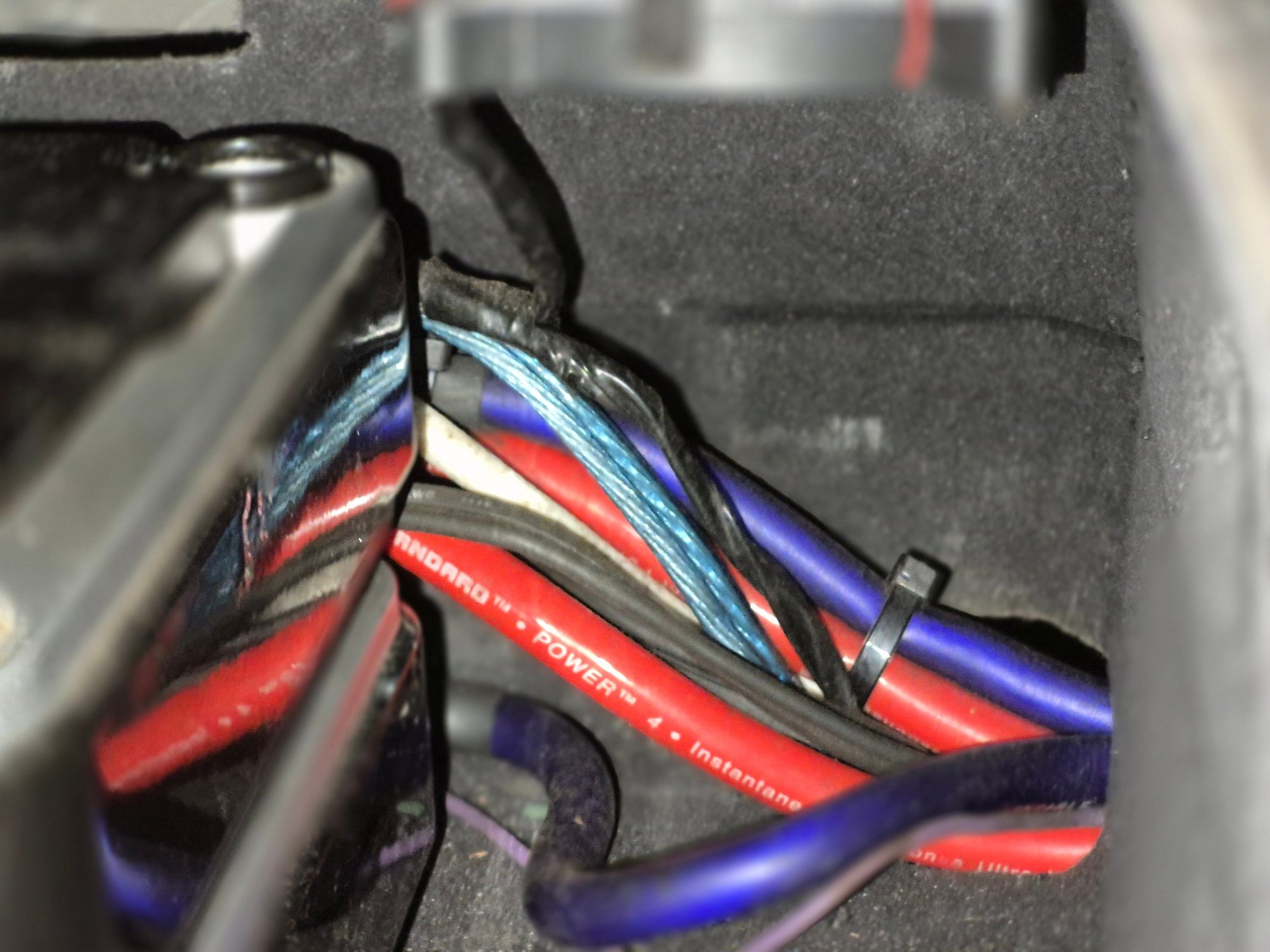

And I have a side shot of the amp and all the wiring.

The switch on the side of the center console could be for aftermarket heated seats, but it could be for anything really, you would need to trace out the wiring to truly figure it out. Edit: I just realized there are aftermarket fog lights behind the front grill. Perhaps this switch controls those. TBH, if those lights are not wired with a proper relay, I would remove that setup as it could be a fire risk.

The Amp arrangement is interesting. Looks like there's two Amps stacked together, I'm guessing one to drive the Sub and the other for the door and rear deck speakers. What brand Amps are those? They may actually be worth keeping.

Here are the amps attached to the fuel pump cover. I took out the pass seat for extra working room. I guess there is a lot to take out to get to the screws of the amps.

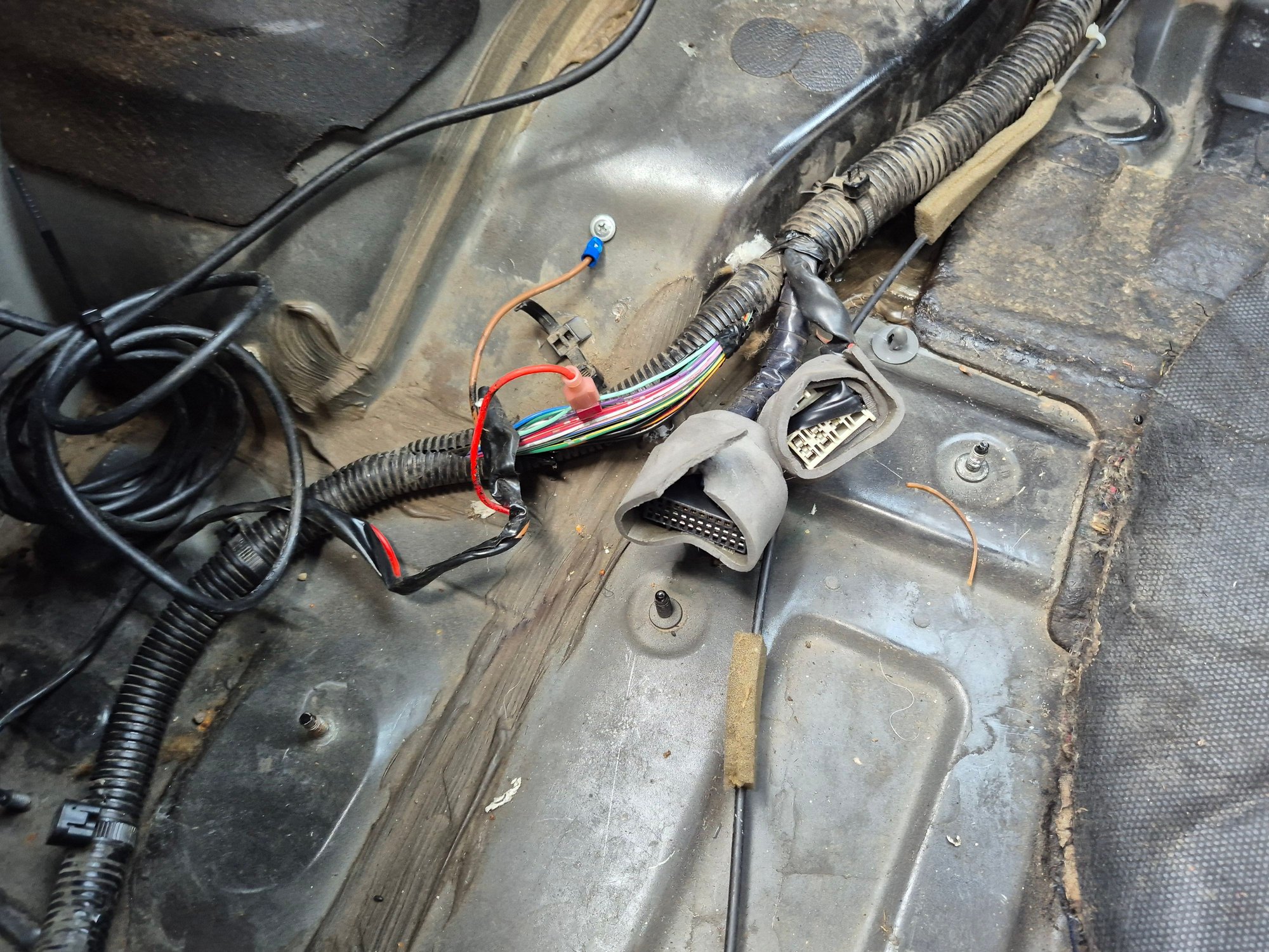

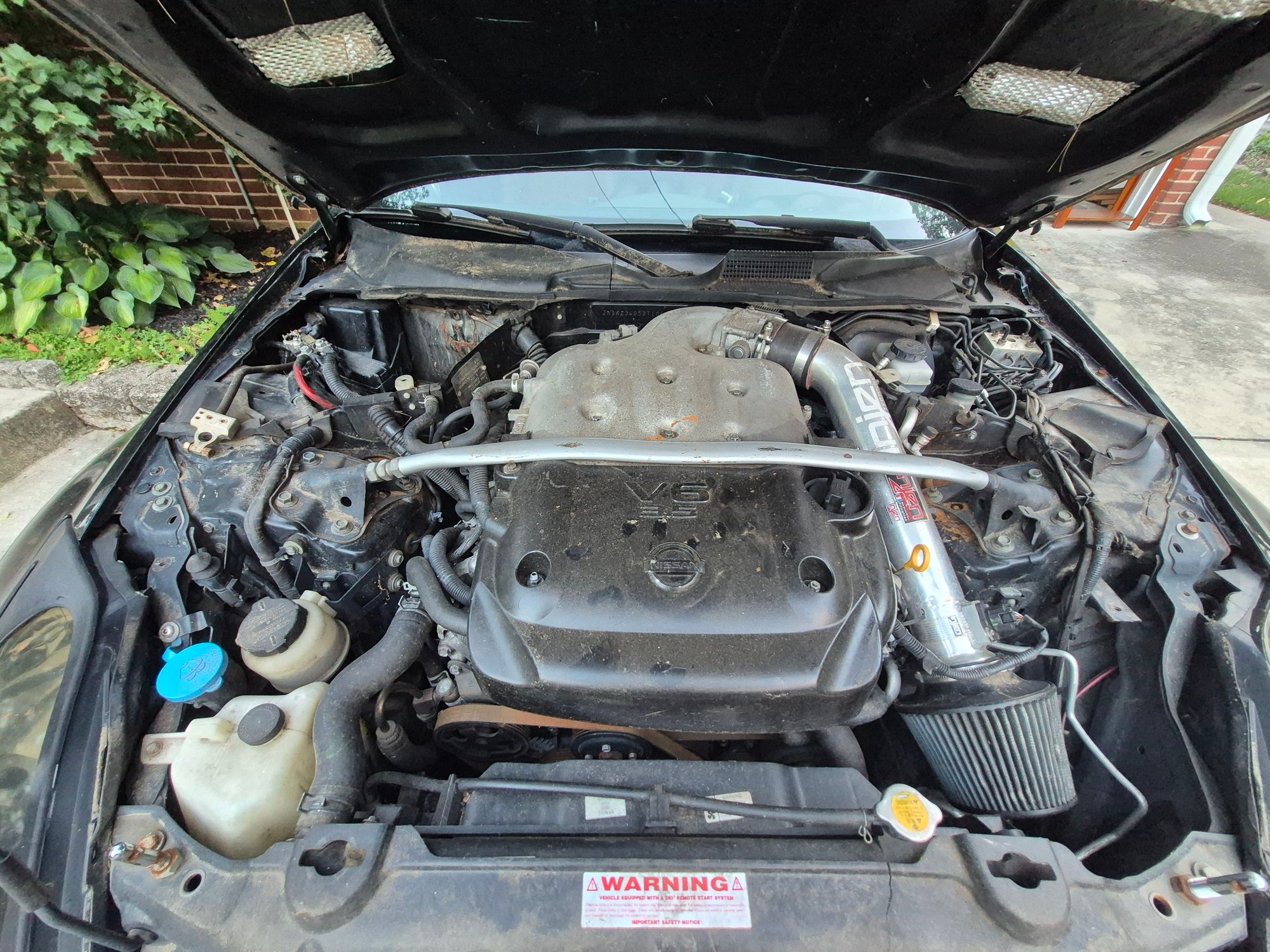

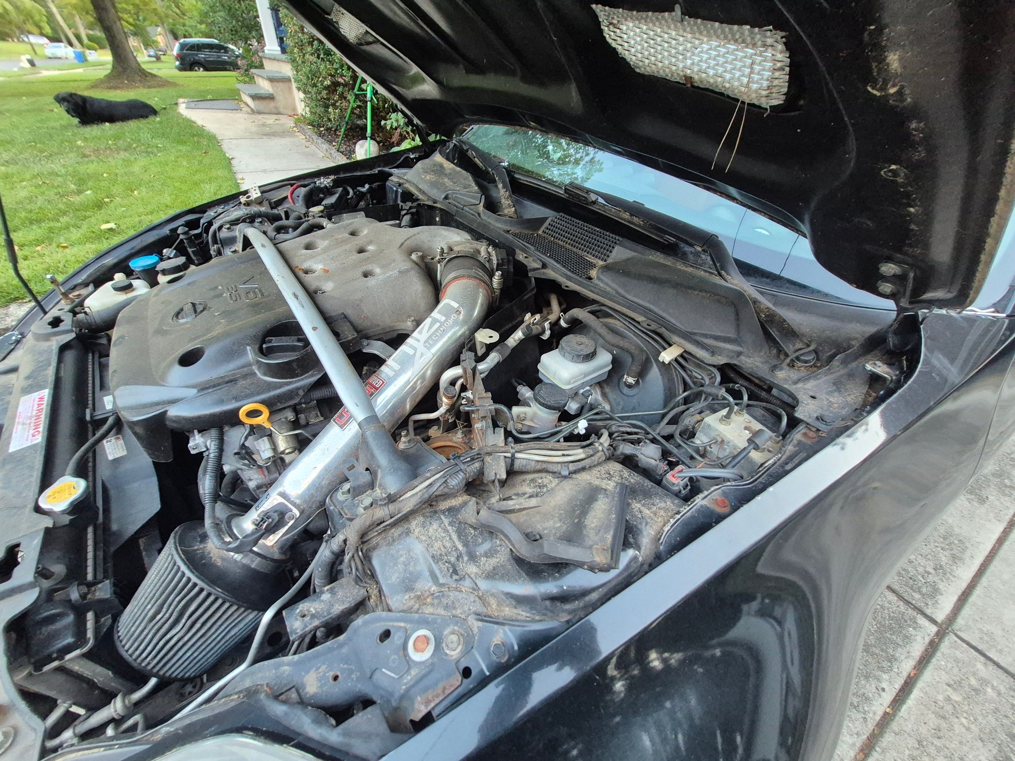

I have removed all the trim from the seats back, ripped out the old stereo equipment since it was bolted in and could not access the fuel pump door. So, fuel pump is replaced and it is running after sitting for 2 to 3 years.
I have already swapped out the aftermarket hood for a OEM hood. I have removed the aftermarket front bumper and side skirts and have a hand shake agreement for a swap for OEM as well.

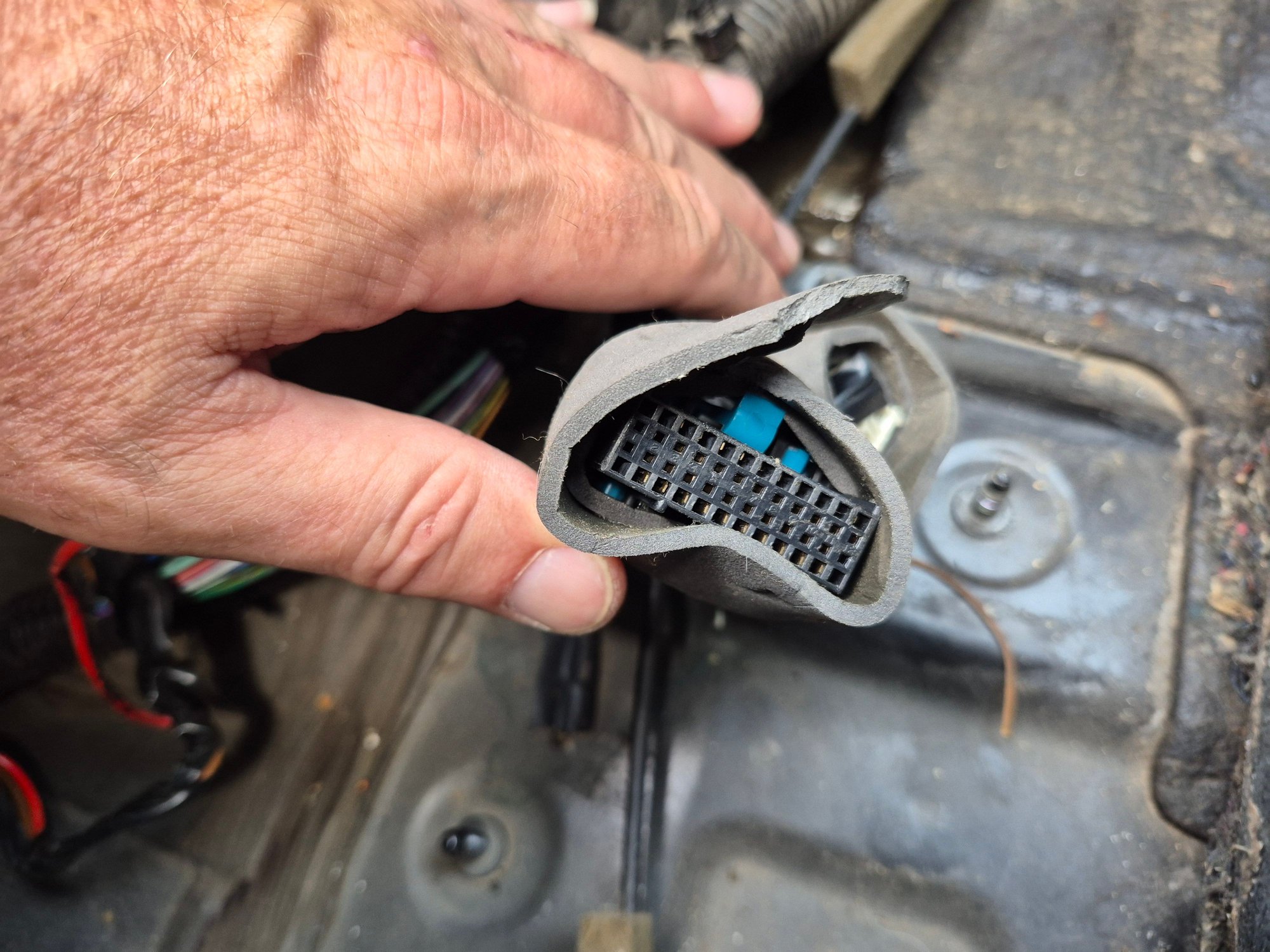

I have removed the flashing LED aftermarket lights controller but there are two OEM plugs not connected in the rear hatch area. Can you tell me what there are? I have attached pictures.

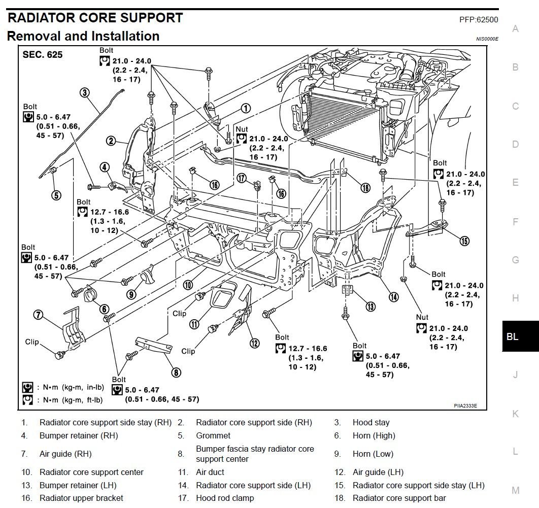

I have also attached pictures of the front of the car. Can you tell me if anything is missing, supports, etc... Disregard the LED lights, they will be removed as well.
What is the controller box pictured, there is one on each side?
This is a whole new adventure for me, I attached a picture of my 9 year project.
Thanks again.
DM3
Old Sep 3, 2025 | 12:54 PM
icer5160's Avatar
icer5160
Joined: May 2010
Posts: 2,048
Likes: 609
From: Brentwood, CA
Hey DM3,
Good progress so far. The trunk harness connections are from the factory Bose audio system. You can safely leave those alone, most people remove the Bose system as they are not economical to maintain once components start failing.
The modules under the front headlights behind the bumper are HID Ballasts. These look like cheap aftermarket ones. In short, they are required for upgrading from Halogen Bulbs to Xenon. You can get mixed results when doing this if the headlamp housing isn't designed for HIDs. In short, you should use Xenon bulbs in headlamps equipped with projector lenses and not use them in headlamps with reflector bowls. Personally, I would upgrade to the 06+ OEM headlights which already run D2S HID bulbs, no need for an aftermarket kit and the headlights look much better (expensive). BUT, you would need to modify the factory wiring harness to support the newer redesigned headlights. The easiest option is to revert to stock, if the existing headlights are damaged in any way, then I would replace the set. DEPO makes decent aftermarket replicas, but the OEM units are the best quality. You can usually find used pre-2006 OEM headlights for cheap.
There are some forum posts covering what is required to do the wiring mod to get 06+ headlights working on 03-05s, with some research I'm sure you will figure it out.
As for the front bumper. Based on the photos it looks like all the electrical wiring/components are present, however there are some body panels and at least one bracket missing.
The passenger side wheel splash shield is damaged and a chunk appears to be missing/cut.
The under tray that ties into the front bumper lower lip is missing a huge piece (I recommend an upgraded Aluminum tray over the OEM plastic one).
There should be a foam impact absorber that slots into the aluminum box crash bar, not sure if you removed this prior to photos or it was simply missing. (#4 in bumper diagram below)
There should be a small bracket attached to the upper radiator core support on the driver's side. (#8 in core support diagram below)
There should be an intake duct that slots into the radiator core support in front of the engine air filter. (#11 in core support diagram below)
There should be some plastic air dam pieces that clip to core support and hook around the crash bar. (#7 & 12 in core support diagram below)
I already mentioned the missing radiator locks in previous post. (#16 in core support diagram below)
Study the diagrams, perhaps I'm missing a few details. Looks like there's be some missing bolts for #18 in the core support diagram, could be more missing that I'm not seeing.
Good Luck!
-Icer
350Z Bumper exploded view (Note: From 2006 FSM)
350Z Core Support exploded view (Note: From 2006 FSM)

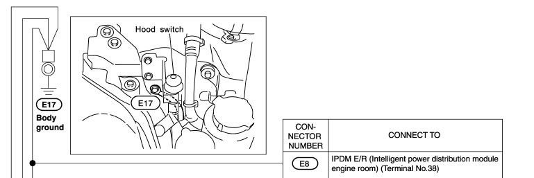

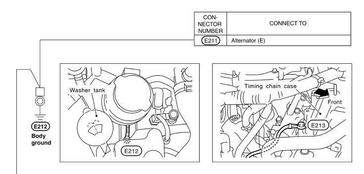

Good news: the front bumper and side skirts are gone and now have stock ones. Front bumper needs a little work but is 100 times better.

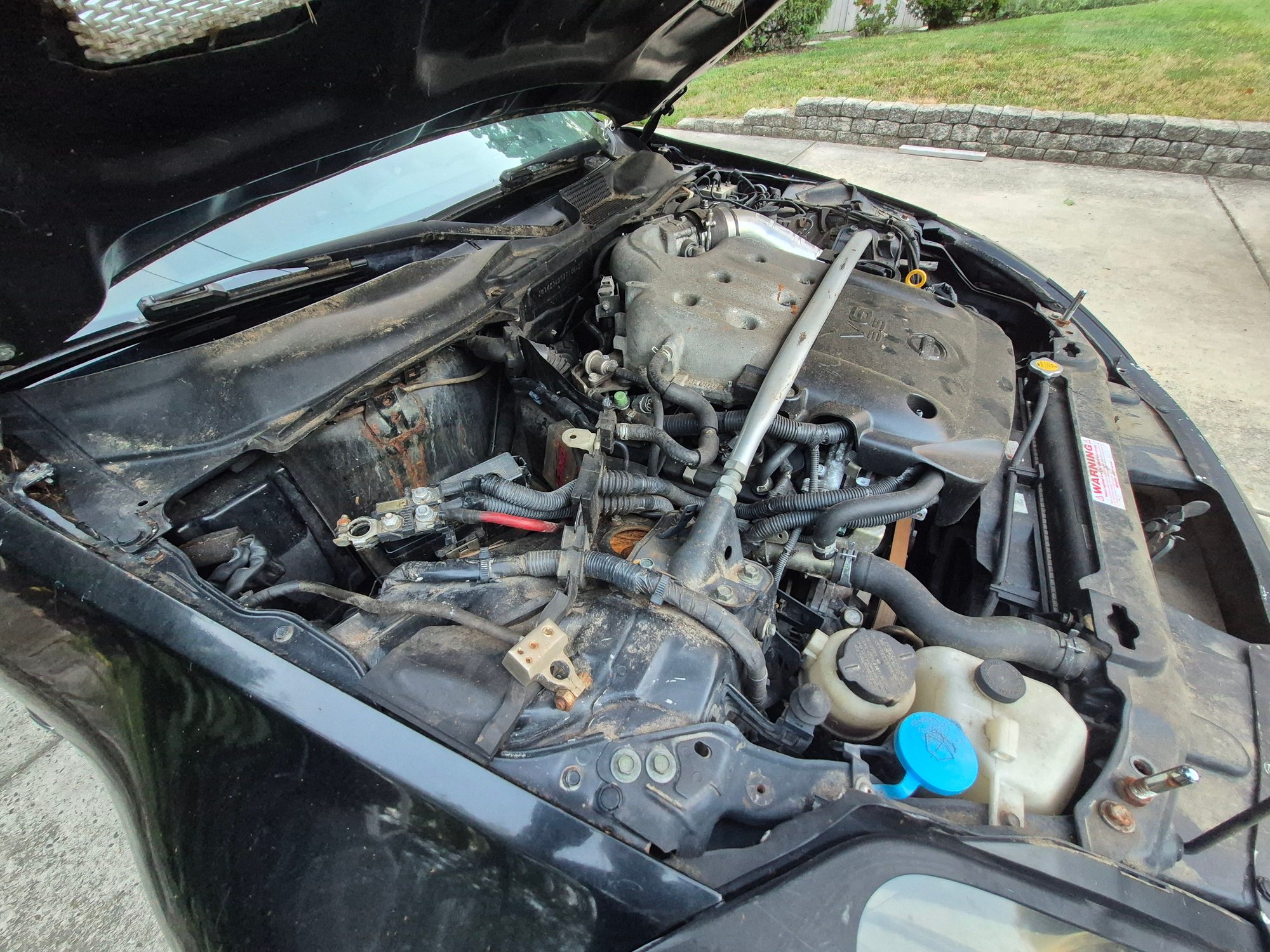

Bad news: Since the car had not run in 3 to 4 years, after I replaced the fuel pump, it started. So I let it idle to get all the fluids flowing and seals wet again. Oil looks good but will replace this weekend anyway. It started three separate times. The third time it was running nicely, sounded good and then it just turned off. All the dash lights were still on. I figured it ran out of gas, so I put in another 5 gallons of 94. Then the battery was low so I charged that, went out and all the dash lights come on, fuel pump kicks on for a second, but it will not turn over. I will check the fuses over the weekend, run a scan as well. Any other options to check that you can think of? Starter?
Thanks
Old Sep 9, 2025 | 04:34 PM
icer5160's Avatar
icer5160
Joined: May 2010
Posts: 2,048
Likes: 609
From: Brentwood, CA
Hi Dm3,
Check the body grounds around the engine bay for signs of corrosion. Most are located on the passenger side.
1) Battery main ground terminal is connected at the frame rail under the PS reservoir and coolant overflow reservoir (passenger side).
2) Another major ground is in the same area, front half of strut/wheel house (passenger side).
3) Check engine main ground, again passenger side, near the hard coolant pipe on top of the bank 1 cylinder head, near cam cover.
4) Last major engine bay ground is on the driver's side, just behind the headlight.
I would also check your clutch pedal switch. If the switch is not being depressed with the clutch pedal in, then the engine won't turn over (common safety mechanism). There are rubber bump stops that tend to disintegrate at this age, leaving an open hole in the pedal arm, so the switch remains open. Basically the car won't let you crank it over without this switch being closed, you won't get any codes for this issue. Check around the carpet for broken bits of rubber/plastic, they might still be there if this is the cause. Otherwise look for the switch on the clutch pedal and match it up with the bump stop when depressed. If the Z has cruise control, there will be two switches, the cruise switch is depressed with the clutch pedal released. The ignition switch is depressed when the clutch pedal is pushed down.
Here are some photos of the engine bay ground locations. I've never seen the fabled "hood switch" on 350Zs before, so ignore that in the diagram (may not be a US market thing, not sure).
EDIT: After reviewing your photos, your Z has a hood switch. Maybe they removed these in 06+ models?
