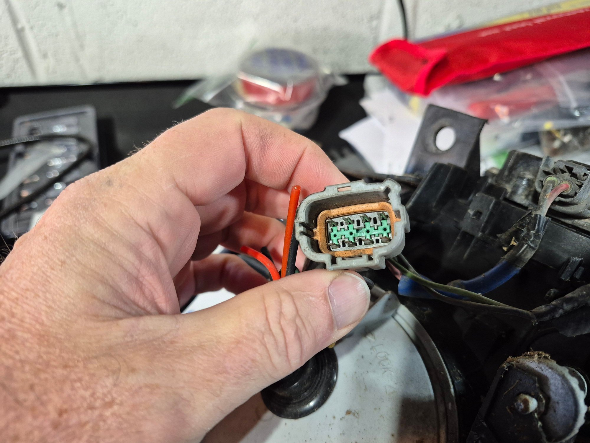

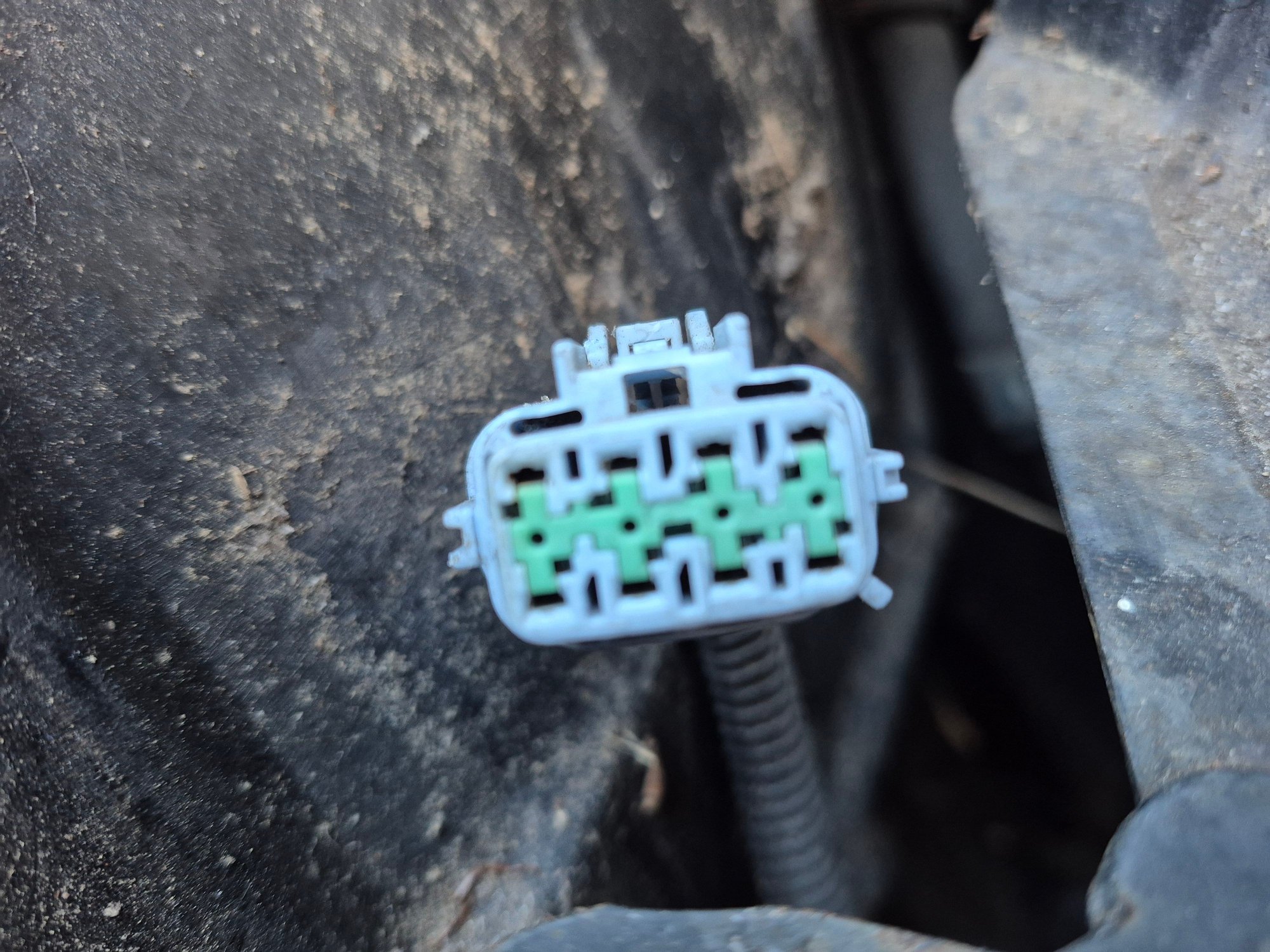

GM,
The headlights in this car were butchered like the rest of the electrical wiring. When I pulled out the headlights, the plugs are 8 pin. I have been looking at replacing with stock headlights, and they seem to be 6 pin.
Any ideas? As a reminder 2003 touring model
Question: Can I use OEM 6 pin headlights and just buy the wire the converts from 8 pin to 6 pin?
Thanks
