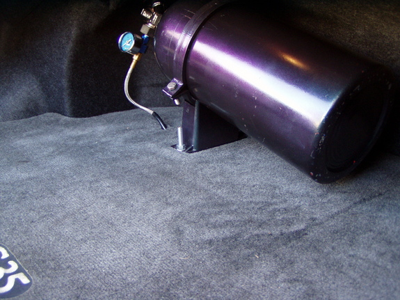

Very nice, what did you bolt too? How deep?

I made an "L" bracket to fit under the carpet and drilled 4 holes in it 2 on the side that attached to the car and 2 on the top holding down the bottle.

Awesome! Thanks for the good idea!

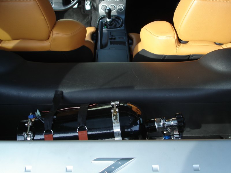

here is my temp. spot, i will be moving it soon because of the way the tube sits in the bottle, it is best to have the valve aimed forward with the **** aimed up or have the bottle sitting straight up. i just mounted mine this way to see if it would work there and been working too much to even have time to do anything, i didnt have a remote bottle opener and could easily reach my bottle this way...

I like that audiblemayhem, but I need to come up with something for both bottles. I had thought about at each end up against the back like that. Now im looking at right under the strut tower bar, up against the back. Probably something on hinges so I can still reach the spare. I be working on some measurements and maybe a mock up this weekend.
I have remote bottle openers also, so I might go all the way to the back on each side of the spare, weld in a small sub frame over the tools, and that pice of foam on the drivers side.
