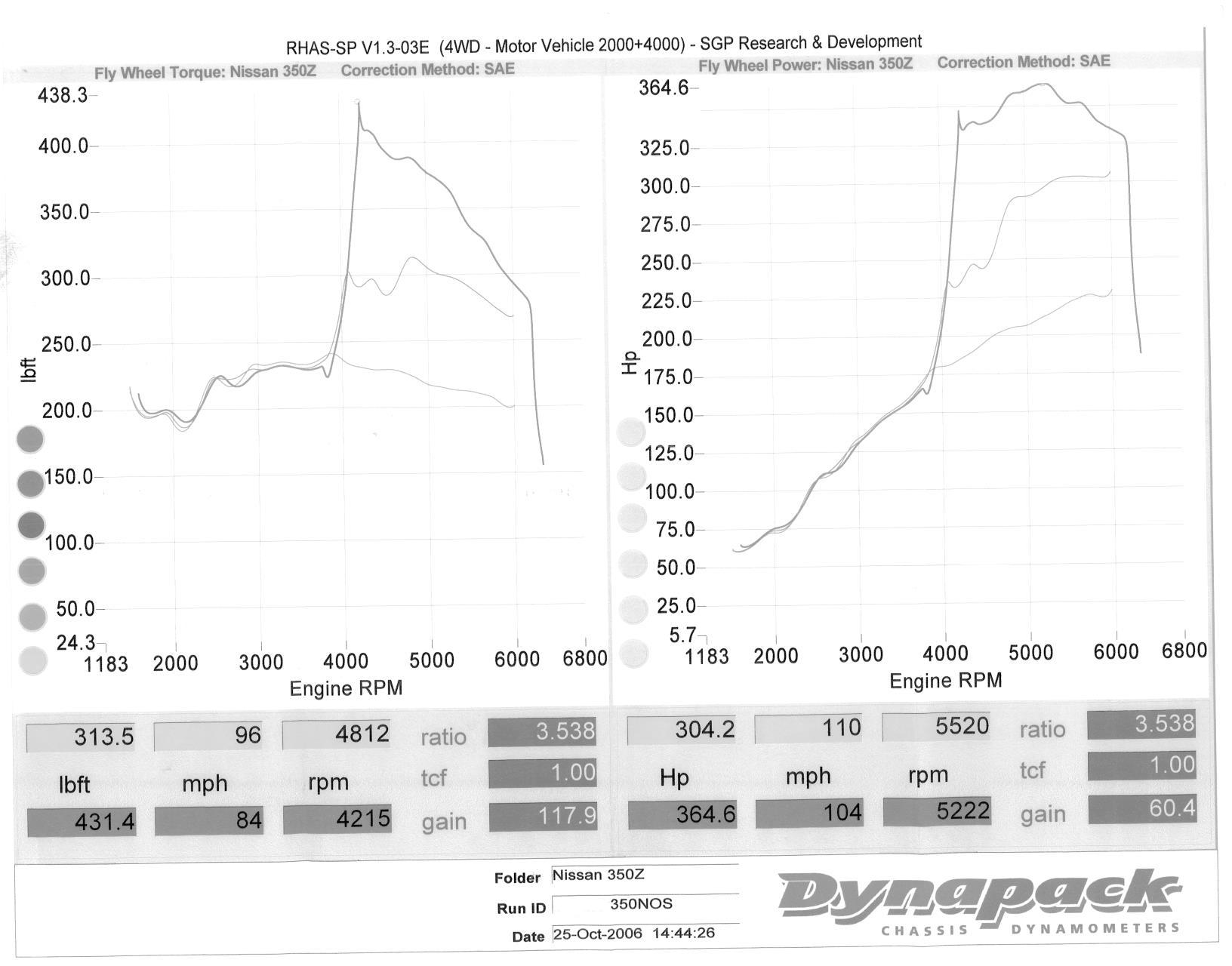

What's up guys. The last "Update on my Z" thread was just getting too cluttered, so I decide to start a new one.
Mods:
K&N Typhoon Intake
AAM Plenum Spacer
Greddy EVOII exhaust
DC Sport Headers
Strup Test Pipes
JWT Lightened Flywheel
ACT Z32TT clutch
Nitrous Express (NX) wet kit
NX purge
Zex bottle heater
DynoTune Nitrous TPS/Window Switch
PTP Fuel Tap (AAM clone)
UTEC Engine Management
UTEC Map Selector Switch
A little history:
I went to SGP to get headers, plenum spacer, and UTEC installed n tuned. We had warranty issues with the headers. New headers were received and installed. Then the stock clutch went out while on the dyno. Might as well throw in a flywheel if we're doing the clutch.....and here we are. She looks completely stock (minus the exhaust sticking out the back and the ricey sound from the test pipes when I hit the gas). I just put new rubber on some 20" Axis mods which will be going on Tuesday before I leave to go to the NW meet. Pretty happy with the results. Just filled the bottle over the weekend....now its time to play!! Chart below. Chart shows all motor, 75 shot, and 150 shot. Keep in mind this was done on a dynapack. Dynojets tend to read a little higher. Questions and comments welcome.

I thought you were getting it tuned after the clutch replacement. Where are the Dyno sheets from the final tune? Those sheets are dated Oct. 25 you should have something with a date from Nov something...
the file was started in October - finished Friday. I broke in the clutch and had them finish tuning. The day the stock clutch gave out I hit 438 lbs/tq (the reason for the exact TOP number on the chart). Plus that run didn't make it to redline...he left off around 4k. These dynos show all the way to redline. The last few days have been semi cold, so that's probably why the dyno read a little lower this time (bottle not as warm).

Are you running the 150 shot on pump gas... The reason I ask is because I have a pop charger, 5/16, mrev2, test pipes, Borla TD, Utec and a NX kit with a 125shot and I put down 351HP 383TQ on a mustang dyno and was wondering if I could step it up to a 150 shot without having to run higher octane fuel
If I spray 150 on the street, I will be throwing in some race gas or some kind of octane boost (NX or the like) just to be safe. They tuned it will race gas in the tank. If your tuning is done correctly, you shouldn't get any knock even on pump gas. I also went with 2 step colder plugs. From what I've been reading, it makes a difference.
Thanks... I have one step colder on now, I have sprayed 125 on the street a few times and it feels great but need alittle more....
yea, 2 step will take a little more heat out....you'll need all you can get when you squeeze that much.

From: Miami
I also have -6 degrees on my juice map... Will that make up for the plugs or octane
damn...be careful when retarding timing....pull too much timing and you'll end up burning your exhaust valves.
You should be ok with everything you have. I just got 2 step colder plugs as a precaution. I heard ppl experiencing less or NO knock when they go from 1 step to 2 step....turbo or nitrous. I haven't logged one knock on the UTEC. So far so good.

haha i love the chart, it shoots up so damn fast. If I didn't know you had nitrous i would have been all like VTAAAAAAAAK
Yea, not very linear....but it does give me instant wood when I flip that switch and mash the gas. That and whiplash. lol shaaaawing!
