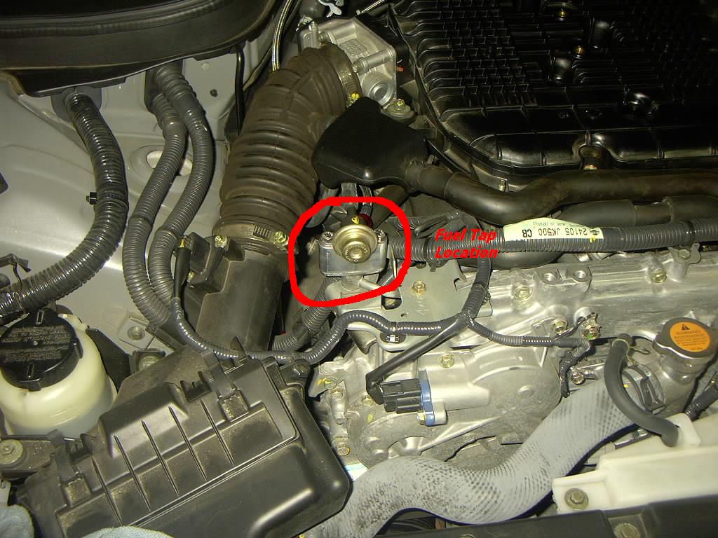

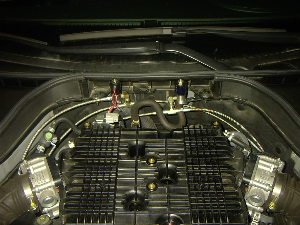

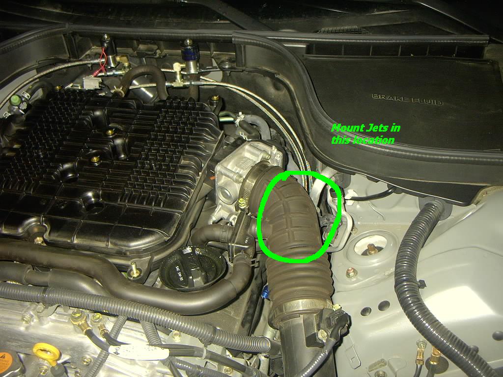

OK I stole my wife's 07 G sedan and mocked the set-up. You'll get the idea. I think it looks pretty slick with the 2 solenoids mounted loud and proud. I know the Nitrous solenoid is leaning (only finger tight if that). Any ways that's what the kit will look like. We were thinking about you "stealth" guys and if you're going to try and hide it in the right side compartment, you'll probably get a lean spike. He's seen some of the Mustang guys get spikes lasting almost 750 RPM's without any problems. Also additional lines will be required. Just thought I'd let you all know so there is no miscommunication. Have a look. Thanks guys.

So there arent enough lines the hide the soleniods in the d.side compartmet? I thought most guys do hide the sol. there without any problems (getting lean spikes)
Old Oct 3, 2007 | 07:26 AM
RebelinRI's Avatar
RebelinRI
Posts: 352
From: RI
I knew I'd have to explain this. OK, here I go. When they started on the 07 design they notice that the distance from the fuel tap to the right side compartment was fairly long. In past they had concerns from customers about an initial lean spike when the nitrous hit. It's a matter of the fuel trying to catch up. There is a little difference in pressure between the two so fuel system needs get the pressure back up after that first draw of fuel. Makes sense? As for the spike, like I mentioned above, it really is of no concern. You won't blow up or nasty things like that. I could have said nothing but I knew some would probably want to go stealth like I did.
In review class........
07+ kit comes as shown. You can hide it no problem. You just need to let me know so I can get and quote you the right package.
03+ (this is your kit Brian ) The kit comes with the lines so the solenoids can be mounted in the right side compartment (inside or out).
What's the difference?? Position of the Fuel tap that's all. Hope I cleared this all up. If you have questions or concerns, post up or PM me.
