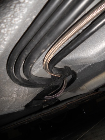

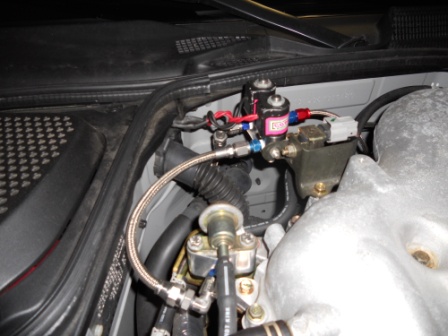

I put on my old kit thats been sitting on the shelf. I ran the N20 line through the child anchor area (already has a hole in the metal), down behind the glove box then through the fuel access hole the up to the front. I plan on running a 100 shot with one step colder NGK plugs for now.

Did u drill thru the firewall to hold your solenoids there? Seems like a good place for the solenoids.

No there is a hole in a bracket on the motor. I just bolted my home made bracket to that.

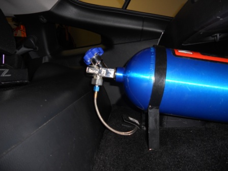

Sorry so long to post, the line is 18ft if I remeber right. I have moved my bottle from the hatch to behind the driver seat. This makes room for my sub box and hides the bottle. Now just pita to turn it on. But o well.
I have a .30 fuel and .53 Nitrous jet. Tried it out @800 psi can tell its there! Now just have to get some tires so it will go some where. And btw still on stock plugs
