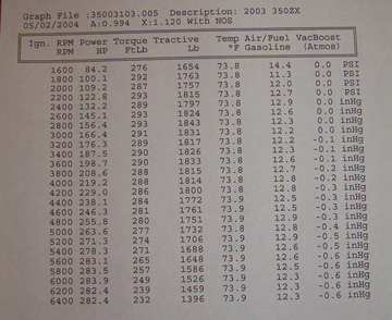

Hey check these numbers out and let me know if im ok as far as A/F ratios go.........this chart is with my 55 jets in...........when i run my 75 jets do you think the ratio gets leaner?
Attached Thumbnails 12secZ....A/F ratios are they OK?-350z-pictures-spoiler-013.jpg

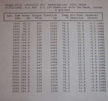

this chart is with NO NOS, just MOTOR.....ratios are close to the same .5 higher running nos...........let me know....THANK you
Attached Thumbnails 12secZ....A/F ratios are they OK?-350z-pictures-spoiler-012.jpg

Did you spray through the hole run? They look ok to me, check your plugs is what I would do.
I don't trust the Dyno Jet A/F numbers and when you change jets of course the numbers will change.
I think you could go a little richer on the fuel side with a 75 shot, looks like he backed off at 6k but it was staying rich at that point, I have always been told "better rich than lean" when spraying.
I pulled my pkugs all the time after dyno's when I ran N20.
I will try and find my 75 shot Dyno Jet page

You have almoust perfect A/F ratio w the NOS 12.0 - 12.9 range is very good... I wonder how come your car still pull the peak HP up to redline? my car have the peak hp on 6000 after that goes down a little bit and also the mix to 11.6... the only thing is that you have 75 shot but only 30 hp on the wheels... this is another case of underated jets!
the weird thing is that on motor you end up with 11.8 a/f mix... is the first 350Z that put that mix up to redline (at least that I see)... everybody else have 12.0-13.2 range on motor only!
