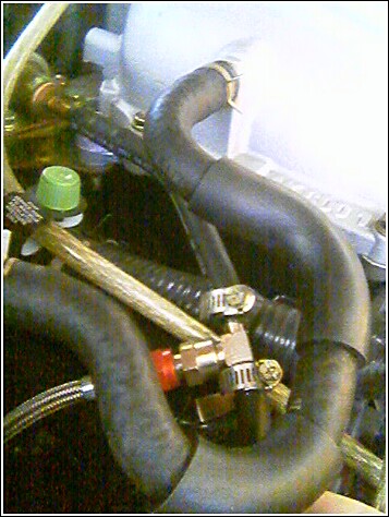

there is a black rubber tube that goes into the metal regulator. make sure you T-in atleast 6 inches away from the regulator. you will be cutting the black rubber tube.
once you cut it, you'll notice that there's actually 2 parts to the tube. a flexible outer rubbery part, and a hard plastic inner part. make sure your T goes into the plastic inner part as well as the rubber outer part. it is a tight fit, but you gotta do it. fuel pressure does get a bit high with our car, if you have a weak T, that thing is going to leak or fly off when the car is on. oh and make sure you use those clamp rings they give you to keep the hose from slipping.
its not hard at all, just pace yourself. it is annoying, but not as bad as the spx adapter has been to most people.
here's a pic of mine for refrence. took the pic with my cell phone so the quality isnt all that great.

what can possibly go wrong? worse case scenario theres a leak (which most people are already having a problem with, with the spx adapter).
as for problems with the fuel pressure being inconsistant before the regulater, its a bunch of bs. i had a dyno done last week to make sure my a/f is ok. we also put a digital pressure gauge where i T-ed into the fuel line. everything was perfect. fuel pressure was consistant, and i was running a little bit on the rich end. perfect.

Thanks for taking the time to show me... I just might do that...
