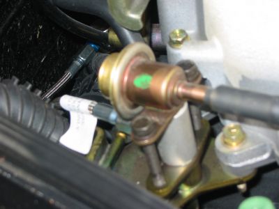

Default spx fuel adaptor pic
hear is a bigger pic for everyone to see
Old Feb 14, 2004 | 02:47 PM
fluidz's Avatar
fluidz
Posts: 794
From: Vortechville,CA
Default Re: spx fuel adaptor pic
What good does that do for Nitrous.........?????? My way cost $15.00 and looks way better and works perfect.

this s so u dont tap any fuel lines and is only 15 bucks more than u spent

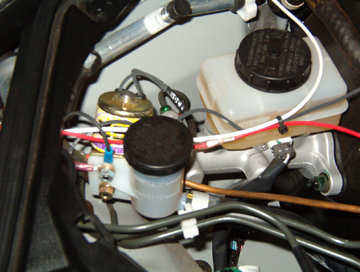

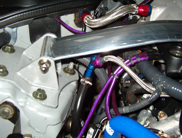

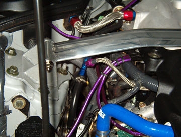

Default heres a pic how i did it
heres a pic how i did it !

any better pics?
