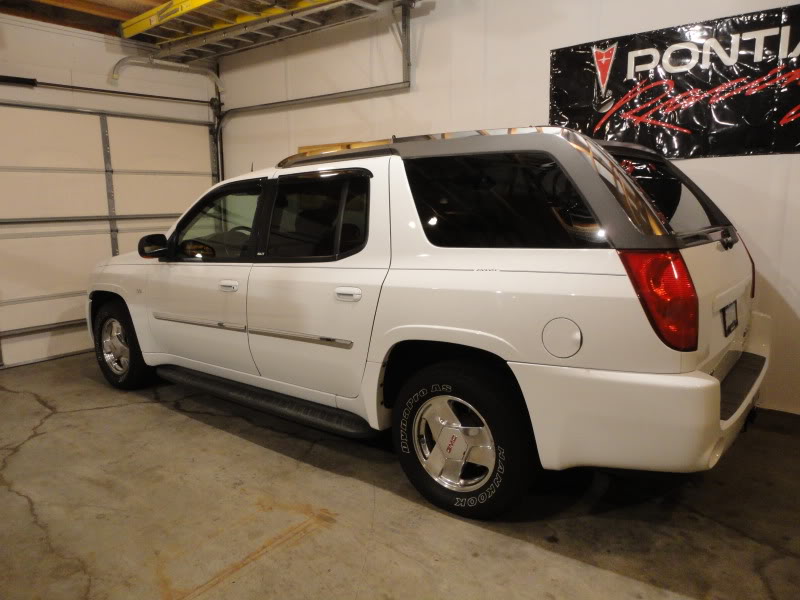

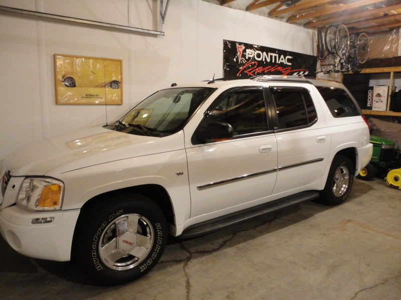

Well just did a much needed detail on the truck. Hasn't been through a car wash since last spring, so after a wash and using a buffer for a hour and a half and a quarter of a bottle of Meguirs gold wax she's all nice and glossy again. Detailed the wheels as well with the Mothers aluminum polish and mothers triangle buffer.

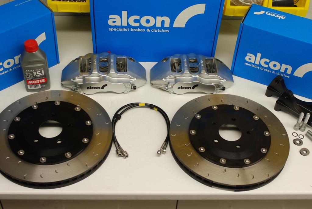

I am trying to figure out what to do with the brakes on my evo. they flat out suck.. they shimmy fairly bad, have crappy initial bite and don't have the linear modulation I like - you have to slam them. they stop hard, but have a crappy feel. The shimmy, I am fairly certain it is from letting the car sit for 3-4 weeks at a time over the summer. when I first got the car, I put on new racing brake rings (basically new rotors) and pads. brakes were decent for a while, but never quite like driving my Z... but my Z has a 355 brembo kit with ferodo pads. not really apples to apples, but the evo brakes never really felt great.
so I am looking at my options. I know the front calipers need a rebuild and would like to have them refinished... cough... brownbos... cough. the dust seals are toast and with the shimmy, I will be getting new rotors.
so if I go a two piece rotor, like I have, a full rebuild with refinish, and new pads, I am looking at 1300-1500 bucks!
ferodo pads = 245
rebuild/refinish calipers with new SS pistons = 650
girodisc two piece rotors = 700
+ shipping
based on that, I feel like I should just get a new BBK, but now it becomes tricky because I want to be able to run 17" wheels. My options
Alcon 343mm BBK - basically the best of the best, but costs ~3000 bucks (which is actually a very good price based msrp of ~4200) this is just for the fronts, and I would need at least new rotors and pads for the rear.. so add about 350 at a minimum. down the road I could get a rear kit for another 2600.... !!!!
- replacement rings and pads are not cheap. pads are same price as current setup (~250), but rings are at least 500/each. but again, this is alcon, so we are talking premium goods
Essex AP 325mm front setup. This is a piece together kit that essex put together for evo owners. Calipers are a common setup they use in a few setups they put together for other applications. has good reviews from the handful of guys running them. Kit wil run me about $2500. kind of pisses me off because they have run a few specials on them for about 300 bucks less, but will only work with my a little bit on the pricing right now... I probably would have bought this kit already if they would have offered me the discounted pricing they have ran a number of times on the forums. replacement parts are cheap. like 1/2 the price of alcon stuff. the calipers are just a goofy black/greyish anodizing. they almost look burnt. No matching rear kit.
My third option is wilwood. I can do front and rears for about 3000 bucks complete. Very good pricing, but almost no evo guys run them. replacement parts are cheap. the rear caliper kind of looks cheap, but they include a 2 piece rear rotor with iron hat, which is good for use with oem hand brake. I am hesitant with this kit based on the limited pads they have available. I can't find the ferodo pads I want to run, and due to the narrow calipers, are limited to 16mm pads, where as both other kits, I can get the pads I want. this is not to say the available pads are bad, just that I can't get much feedback from the evo guys on this kit and the pads.
if money is no option, I am buying the alcons.... but that's just it, I don't have the money like I used to- lost my baller status. that's not to say I am not willing to spend the money if it's better in the long run. I am in for at least ~1500-2000 bucks no matter what I choose, so it's not like I have a "cheap" option. I think all the kits will likely be more than enough, but most say the stock brakes are great and I am thoroughly disappointed (oem brembo are not equal to their high performance aftermarket stuff). I have ran 3 different pads on the stock brakes and I have what many consider good rotors, so I have given them a good shot. I'd just hate to buy the wilwoods and have them be not better than stock. and I would hate to buy the alcons, and have them be no better than the wilwoods or ap setup would have been. the ap setup pisses me off, because they have been as cheap as 1700, and usually around 2100 with pads... and they will only work with me to about 2400 when I waited them out on a fall discount like they offered in the past... may be petty, but this is kind of what has kept me from buying them
any advise is appreciated

As for advice, I think you should go with your first option.
ferodo pads = 245
+ shipping
If you're not going to drive the car that much (like I do with my van), then spending up to $3k on brakes is crazy, IMHO. I'd hate to see anyone spend that much money and have the car sit for long periods of time only to open up the flood gates for future problems, if there are any.

for oem stuff, I like akebono pads and the higher end napa rotors... if you are willing, brembo rotors. sometimes they aren't that much more.
as far as my choices... you think rebuilding my oem stuff is better than buying a set of wilwoods? the fronts would cost the same as rebuilding. after doing research, the oem brembo stuff isn't equal to aftermarket brembo.

According to your research, the Wilwood market isn't that big or good or lacking reviews for your car. Don't know if I'd want to spend that kind of money if there's limited info on it.

Wilwood is well known, just not a lot of people run the kit I am looking into. AMS put out a wilwood superlight kit for drag racing and a smaller setup to fit under 15" wheels. a lot of people run those. if people run big brakes, they run big brakes.. like 365 alcons, or big endless... or just crap ones like ksport. Shane at DB said the wilwoods are decent.

BTW Aaron, Wilwood FTMFW. They have got to be the best bang for the buck BBK out there. I'm definetly getting those this spring. 14" front and 13" rear rotors 6/4 setup.

as far as the brakes go, I tried to send payment on the alcons last night. CC company declined the payment due to exchange of funds to british lbs and time of day... kind of felt like it was the universe telling me not to buy them. Now you say get the wilwoods..... ah! conflicted.
my plan was to get the alcon fronts, and just new rotors and pads in the rear, or maybe get the rear wilwoods.... all I know is I hate driving the car because of the brakes and want to get it resolved asap
