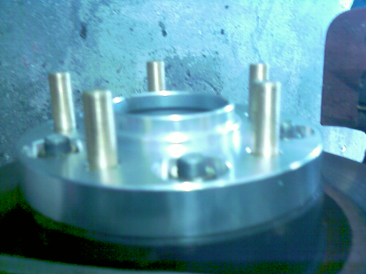

why do they not work? are the stock studs sticking through the spacer and hitting the back of your wheel? I had this issue when I first tried installing my spacers.
i just had that issue and had to grind the stock studs down (thanks pete!).. they can work, just needs some grindin! either that, or you can go buy some shorter studs to replace the stock ones.

I would never grind down the stock studs...that's a short-sighted band-aid imo. OEM wheels and most aftermarket wheels (Volk/Work/PIAA, etc...) have the pockets on the back of the hub...some do not, unfortunately.

you can always hammer them out and buy shorter ones if grinding scares you. or you can just get the spacer types with the longer studs to replace the stock ones with I suppose too ..

Nobody, besides you, thinks it's a good idea to grind down the stock studs. What do you do when you want to run any wheels without those spacers on? Yeah, you need to hammer those out and replace all the studs. Do it now, and do it right....or do it later and do something ghetto in the meantime. I know you're trying to help, but that kind of "advice" shouldn't be given to anyone. Some clueless noob might actually be dumb/lazy enough to take it.
The ONLY option, when spacers with built-in studs don't work, is to install extended studs with that style of spacers.

depends on your wheel mang. it's a possibility, you won't know for sure until you throw the spacer on your hub and see if the stock studs make contact with the back of your wheel.
call it ghetto if you want, but not lazy. it's definitely not the lazy route, its the DIY route (ok, so slightly lazy, it's the DIY route that I didn't have the tools to do, so I got help with it) and it is a little more risky. I was hit with a shitty situation since they hit the back of my wheel so I had them grinded down. if you were really just that set on doing things absolutely right you would buy wheels with proper offsets in the first place.
if I have to swap wheels down the road I will spend the 40$ and get new studs, not a big deal. I don't intend to swap wheels so it seems viable to me - you just have to make sure it's done right safely with enough tread stickin through the nut afterwards.
it's advice that you clearly didn't want, but it works for some people. I'm not the first or the last that went that route, so to say I'm the only one is another unfair statement.

old phone - shitty pic, but this is what the problem for me was. most wheels will have a place for the extra stud length sticking out to hide in, but the wheels I have (19" tsw mondello) hit the stud.
*edit* to get an idea you can see that there are about 7-9 treads sticking through the nut after they had been torqued down. 3-4 of them had to be shaved off in order for the wheel to sit proper.

You're running OEM wheels, which should have plenty of room on the back of the pad. Besides, the stock studs stick out just shy of 25mm front/rear, and you should be running 25-30mm spacers all around anyways.

It's not the cost of studs, it's wasted effort now and then more effort later, when it could've just been taken care of up front, in one sitting. What if you one of those TSW's bends or cracks, and you need to roll on oem wheels for awhile? Funny thing about intentions, is that the possible scenarios are endless.

I'm pretty sure he "is" right about this. If there was advice given on this subject and zSupreme7 gave it, and you follow it you will have 100% success. Don't put your life and the people around you at risk by taking shortcuts. Not saying cutting 3 threads off of an OEM stud bolt will make you crash but there is a reason why the right parts are made and used.

*edit* in regards to the "what if" I have to roll on OEM wheels if a wheel bends / cracks etc, it won't matter. they will bolt to the spacer all the same. they would still bolt down if I had to take the spacer off, too.
