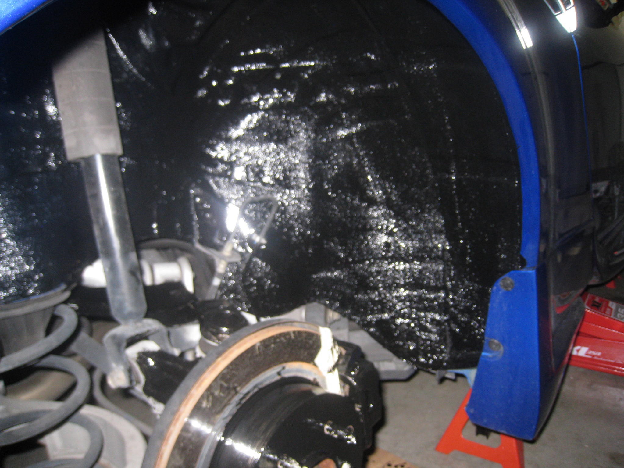

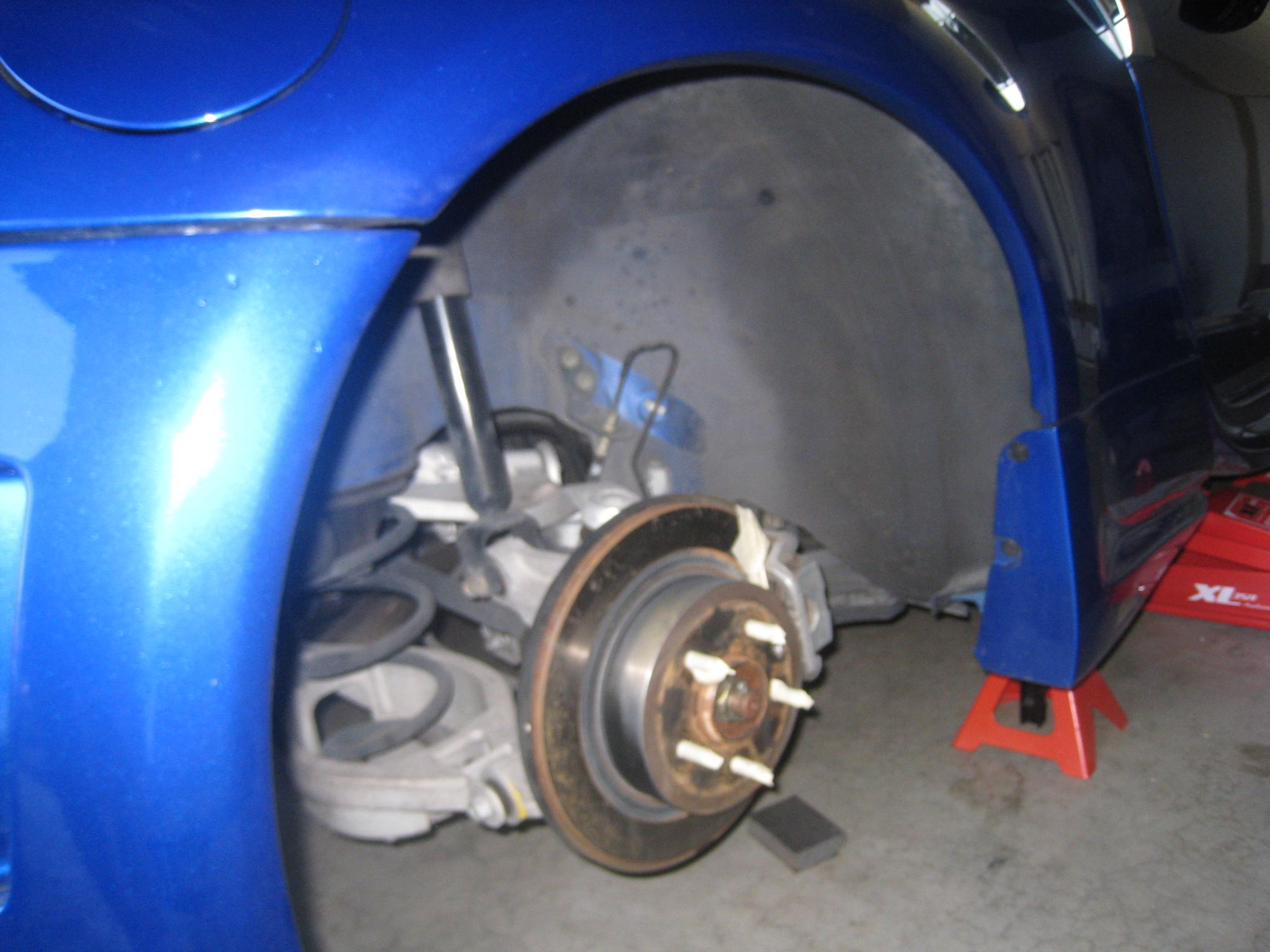

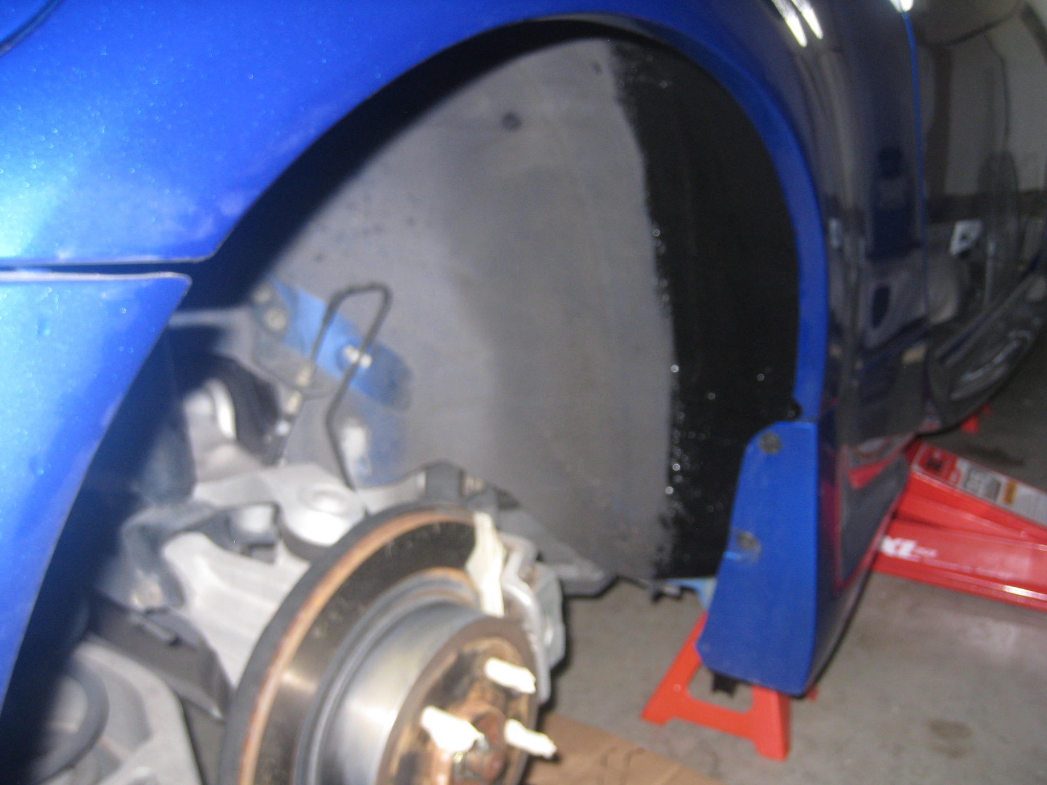

Since the wheels have the gloss black I decided to stop being lazy and do the one thing I have done to most of my cars... paint the inner fenders in gloss black... By doing so it makes the car look way cleaner and make the wheels stand out more... Calipers were also painted in gloss black...
Here are some pics of the before / during / after of the painting and some pics of the wheels...

Originally Posted by Southgachik
Looks great! What did you paint the fender wells with? Mine need painting since I apparently ran over some paint in the road a while back... it's spattered in one or two of the wheel wells
Believe it or not I have always used rust-oleum gloss black...
The process is very simple... take the wheel off, clean the area, wait until completely dry ( i use my garage fan on one side while I clean the other) then simply paint with a nice brush... wait until is completely dry. I usually leave it until the next day and that is it... inner fenders are painted.
The calipers require a different paint that is heat resistant... the calipers are cleaned, then spray the heat resistant paint, wait until is completely dry and I use rust-oleum on top to give it the gloss black look.
So far it has never peel off on me... and never had any issues. You can always just use the spray for the calipers and not use the rust-oleum but is not going to be as shiny unless you use heat resistant gloss clear coat...
and you are done !!
