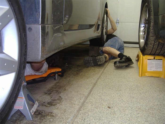

uuuummm has anyone seen my husband?
Old Jan 27, 2007 | 02:09 PM
  #70
Robert_K's Avatar
Robert_K
Didn't Go Cheap
iTrader: (25)
Posts: 12,390
Likes: 101
From: Spring, TX
Gosh!!! He's right there!!!
Old Jan 27, 2007 | 02:12 PM
  #71
HiZ38Ds's Avatar
HiZ38Ds
Posts: 1,516
From: Get out my way pimpin', CO
UUUhhh thats Sean oh Wait there he is, he's all the way under the car
Thanks Robert now I'll know where to start looking
Like you needed my help for that. LOL
He's with Bob. Keep in mind that Bob drinks a LOT, so you may want to take Seans advice and check on him every once in a while.
Old Jan 27, 2007 | 06:46 PM
  #75
I like those sensible shoes that guy is wearing!
here he is what has he gotten into now?
Looks like the liquor cabinet -- AGAIN!
