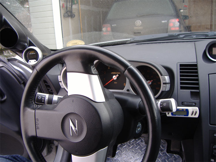

Hmm how about mounting the EBC in the same area where my turbo timer was mounted:
Pretty easily accessible and outta the way but not out of arms reach.
Funny, That is the same one I have...and that's where I put it!!!

Well mine is the "Special Edition" in Pearl white!
