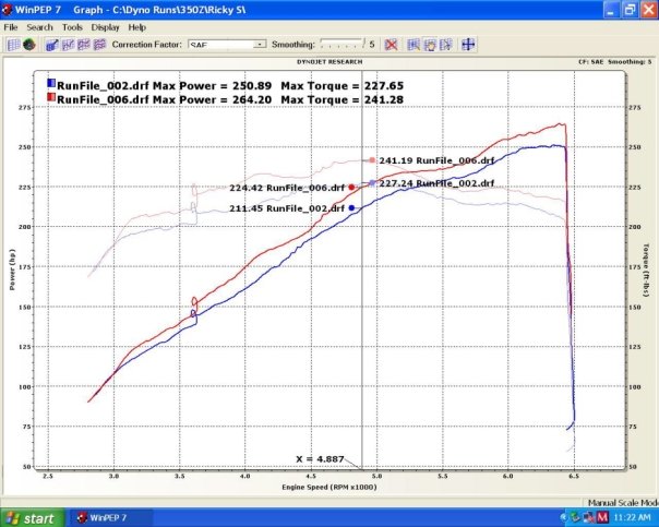

Hey everyone, can you take a look at my thread here and let me know what you think of my dyno?
https://my350z.com/forum/vq35hr/5691...iris-tune.html

expensive! numbers are just numbers. how does it feel and drive / big improvement?

Yeah it was expensive, my experience there wasn't the greatest..but i'm just glad to be done with it now. There were some hidden fees they threw in there at the last second which was sort of ridiculous
It feels good & drives well, but i'd like to take it out of the city to really see how it is now. 2nd gear and 3rd feel like they pull a lot harder, so in that regard it feels like a big improvement. I guess i'm just disappointed that my numbers are so low compared to others here that are naturally aspirated as well

What happen on the initial pull before the tune? I wouldn't get too involved with the numbers, some of the dynos in this area are either over or under on numbers. As long as the butt Dyno fells an improvement your good. As a future tip, before getting a tune copy all your maps (to verify adjustments or e-tunes).

I had to wait in the lobby during the initial pull, but looking at the graph someone here mentioned there was a break/spike in the torque line and they stopped the pull early. Before the tune it was 248 and 248 torque with my bolt-ons. I'm happy I have 5 (4?) maps and cruise control. That anti-theft & valet mode is pretty sweet. How would I go about copying all my maps without the cipher cable? Is that something i'd have to tell my future tuner(s) to do? Scotty told me he didn't lock any of my maps and that my ECU has the license for Osiris.

I'm going to head back up there with some dyno sheets I found online. I am way below what I should be..this is ridiculous. Either my car has a serious problem, or their dynojet is very off. I know the numbers don't mean anything, but there is a reason why they're this low..and i'm determined to find out why
I should be around ~290-300...not 260

Elevation may come into play. Can you post the dyno sheets you found?

Your best bet is to go to another dyno and get a base line, plus they should include a air/fuel readings as well. The number can be low just due to improper set-up on the dyno. also think about taking it to the track and seeing what it does in the 1/4mile, or race a DE just to make sure.
I don't know who tuned your car but often times tuners will set-up dynos to read lower, just to your business. Then when your car get work done from them then they correct the dyno to show actual numbers. Not saying that this is the case but ive seen this happen before. Did they say why you needed 5 maps for your car? and how do they differ? you dont need 5 different maps for an NA motor with IHE.

Like ABQ_VQ35DETT mentioned elevation would play a part in low numbers. Most of those Dyno charts are under 100ft above sealevel with one being just under 1000ft. Albuquerque is at about 5,300ft and has an atmospheric pressure of about 12psi, where as they're seeing 14.7-14.3psi. That's just what we get at this elevation and it hurts N/As the most, but i dont think you would be at those numbers.
You can calculate your horsepower using your 1/4 time-slip.
Estimated wet weight with driver= 3500ish
HP = Weight/(ET/5.825)³
HP = (mph/234)³ * weight
or you can google online HP calculators, there are also ET and MPH based off of weight/HP. This will give you an estimate but does not account for wheel-spin or other factors, just the physics portion.

I can understand low numbers, but that low?! I'm moving to Oklahoma here in a few weeks so the elevation will be ~1200. I hope that since i'm tuned for such a high elevation, it won't hurt to be driving at a much lower one. I tried out the anti-theft mode, and it's pretty sweet. Valet will be nice if I ever have to drop the car off someplace to get worked on. I heard a story on this thread that someone's car get total'd because the shop employee took it for a "spin"
