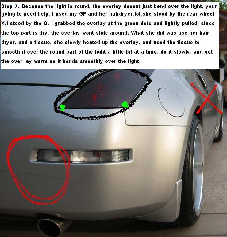

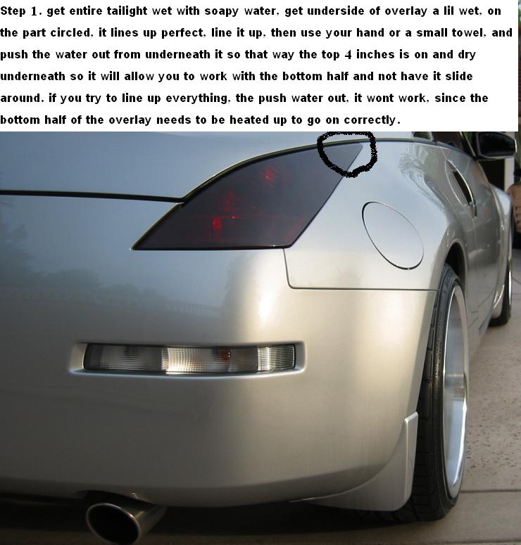

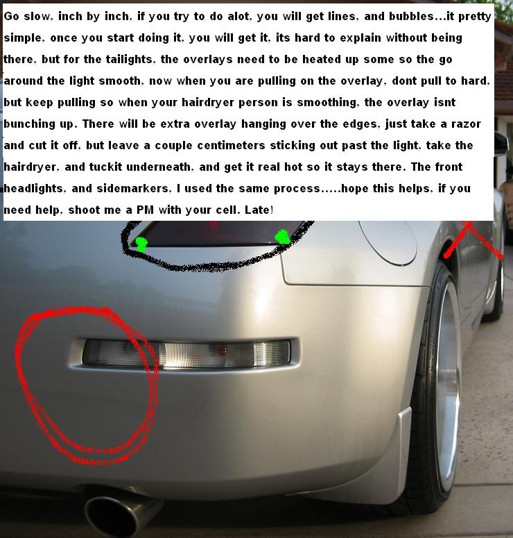

Hey, give me a call Ill explain it to you, I dont feel like typing all of it again, rofl....Shoot me a PM, Ill make a lil pic with a brief explanation, but if you dont get it, just give me a call, Im in Sacramento, CA....
Attached Thumbnails just got bats overlays...-img12.jpg   just got bats overlays...-img5.jpg
Old Jun 25, 2005 | 08:11 AM
atar350's Avatar
atar350
Joined: Jan 2005
Posts: 2,331
From: Sactown, California
Here are some pics I made real quick in paint! Hope they help...
Attached Thumbnails just got bats overlays...-1.jpg   just got bats overlays...-2.jpg   just got bats overlays...-3.jpg   just got bats overlays...-img13.jpg   just got bats overlays...-img3.jpg

Hey Bat, I would recomend a hair dryer in your instructions, the bottom end of the tailights wont line up with out bending unless heated up and smoothed onto the car, i figure because the lights round over, and the overlay is firm and doesnt want to round over along the light.

ya, and use your fingers, instead of a credit card or squeegie, to lay down the film. they give you much better control of eliminating air bubbles, wrinkles, etc. pretty easy diy once you get the idea, and even if you mess up, the cost of a new overlay is still way cheaper than having them prof installd. jmo and experience.
