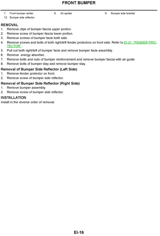

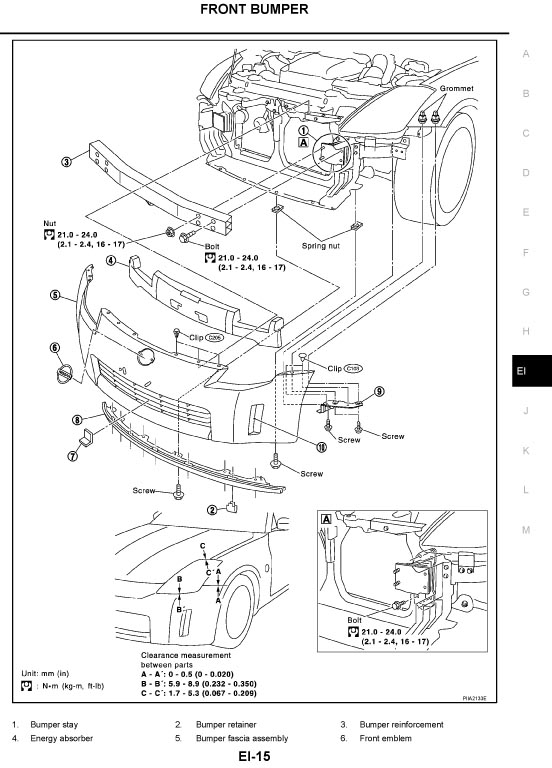

as long as you take your time and follow instructions to the T you be fine. a few pointers though.
a. take it easy. try not to bend the bumper a lot or you will see hair line cracks on the piant
b. Have some one help you remove it from the car. Not really necessary but it will help with redusing the flexing
c. It could take you any where form 30 mins to a whole day. depending on how much you pay attention to the instructions.
d. Put a pillow on you butt because once you realized how easy it is, you be kicking yourself in the a$$ for asking for making this thread.

do I need to remove the headlights?
do I need to remove the front tires?
Looks like I don't?
Old Oct 8, 2007 | 10:41 PM
vkzawa's Avatar
vkzawa
Posts: 626
From: San Pedro (South of Torrance)
No need to remove the headlights or front tires.
Just turn the tires all the way to each side to get to top screws.
